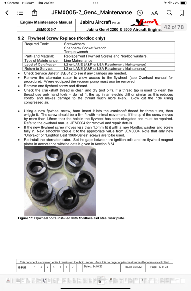

facthunter Posted October 26, 2023 Share Posted October 26, 2023 I haven't got details of how the Later Jab Flywheel is mounted yet. Nev Link to comment Share on other sites More sharing options...
dlegg Posted October 26, 2023 Share Posted October 26, 2023 Link to comment Share on other sites More sharing options...
facthunter Posted October 26, 2023 Share Posted October 26, 2023 Doesn't look to have changed much. Prefer the starter drive just behind the prop. Nev Link to comment Share on other sites More sharing options...
