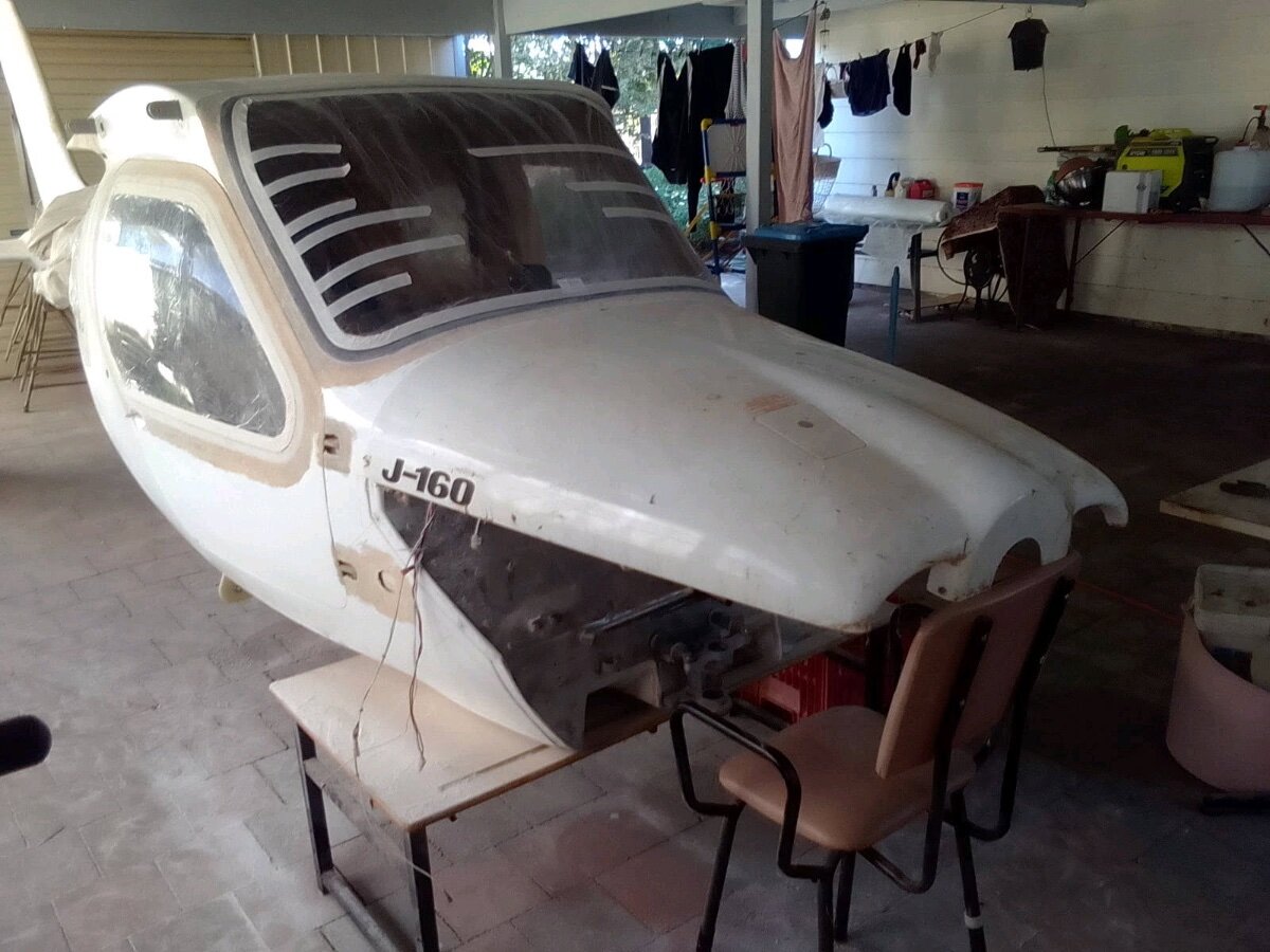

Rapture Posted May 4 Author Posted May 4 And getting back onto topic, progress has been made on the J160 Zonsen conversion. The restoration of the J160 moves ahead with the new glass having now been installed. The airframe itself is now pretty well done with a new factory interior to be installed. Here she is with the new glass installed. 8

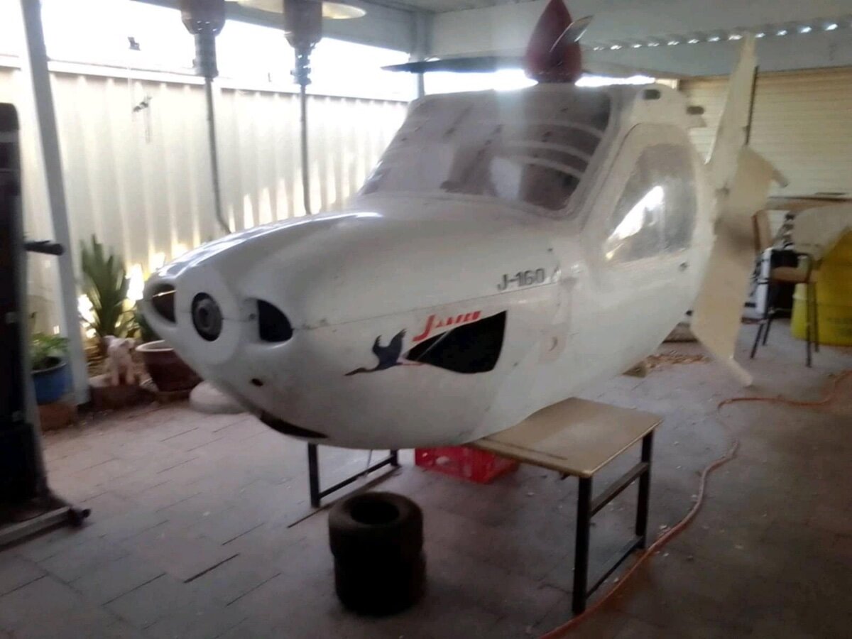

Rapture Posted July 3 Author Posted July 3 We are trying hard to keep the modifications to the J160 airframe minimal so that future conversions are both minimum cost and complexity. The above photo shows that the stock cowling still fits fine. With our 110hp CA510 being fully liquid cooled, we might even be able to plug some of the holes in the stock cowling to reduce some drag. 7 1
