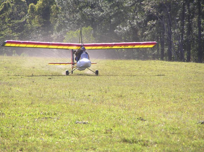

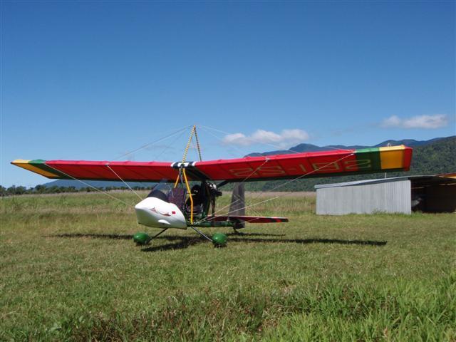

farri Posted October 16, 2008 Share Posted October 16, 2008 G`Day boleropilot, I gather you love the Drifter so much, I thought I`d show you mine. I just finished a complete refurbish on it,a month ago and it flies like a dream. Cheers, Frank. Link to comment Share on other sites More sharing options...
Guest Maj Millard Posted October 16, 2008 Share Posted October 16, 2008 The Ol' Drifter is looking pretty snazzy Franco , who did the nice looking skins ? Cheers Ross. Link to comment Share on other sites More sharing options...
farri Posted October 16, 2008 Share Posted October 16, 2008 G`Day Ross, Thanks and yes it is getting pretty old but with all I`ve done,it`s as good as ever,It`s put plenty of guys in the air over the years and an enormous amout of people have had joy out of it through introductory flights. I hold a level 2 for my AC.,and I make the skins,this is the third set I`ve done and I can do them for a 1/3 of the cost the only problem is I get slower every time, is that telling me something,am I getting older also,lucky the Drifter doesn`t get any slower Frances said to say HELLO. Regards, Frank. Link to comment Share on other sites More sharing options...

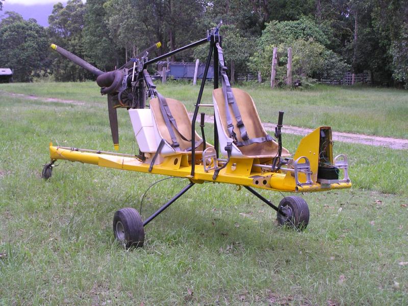

jordy Posted October 24, 2008 Share Posted October 24, 2008 Thanks Frank. I thought that may be the case. You guessed right with the prop, 3 blade 60 in Brolga gearbox has 2:24 ratio and all revs are correct even after deleting the infamous Rotax tacho exaggeration.:faint:Still gotta love that 503. one up its sooooooooo sweet. Thanks again. May PM you later to grab some more info if thats Ok!! [ATTACH]6742.vB[/ATTACH] [ATTACH]6743.vB[/ATTACH] Link to comment Share on other sites More sharing options...
farri Posted October 24, 2008 Share Posted October 24, 2008 Refurbished Drifter. Jordy, It looks like you`ve done a great job,feels great when it`s finished,doesn`t it. I got into rec flying,23 years ago, by building,from scratch, a copy of a Chinook WT2,before I even knew why they stayed in the air,I put the cart before the horse,I simply wanted to get up there while I could and I wouldn`t change that if I could. It was pensioned off about 18 months ago,had a lot of fun in it, I did. Cheers, Frank. PS. Ask as many questions as you want,I`ll try to answer. Link to comment Share on other sites More sharing options...
