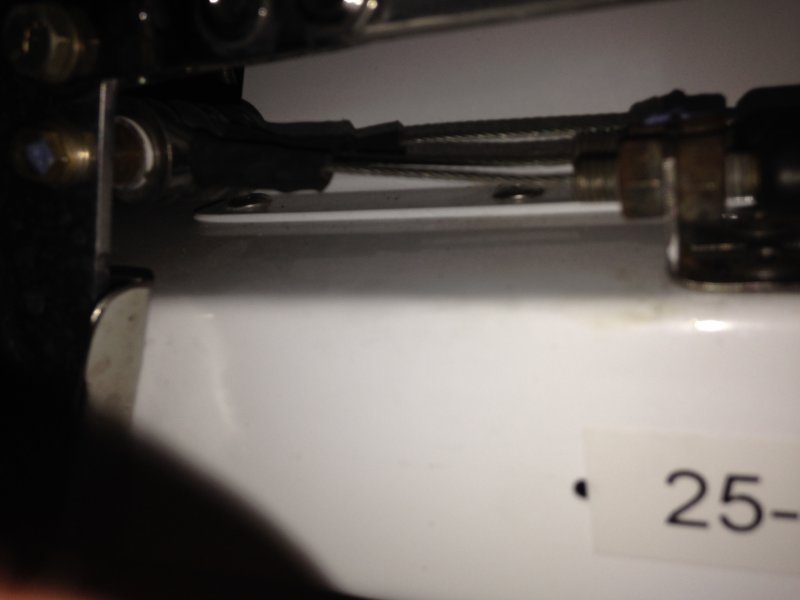

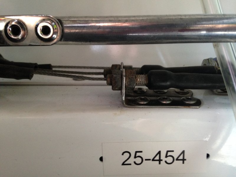

Hi Farri, Just from the cable adjustable to the the throttle itself, the cable moves upwards a little way and just want to see other drifters set ups, here is another photo
Just want to see photos of other drifters how theres is set up, I thought maybe the the adjustments may have to be adjusted back a little.
