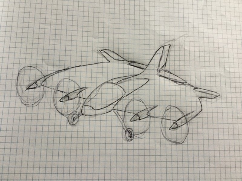

Low aspect ratio planforms are not pitch sensitive they are generally stall proof and spin resistant, because of their inherent stability, they usually have no dihederal or anhederal to make them more sensitive in the roll plane. I suggest that turboplanner does some research before making those generalisations. The Arups, Milt Hatfield's Little Birds, Vought FXU5 and V173, David Rowe's UFO, Wainfan's Facetmobile - all exhibited positive stability - all were stall resistant, and all were reported as pleasurable to fly. The Helios and other electric powered aircraft have used the tractor configuration which provides the least turbulent air into the propellers. Unless the thrust can be vectored down, prop slipstream over the wing from the front is the best way to use the wing shape to increase lift, low aspect aircraft have wide chords and therefore large reynolds numbers, the same circulation over a wide chord gives a proportionall greater increase in lift. -
Electric Aircraft interest?
rotax618 replied to bexrbetter's topic in Aircraft Building and Design Discussion
One design which could utilise the compact compact size of electric propulsion would be the Zimmerman flying flapjack, I propose that 4 motors be placed along the leading edge of the wing , 2 at the tip would revolve contrary to the tip vortices, lowering loss from induced drag. The slipstream from the props would provide a large proportion of the lift making it a superstol. -
