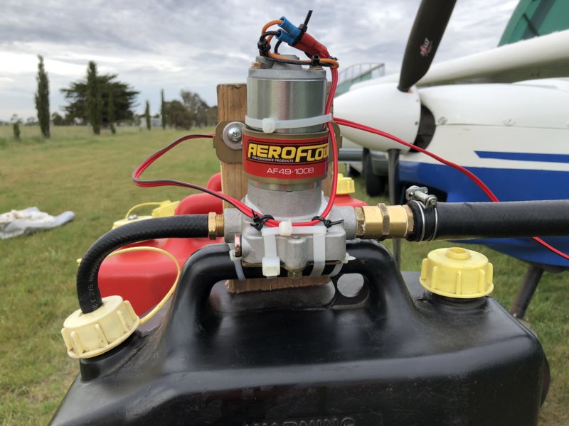

Dear Skip, I really appreciate your comments and updates; thanks for sharing your knowledge and works. I agree an aluminium or copper inlet tube would be more durable and reliable than poly tube, I expect the increased weight shouldn't be a limiting factor. I was reading more about in- tank fuel pumps used in cars and this ump variety seems an option also. This pump could be mounted on end of a stiff tube (ie aluminium/copper) and then tube inserted into jerry can, passing through cap to steady/align tube to container bottom. This arrangement would be a neat tidy compact device, not unlike the plastic siphon pumps advertised on Ebay. I read enough about submersed fuel pumps to accept its safe practice. Regarding hanging a bladder for the low wing tanks, could you make a 3 legged tripod and hang bladder in center whilst it refuels to wing tank? Relatively thin rod/tube could be used for the tripod. Regarding length of wiring in my set up, I agree its lengthy and I would shorten significantly in a further iteration. I might have some more plays, although the simple Tuff jugs filling devices work well enough for me. Again thanks for sharing. Cheers Matt -

Hiya Skippy Diesel and others, I've read with great interest, the numerous posts after I wrote on 16 July about my refueling practices. I like your set up as pictured above and it appears very portable and stowable. Will the poly pipe deteriorate/dissolve, contaminate the fuel and be a significant impurity??. I guess the fuel filter will address this issue. Your thoughts please. I finally trialed my home base refueling set up as per photos below. Its very similar to your arrangement and uses a AeroFlow AF49-1008 12v aftermarket fuel pump. The other components are car shop sourced and scrounged from other pumps. Time for transferring about 18 liters from jerrys to the Savannah's wing tank was about 2 mins. I could refine the set up including hoses into all 3 jerrys for a 60 liter filling station etc. My initial response was that " Its all a'bit fiddly and not much quicker" than manual filling from start to finish. I use the 10 litre tuff jugs (I prefer the O'Neil brand as the 2 side handle allow easy hoisting and steadying whilst the jug empties). These jugs empty in about 30 seconds. Sure you have to refill say 5 to 6 times but its quick and enables filtering using Mr Funnel. This is fine for home base refueling. I use the 10 liter jugs as I can lift them and insert into the wing tank single handed. There is a 20 litre size of tuff jug but reckon lifting and holding this larger jug would less convenient/enjoyable When away from base, you could take a tuff jug and Collapsible Bladders (CB) when the airfield hasn't a fuel supply. I don't use CB's as I fly solo and plenty space for rigid 20L containers or travel via airfields where Avgas is available). Your system is compact though and easy to rig. You could hang the CB from the tie down point on the wing underside (or some other nearby point) and secure the filling tube end into the wing tank so nothing needs holding. Anyways its been a very interesting topic to discuss and I appreciate the wisdom and experiences of others, Regards Matt Walsh, Savannah 4295, -

Thanks APM , great suggestion and convenient for recharging and handling. The pump isn't working for very long so wouldn't estimate large current drain. But its 12v pump so will a 14-18V battery pack be too greater potential and risk damage to pump motor?? Cheers Matt -

Hi Skip, Thanks for your comments on battery size and nozzle implications. I was planning to fit a petrol bowser type nozzle so am relieved I got your Intel regarding potential pump seal damage with sudden pump stoppage. I now understand the purpose of your "switch on a lead". I considered the nozzle to prevent spillage when removing the hose end from the wing tank. I could fit a simple in- line tap which I switch closed AFTER pump ceases and stops flow. This avoid me having to handle the hose carefully as the remaining fuel in the hose will be prevented from discharging. Your thoughts???? Can you discharge petrol through copper pipe?? I can bend a goose neck end for the fuel hose to insert and hook in the wing tank, I bought a S/H AeroFlow AF49-1008 pump, its the red series pump. Regarding the switch on a lead, I am a mite concerned about operating a switch within 1-1.5 metre of the filler tank and query whether the switch would be a potential source of ignition. Your thoughts? I could fully encase the switch in resin?? Comment on battery size noted and I may investigate a 12V size. Thanks again for your input and wise advise. Regards Matt Walsh -
