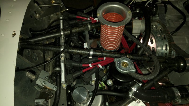

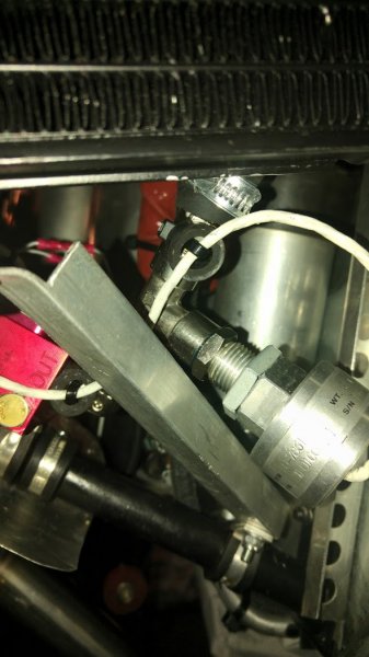

  1. Ran the engine for a good 15 minutes, oil pressure went up to 5 bar and then settled to 2,1bar as temp went up, oiltemp didnt go over 68C, water went up to 101C then i turned on the watercabin heater and temp went down a few degrees, the funnel for the watercooler on the cowl is missing so, really nice...

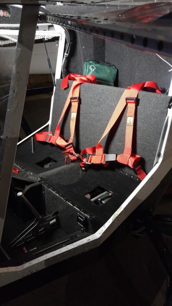

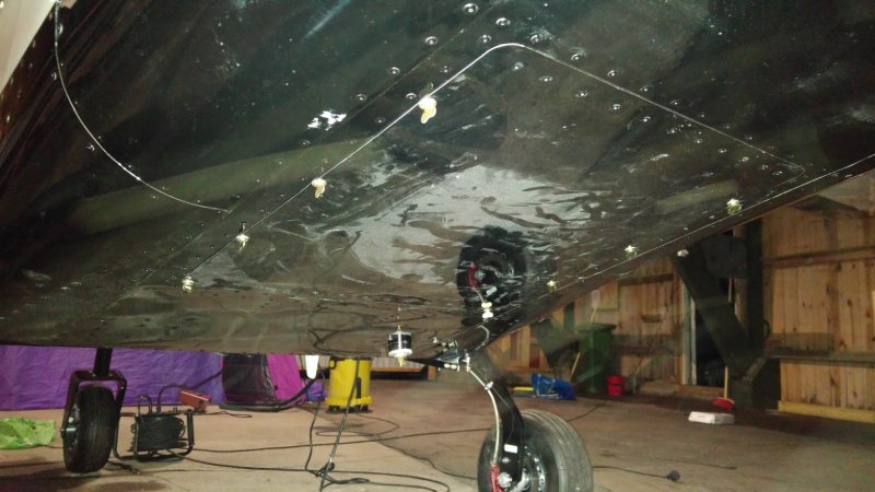

  2. Seatbelts in And some markings. Bottomplate has camlocs, And som stripes. And finaly, first engine run, did not get any good readings on oil pressure so have to look it over.

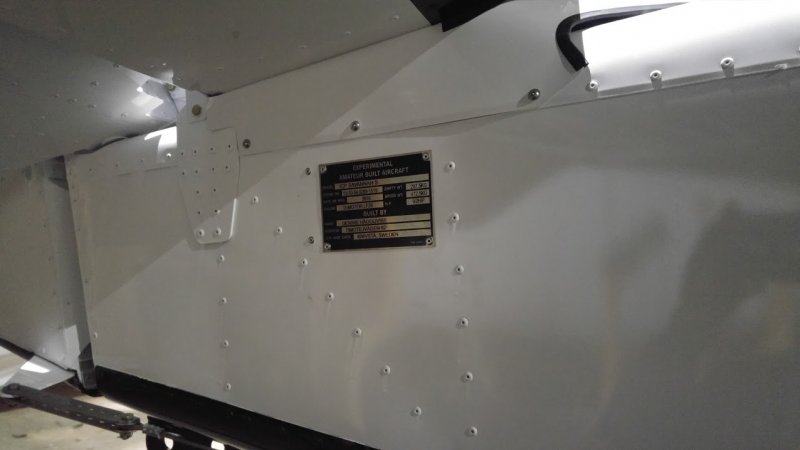

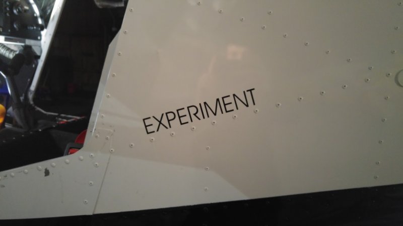

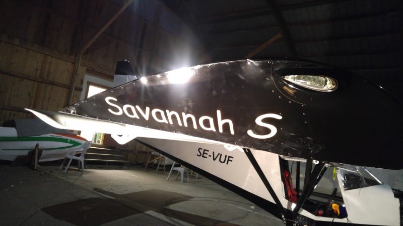

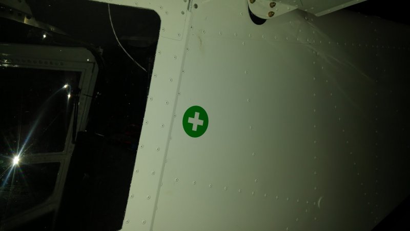

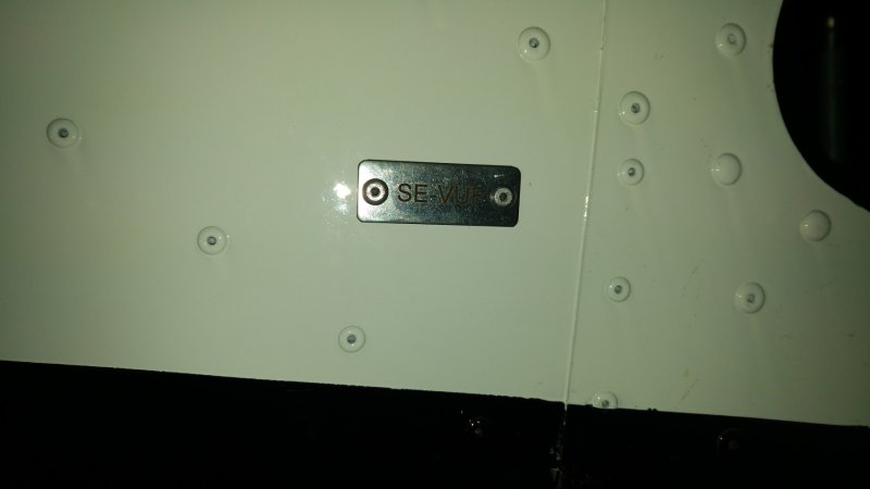

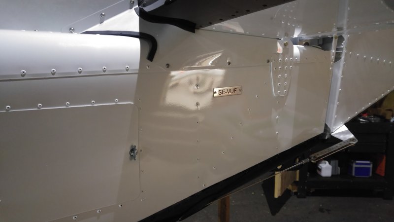

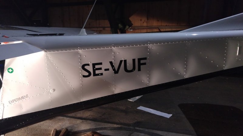

  5. Some small sign attached, thinking of getting registration marking up in the coming few days.

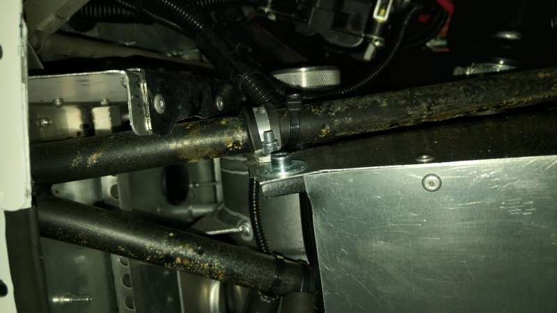

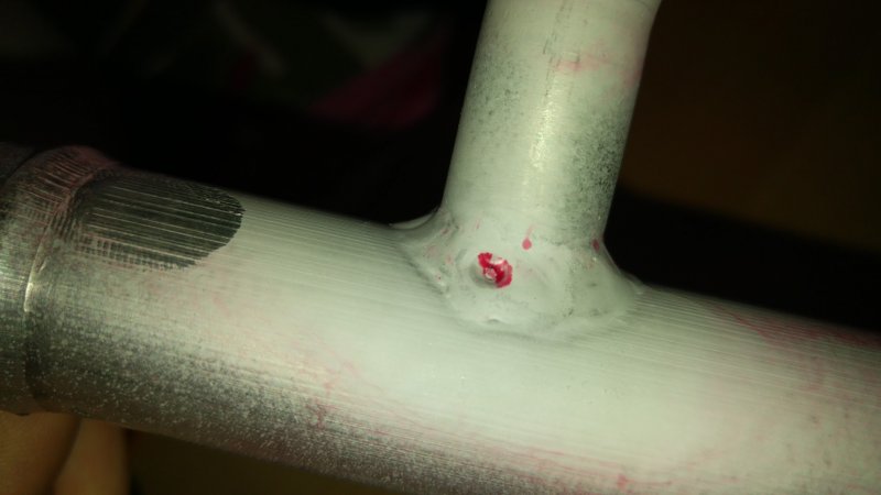

  6. So all the moist during the winter showed me that the cockpit structure and engine mount is bare steel, har do rub it all and paint it. Fuck

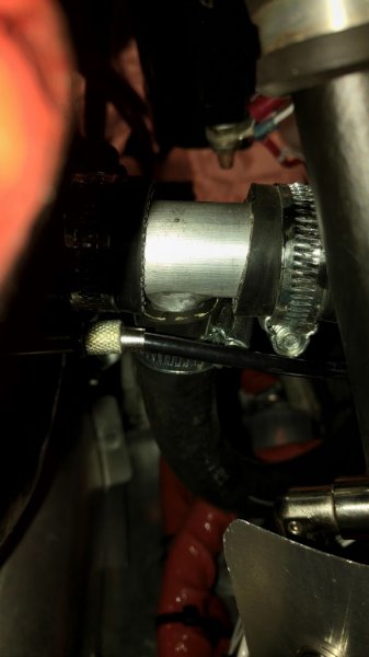

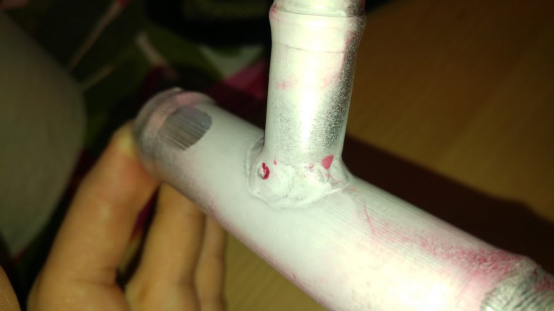

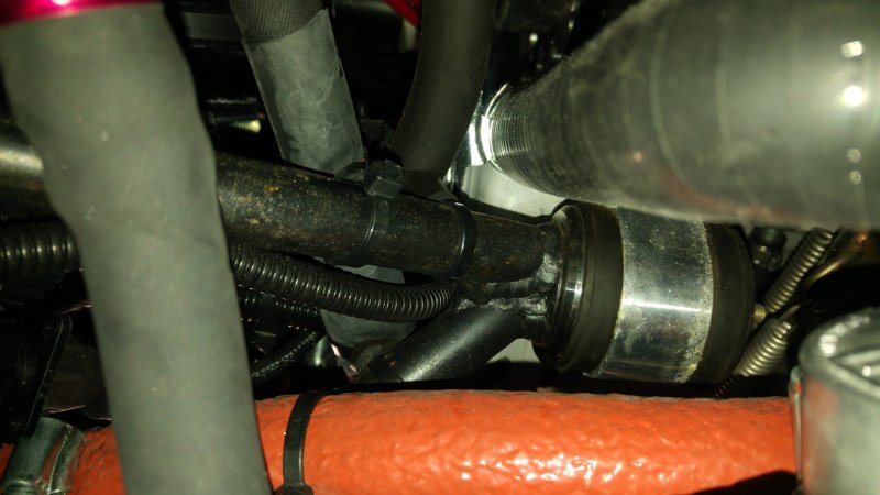

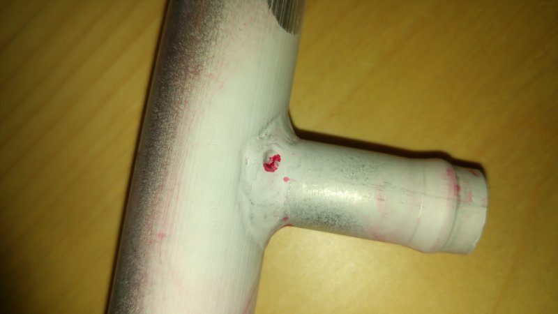

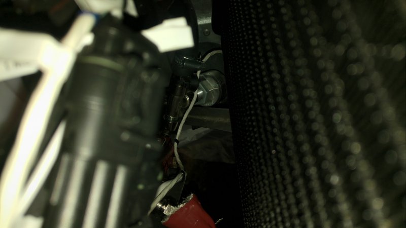

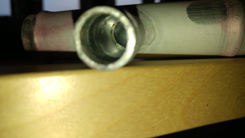

  7. Had a bad T coupling in the water coolingsystem. So much shit to fix....

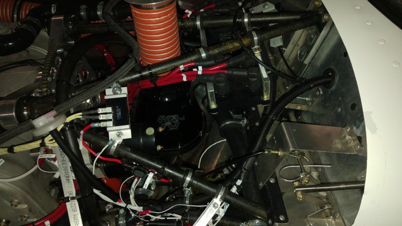

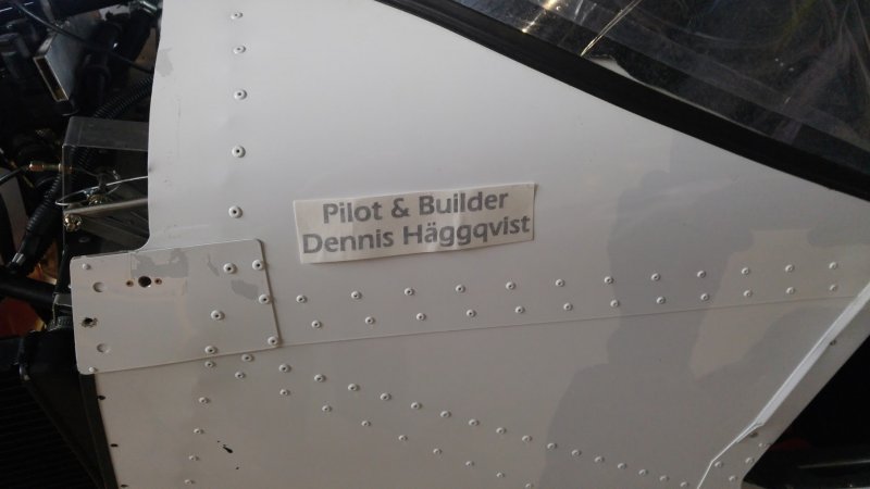

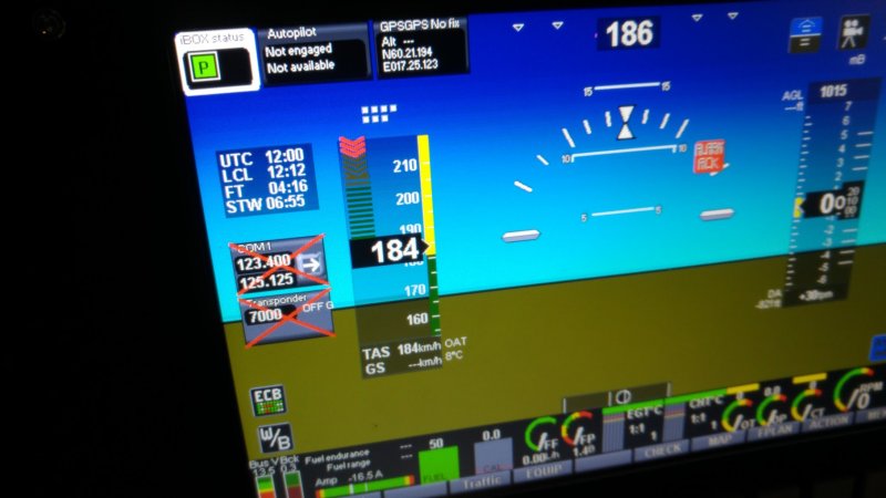

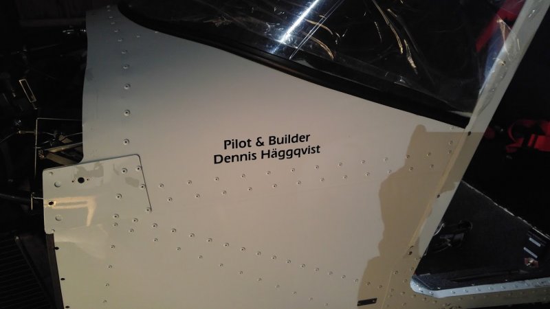

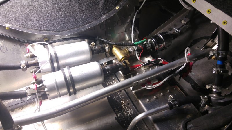

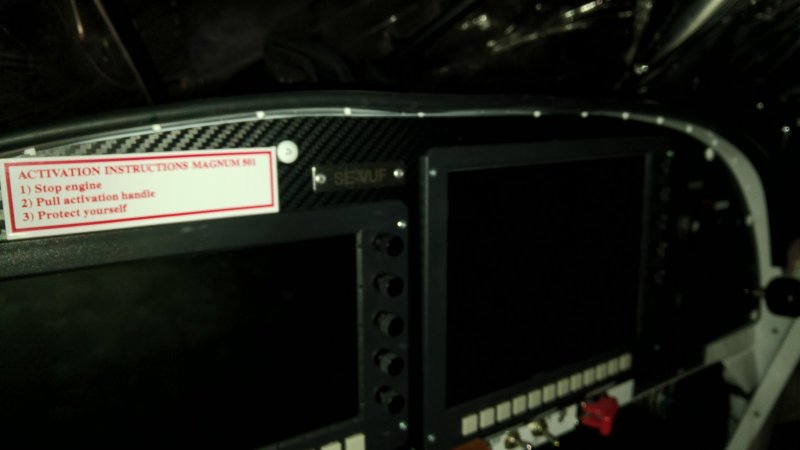

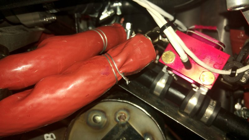

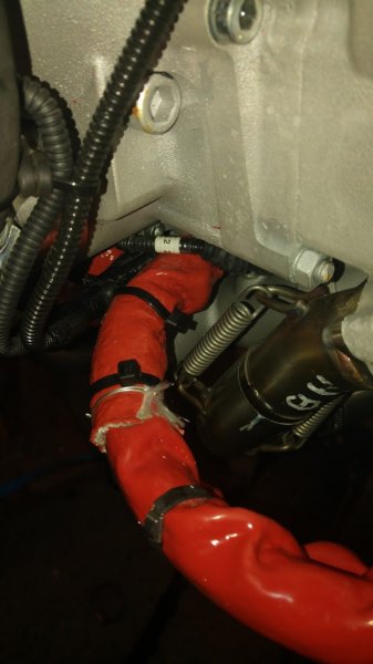

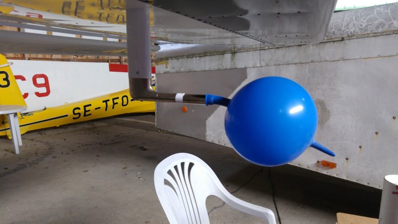

  8. So i had som issues with my fuelsystem, it was a hoseclamp for a firesleeve that blocked the incoming line, so now i have bought two new fuel pumps extra for no need and moved sensors around on the fuel line for no need, allot of work. I took a baloon to leaktest the pitot and static and all is well, 184 km/h in the hangar is nice. I also mounted those two consoles where i think they are supposed to be. Also i copied Mark Kyle on his Builder pilot sign.

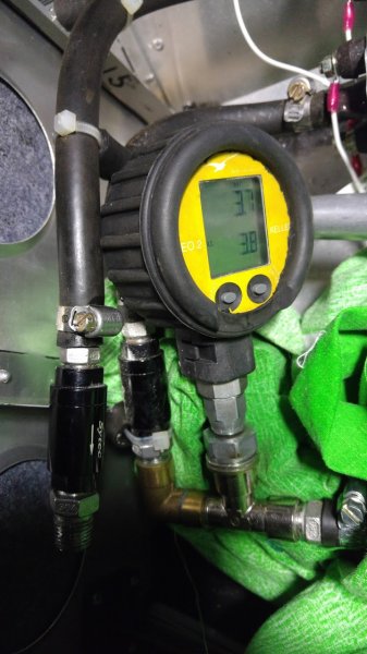

  10. No idea, do i need positive pres? So ive been having problem with my fuel preassure, after pumps it was 3,7 bar, so i found out i had diff manuf 4 bar pumps and they should be 3 bars, so i wasted another 120 euro and bought two genuine pump only to find out i still got 3,7 after fuel pumps, on a whim i measured after engine and got 2,5bar at the fuel regulator. why? And for some reason my efis measures 1 bar wrong?!? adn there is no settings to calibrate it? what on earth, am i not ment to fly this year? Another annoying thing, i have 2 flow meters to, one ahead of engine and one after so i can see total usage, flow meters 1 & 2 work perfect on input 1 on engine monitor but i get nothing on input 2? so therefore i cant see total usage, MGL has a efis simulator and i tried doing the same there, and get the same problem, now i know it isnt user error. Ohh and does anyone know why my efis fuel pressure meter shows 1 bar too much?

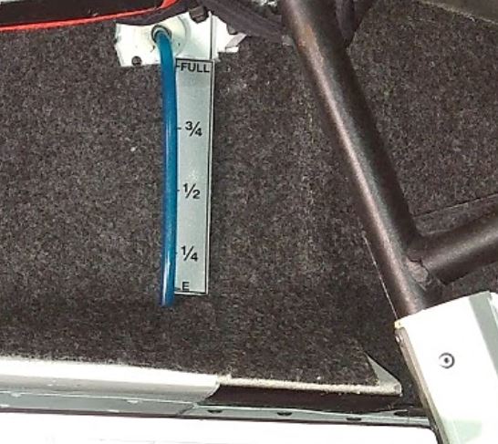

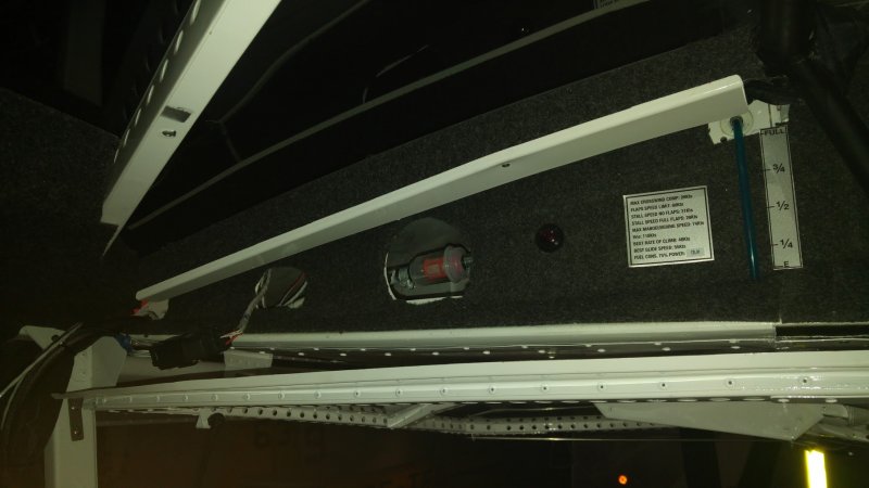

  11. Australian dealer sends out stickers that you place between fuel level meter and says level, and another sticker mentioning how many liters each line is.

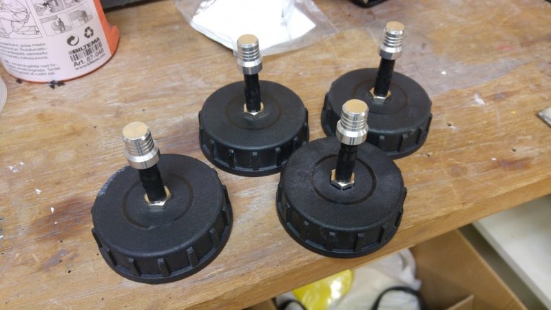

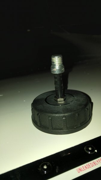

  13. Tank vents, they let air in and little out and close when the fuel flow out.

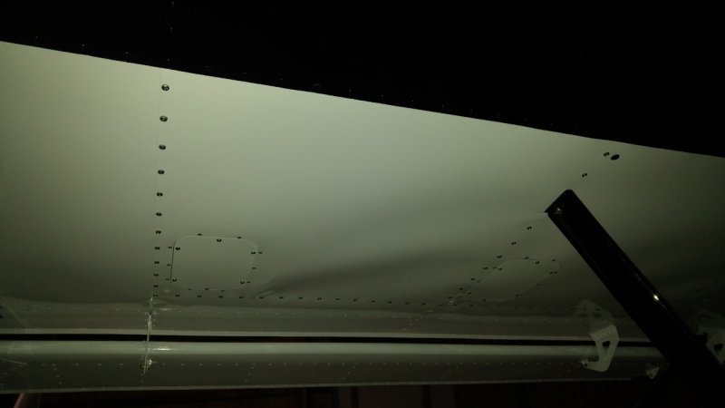

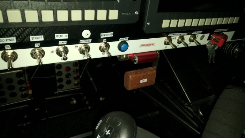

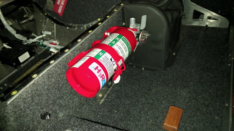

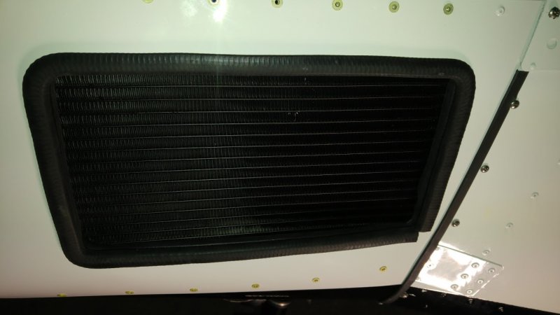

  14. I think i found out where they are supposed to fit, they cover the parachute bridles in the roof against the wing. I felt really dumb yesterday when i tried to circulate fuel but pump did not deliver, so i sucked and nothing happened, until i noticed wrong polarity on pumps, anyway fuel taste awful. It seems i have ordered wrong pumps, they deliver 140L/h@4bar, i need 120l/h@3bar, how great is that, i took bosch article number and crossreferenced it to a another brand and got wrong, so now i got 2 new genuine bosch pumps on its way. Installed a halon fire extinguisher . Also got my personal manufact sign up. Handbrake is finaly up, a nice piece of mahogny. I got the 3 atch lock fitted, cant really understand, it wouldnt let me get the back side of the door all the way in? Closed up the wings and installed the tank breathers. The radiator opening got some nice cooling guidance.

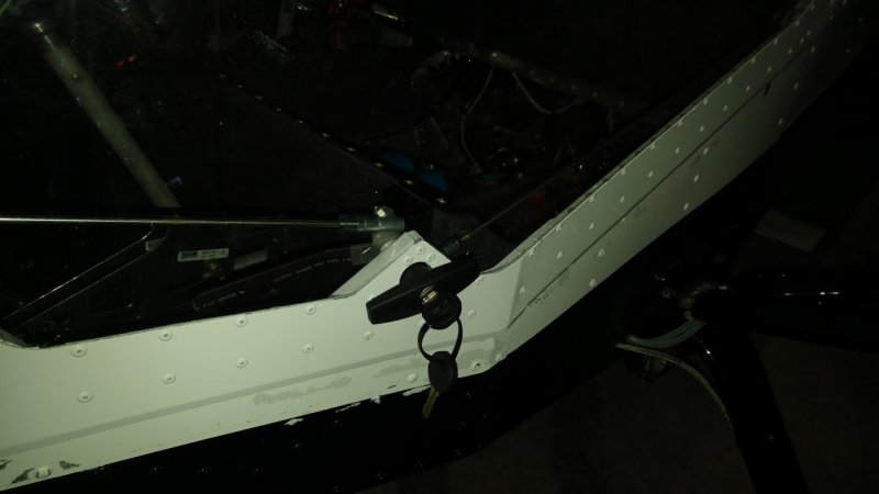

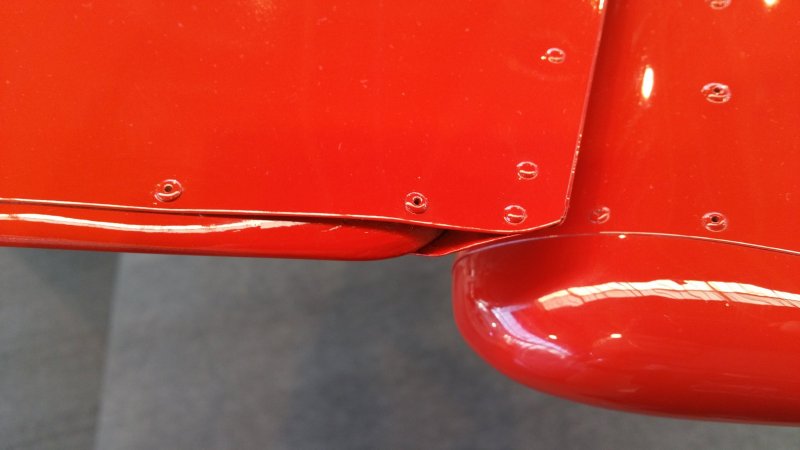

  17. My choice of different engine than a Rotax, I need to custom make one. I have found that the two parts relate to the parachute kit, just don't know where.

  20. I suppose this is what you are talking about.
