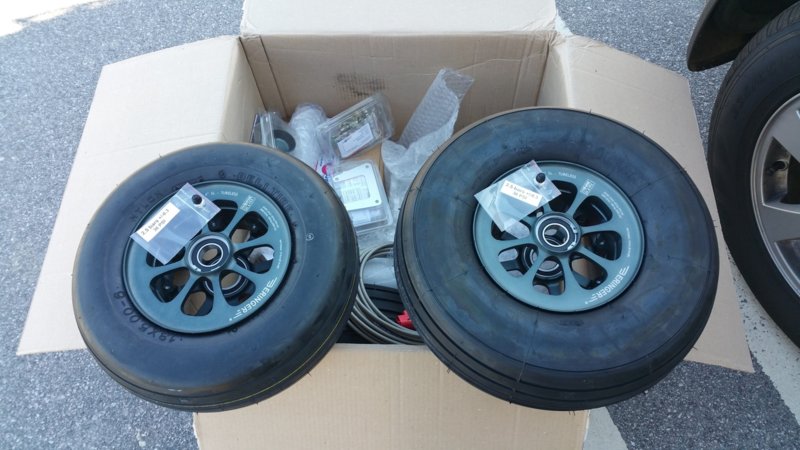

  10. i went to the wheel workshop and they helped me,, it needed some serious lube!,, in the end i changed my wheels to french quality Beringer wheels.

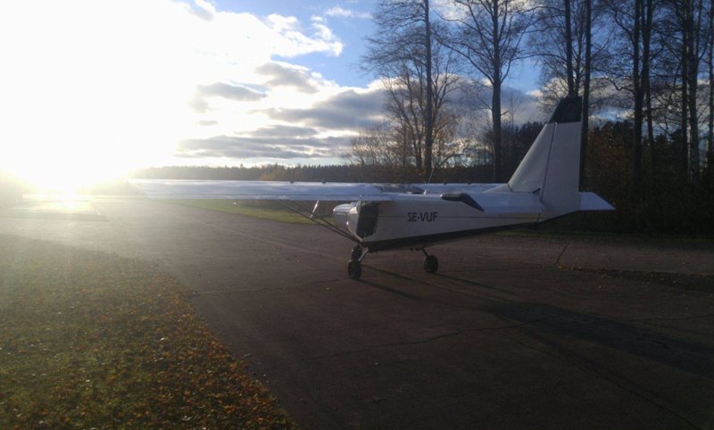

  18. Sun goes up and down really quickly here ;) this was my pre check ,, first engine start in 2 months before flight next time.
