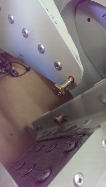

  4. Holes don't match. Before I drill it. One is Bush size one is bolt size . Thanks Lyndon

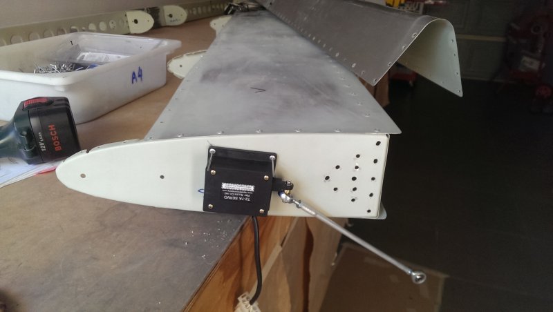

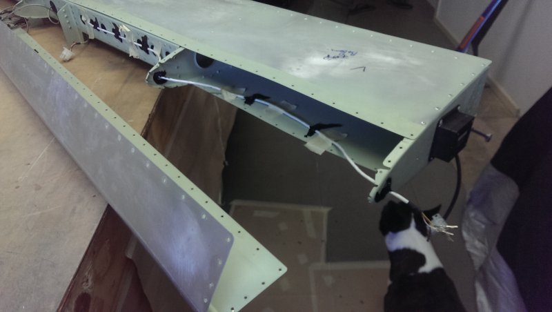

  6. I've. Pulled apart my stabilizer. Fitted the upgraded trim
  7. I think your correct
  8. So did I. Mine has a full a full length tab and mounts on the side in the kit ???
  9. I just have the servo on the left side
  10. Servo trim tab.. Manual mentions a right side motor ???.
  11. Got it. Thanks
  12. Same here. Looks straightforward. Thanks Lyndon
  13. Two white wires. Just reverse the polarity. 9 volt battery will even work
  14. Same I think. 5 wires. Earth and an up and down I take it. ??? Anyone know the colours Lyndon
  15. Safely that should say
  16. Just learnt something. I bought the upgraded trim tab kit. Primed it and I'm now fitting it. It's exactly the same as my kit. Bugger . Anyway with the 15 and 16 mm of movement on the tab. Can I just power up the unit safety or do I have to wait till the plane is ready to fly and adjust it. Be a lot easier to it while I'm building it on the bench. Lyndon
