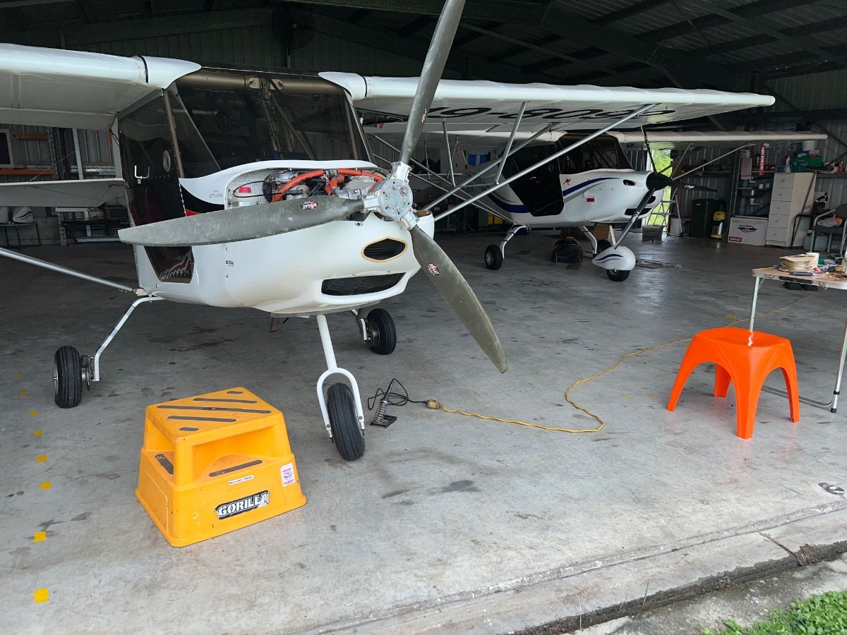

Blueadventures Posted August 11, 2014 Posted August 11, 2014 Well, our new Nynja flies well according to Greg. There are some minor issues to deal with but they will soon be ironed out. The weather on the day could not ahve been better and Greg managed some spectacular landings.Check out the video Hi Scott I purchased a Nynja kit from Mark Allen on Saturday, I live in Mackay and presently sorting my shed and arranging the components. Would you mind if I asked so questions from time to time once I get started; especially about any tips and improvement type of things. Mark mentioned about your way of trimming the engine cowl etc. Thanks Mike

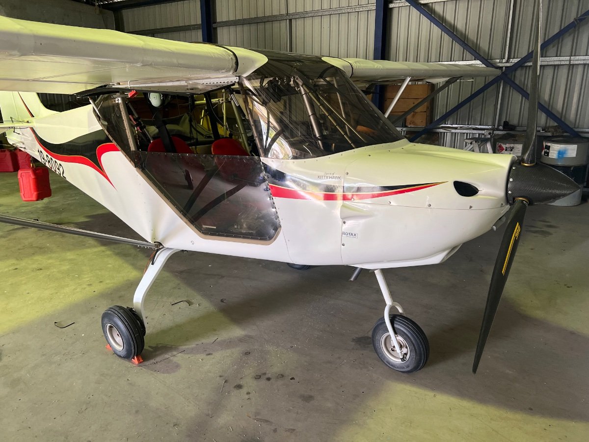

Blueadventures Posted January 7, 2023 Posted January 7, 2023 Spirit of Kittyhawk is due to be flown to it new home at Palmyra YPYA for its new owner tomorrow 8 January 2023.

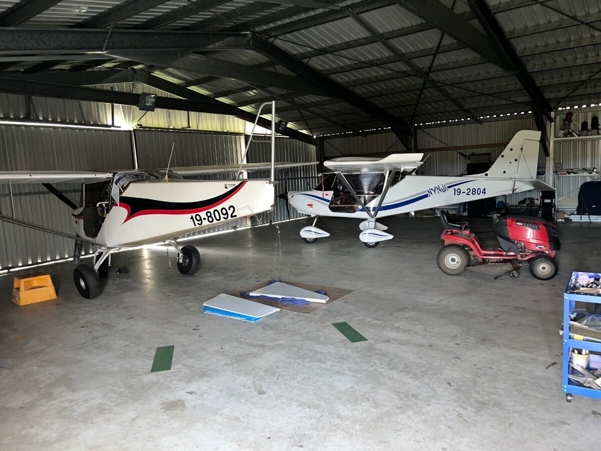

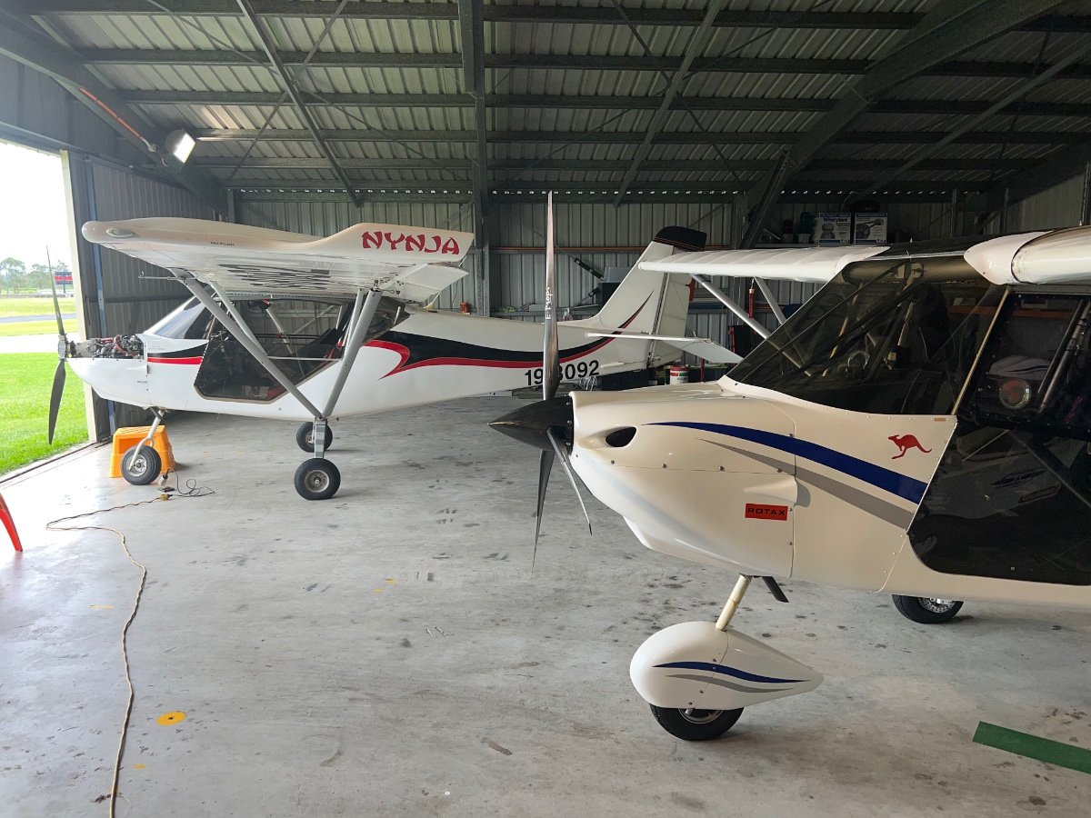

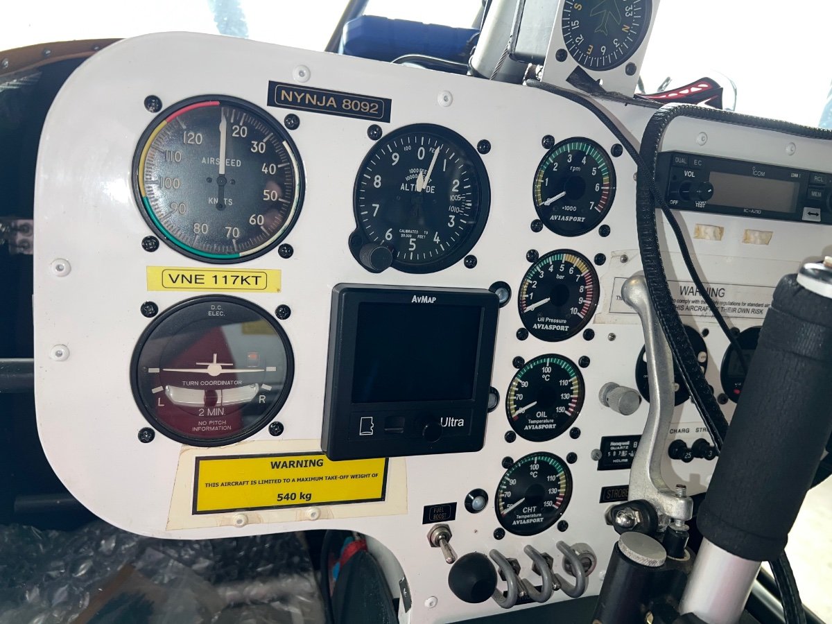

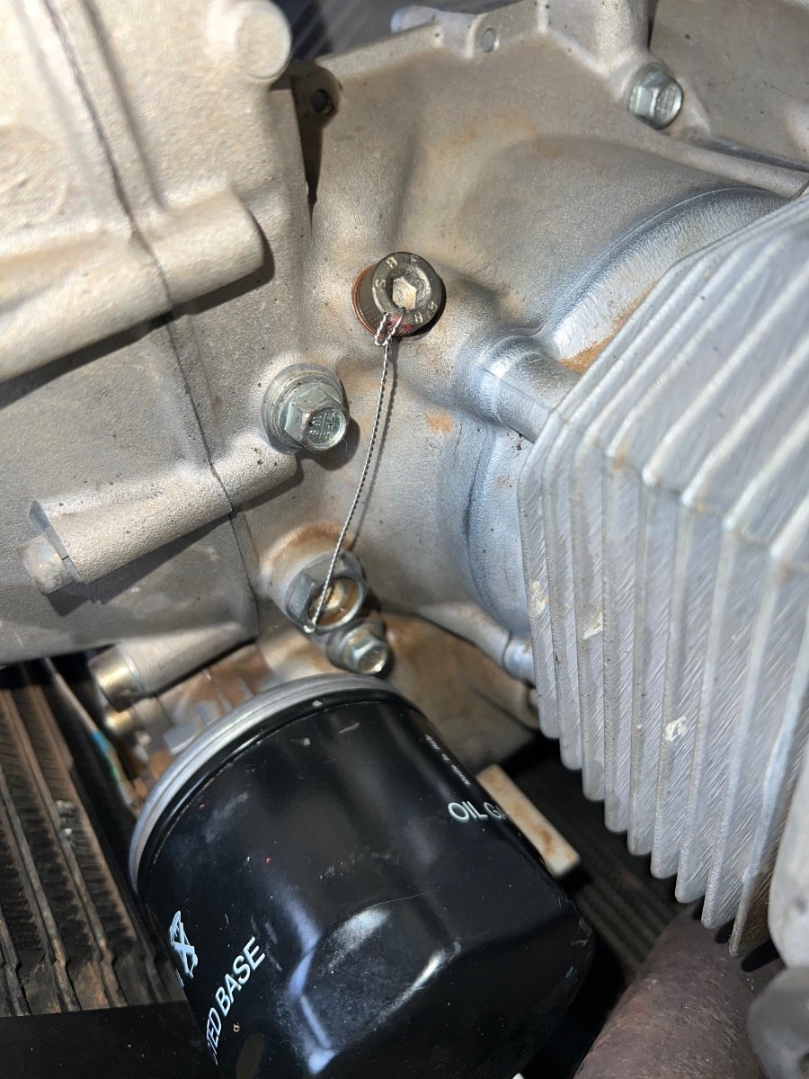

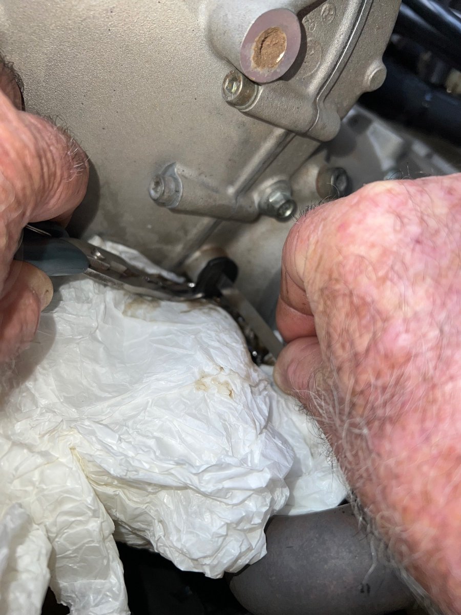

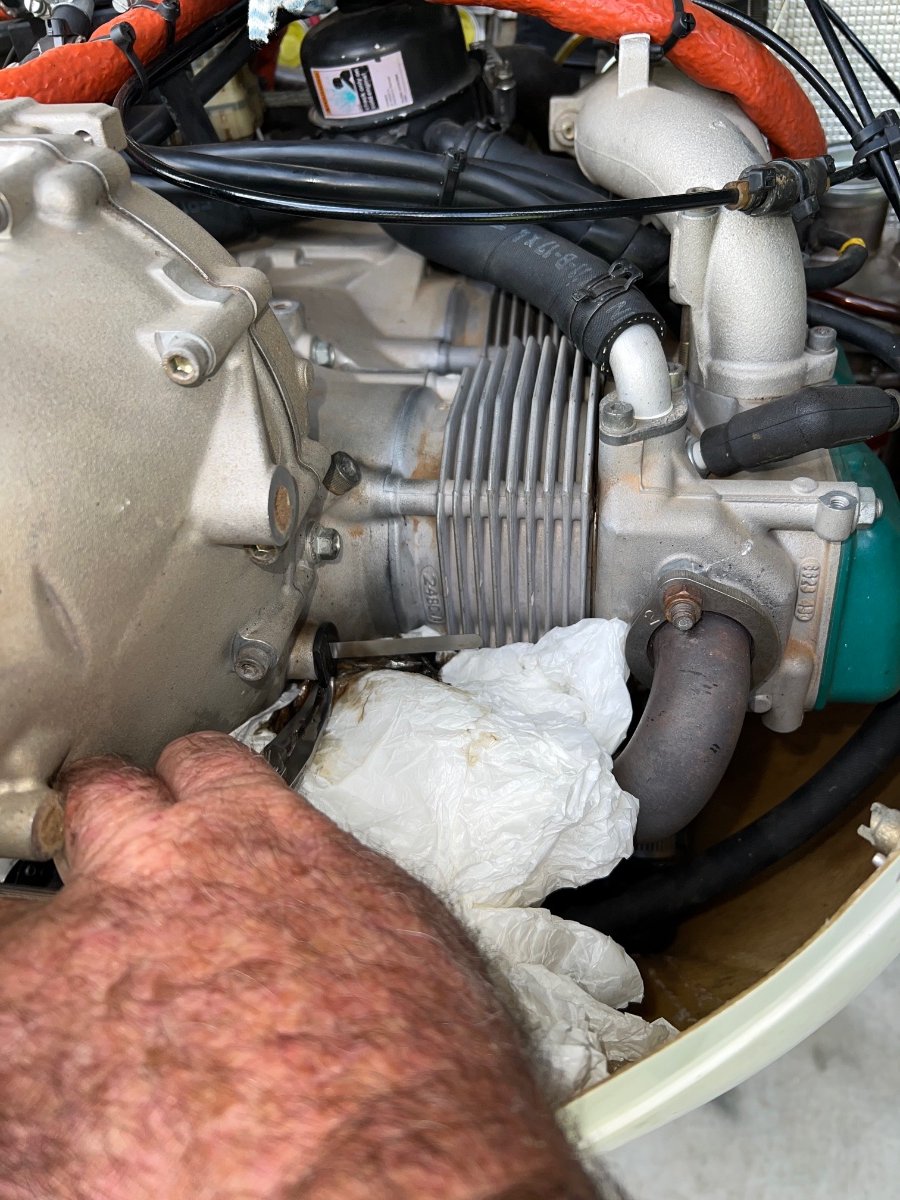

Blueadventures Posted April 3, 2023 Posted April 3, 2023 (edited) Fitted an AvMap Ultra efis to Ben’s Nynja built by Scott and did the crankshaft check required for that model. Nice to have two Nynja’s in the hangar. Edited April 3, 2023 by Blueadventures 3

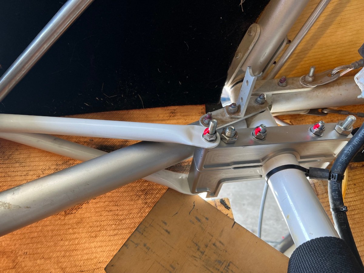

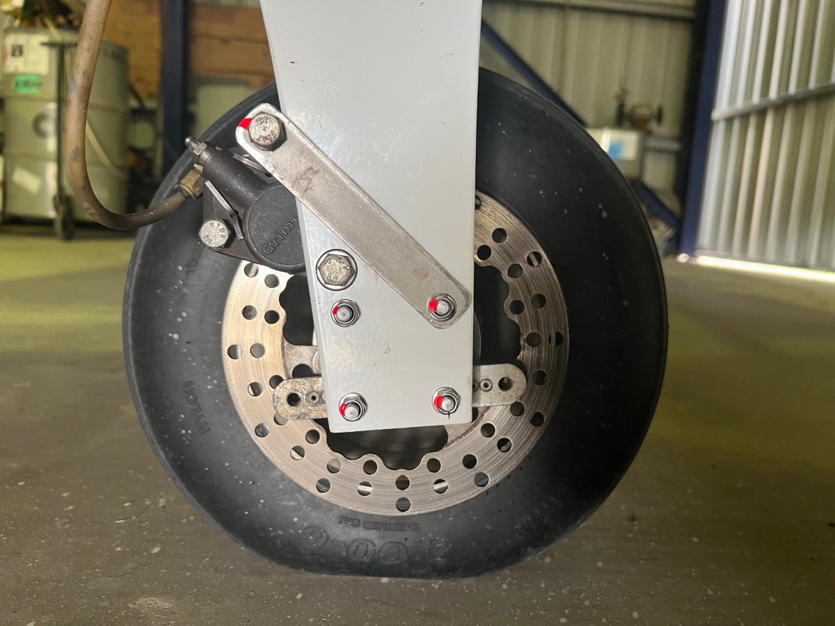

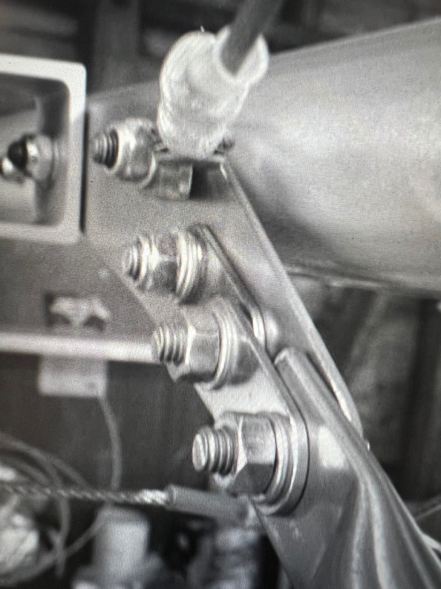

Blueadventures Posted August 10, 2023 Posted August 10, 2023 A newer model main gear one piece leg has been fitted to ‘Spirit of Kittyhawk’ and Ben flew her today and likes the feel of it. A full upgrade to 600 kg will be completed in the future, just awaiting some parts from the factory and the sign off for RAA w&b ratings. 1

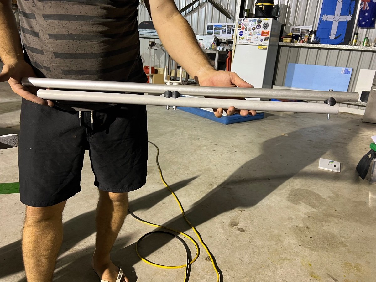

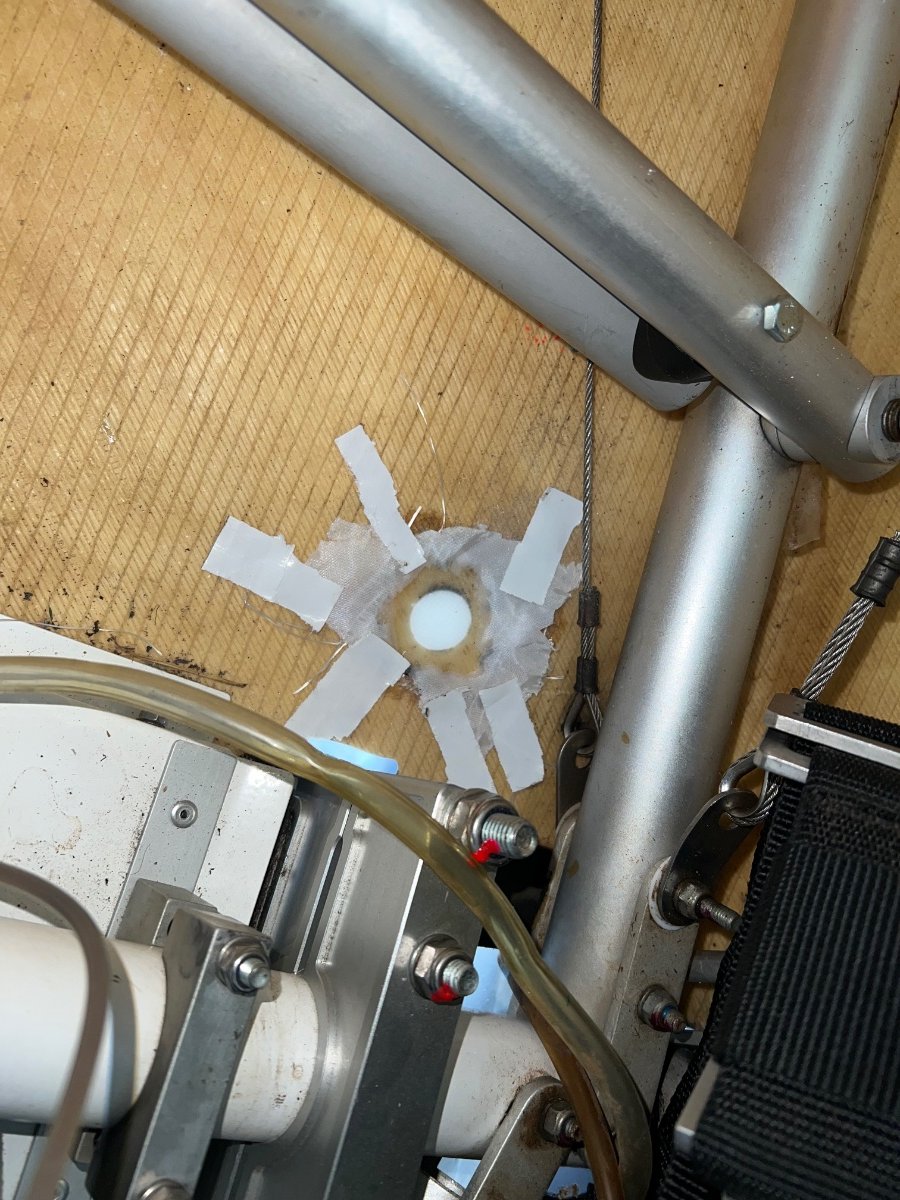

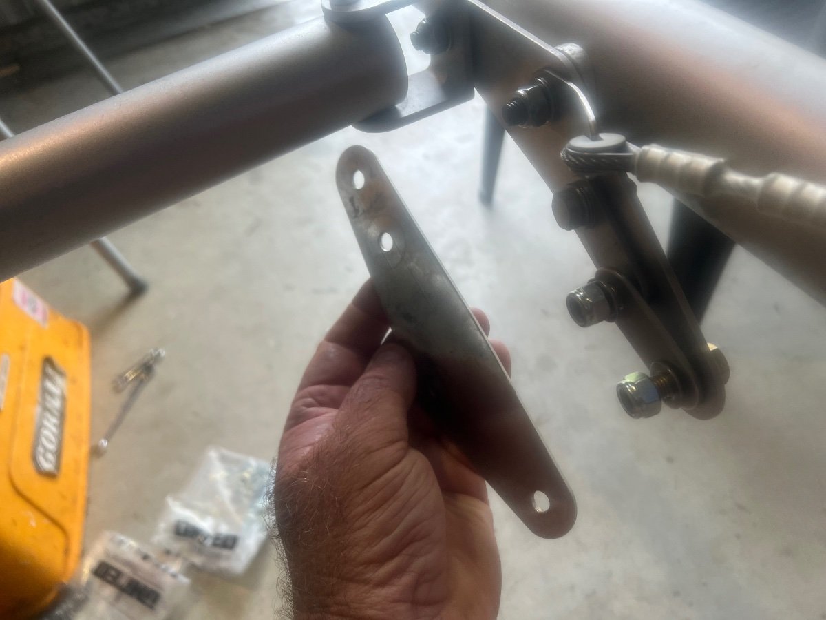

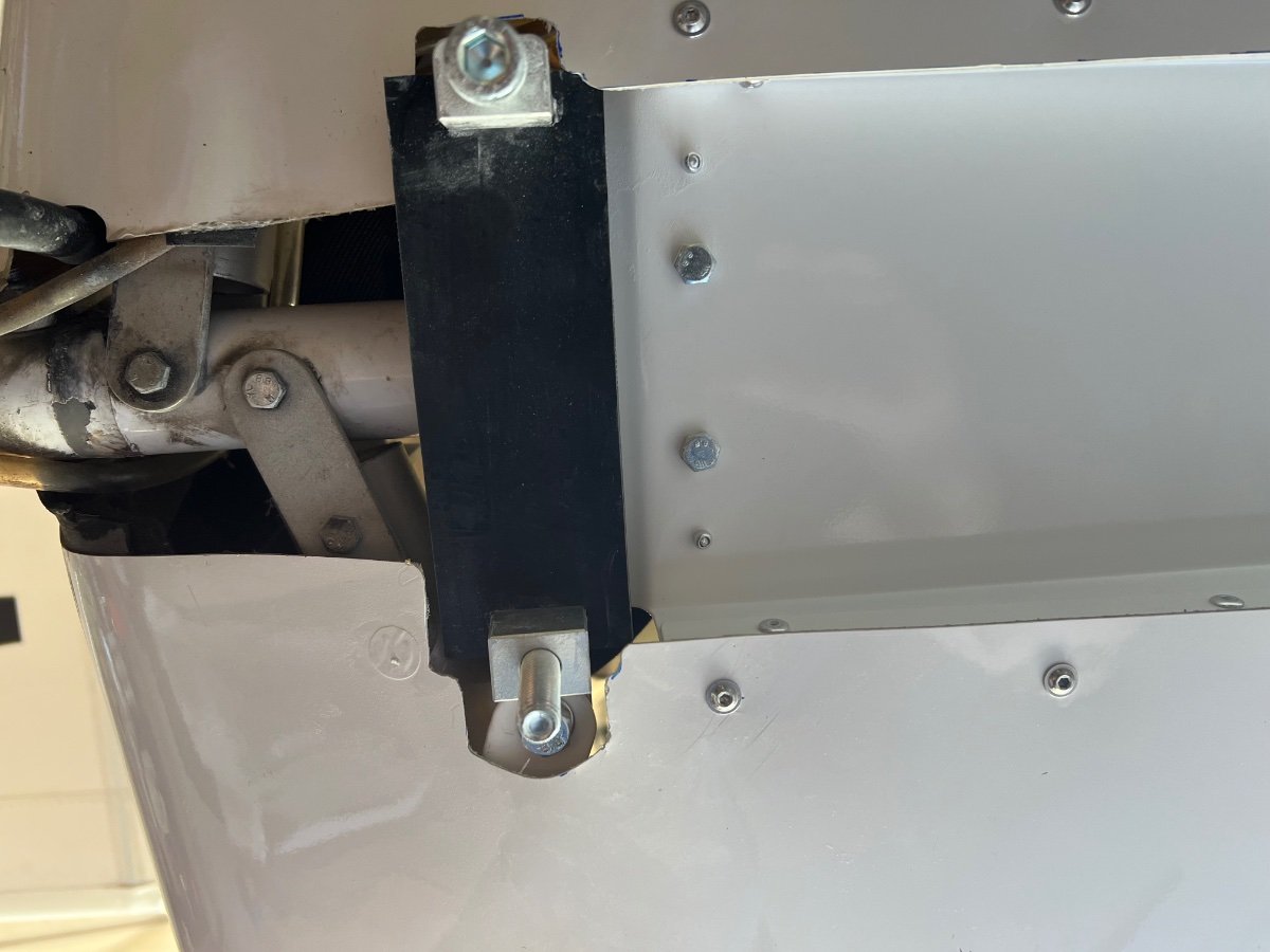

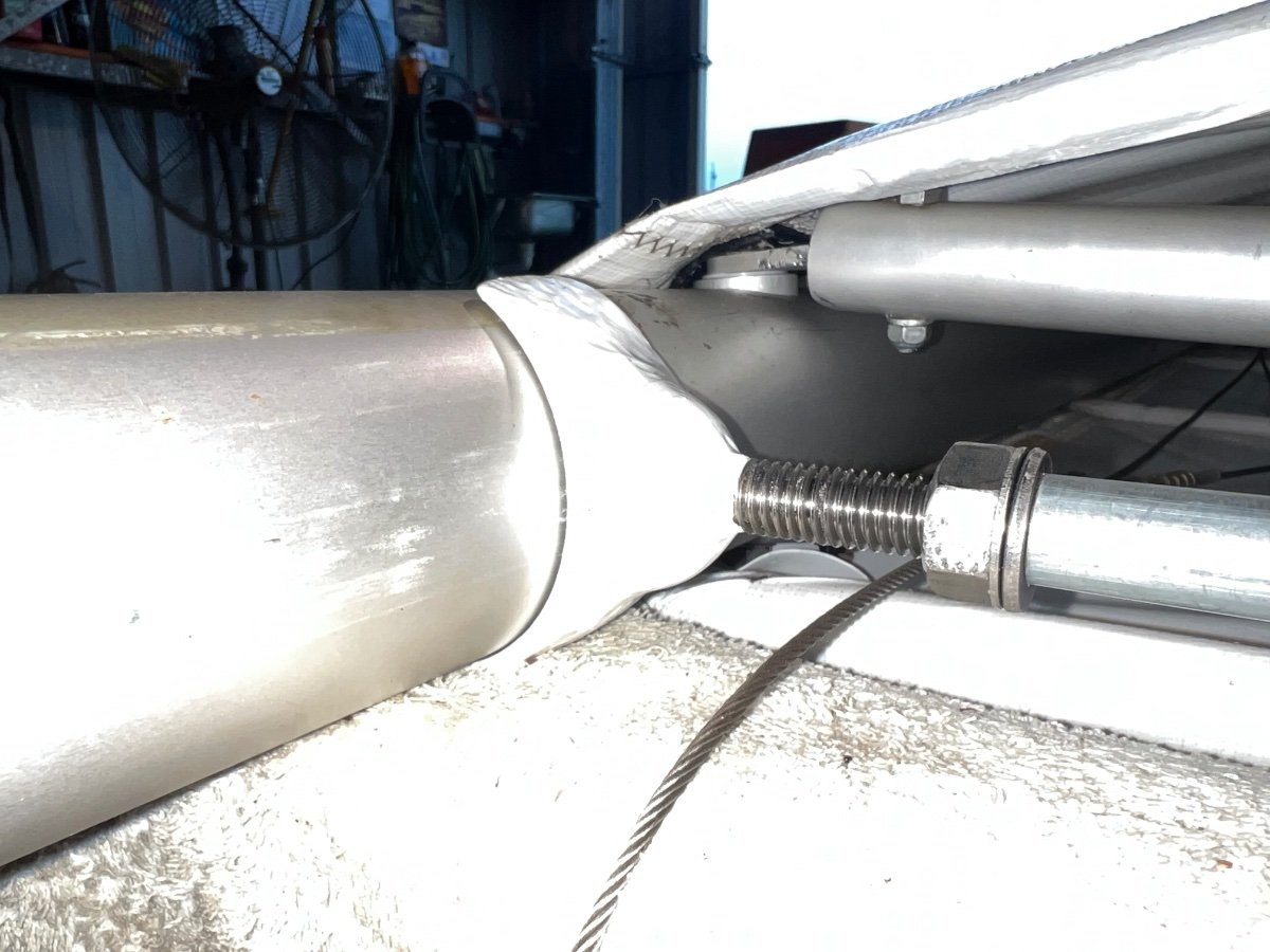

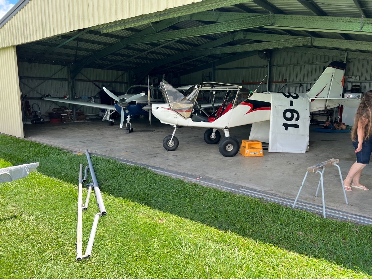

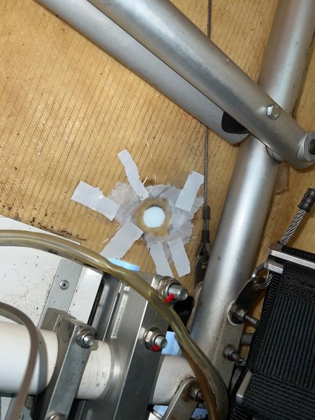

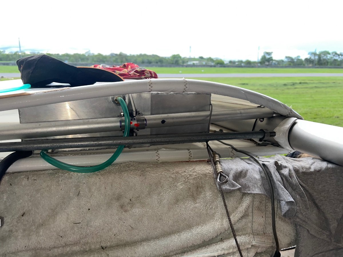

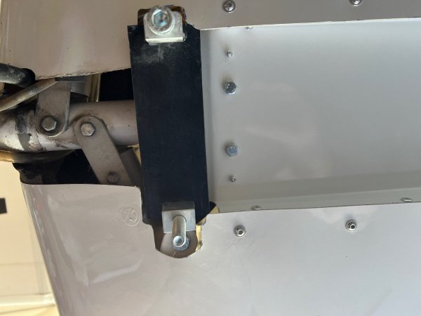

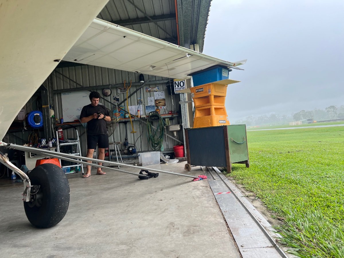

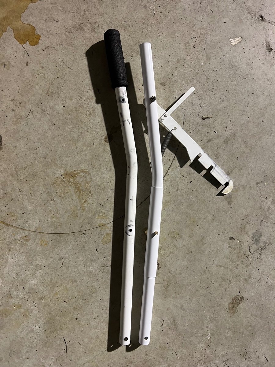

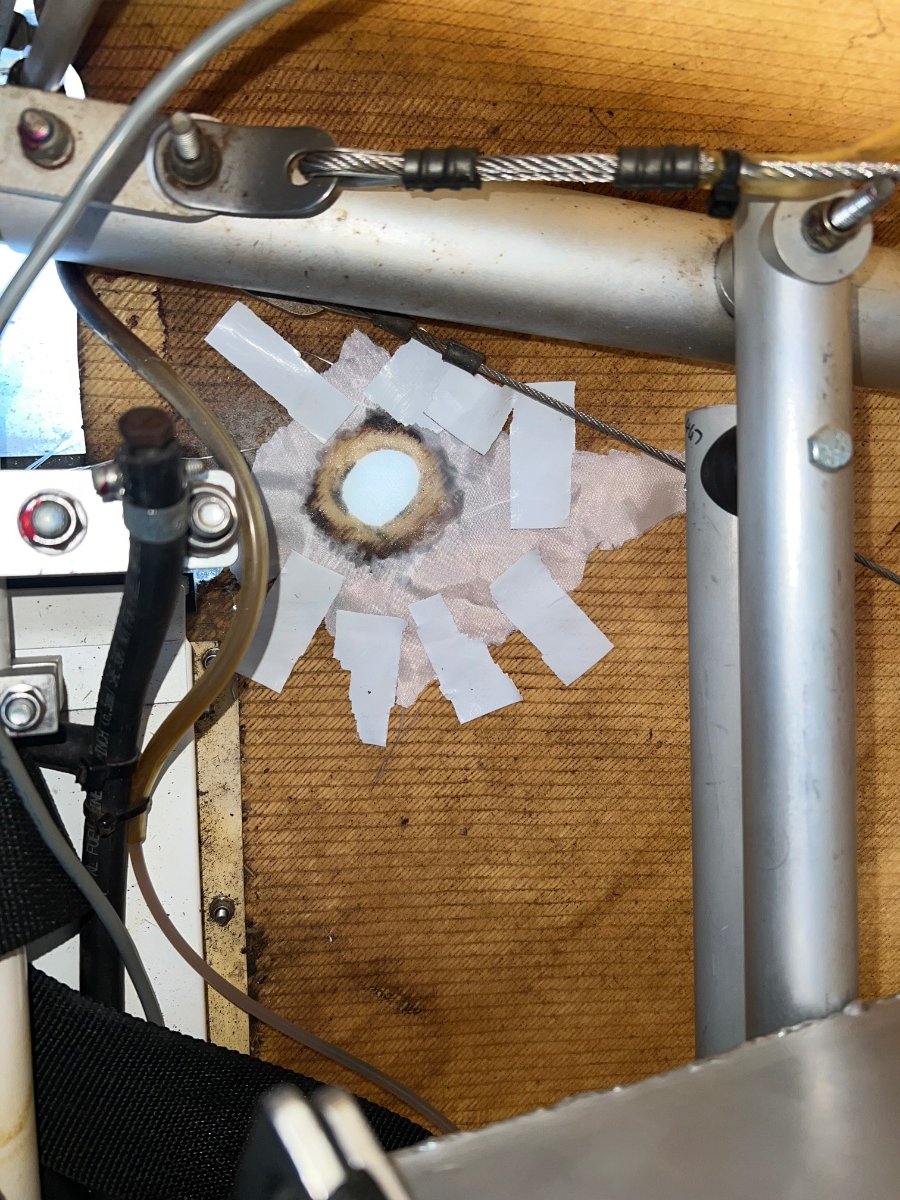

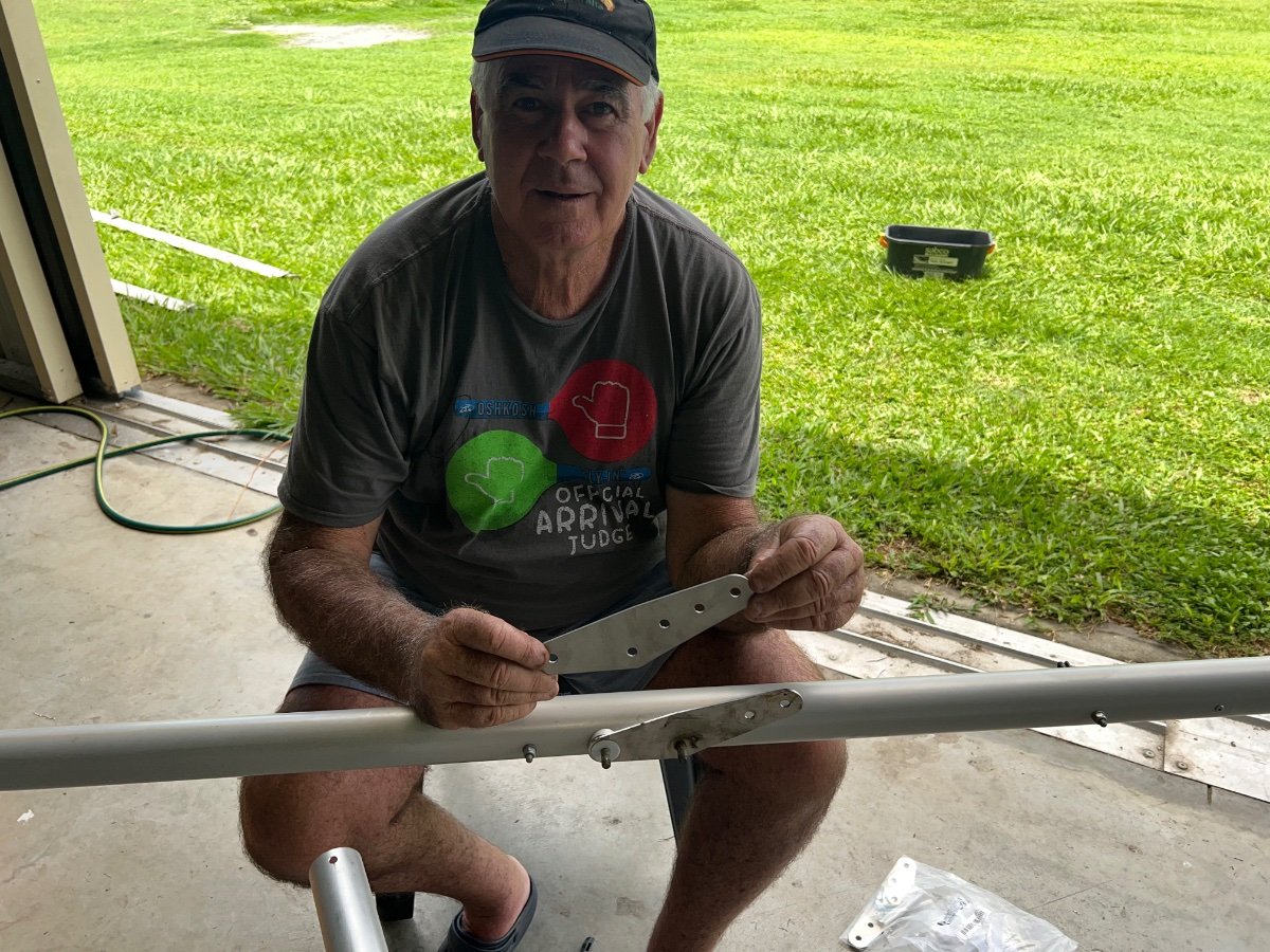

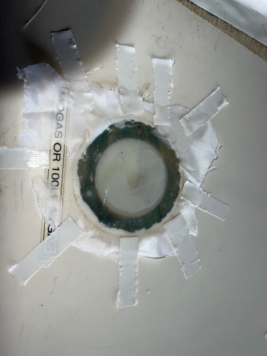

Blueadventures Posted December 19, 2024 Posted December 19, 2024 (edited) Spirit of Kittyhawk is getting wing tanks fitted. Owner Ben has been keen for them and we were waiting on the thicker three hole aft wing bracket to go with the thicker and beefed up front bracket. The rear bracket is optional for the 600kg upgrade but I got a set to put in my Nynja and got a set for Ben. Weather is for ducks up here so not missing any flying. Made a bracket to spread the wing tubes and works a treat. Epoxy and mat fill for fuel filler and the two fuel drains no longer needed. Also strengthened flap handle and its mounting tube doubler. Edited December 19, 2024 by Blueadventures 4

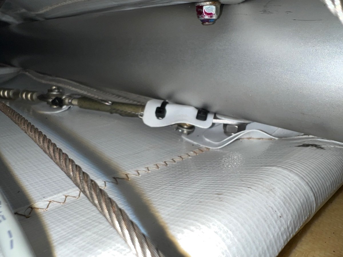

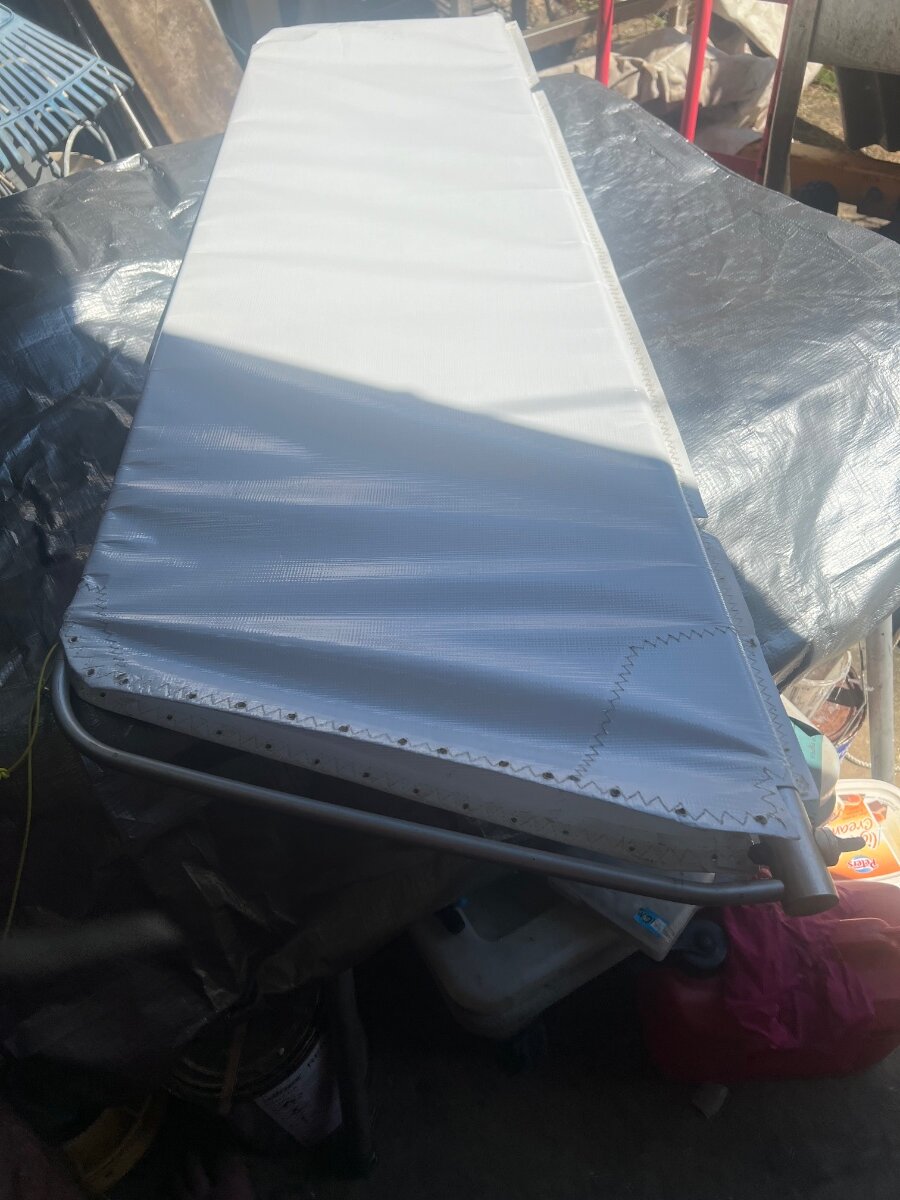

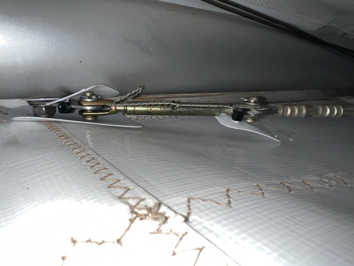

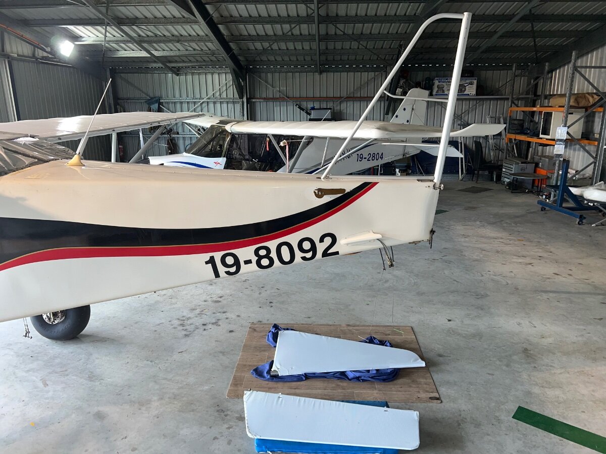

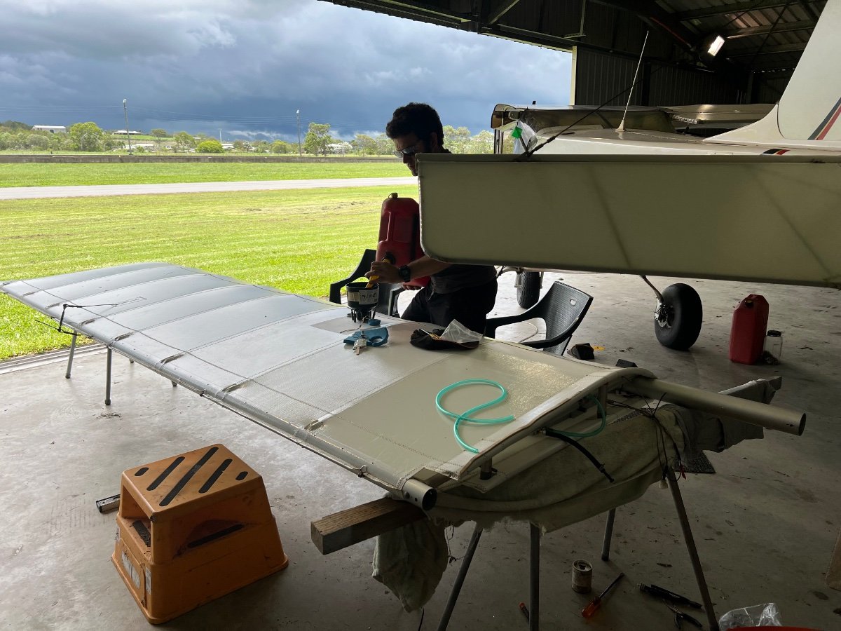

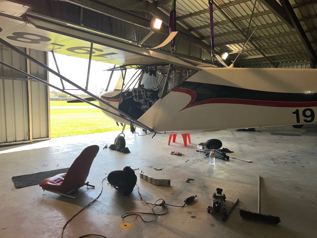

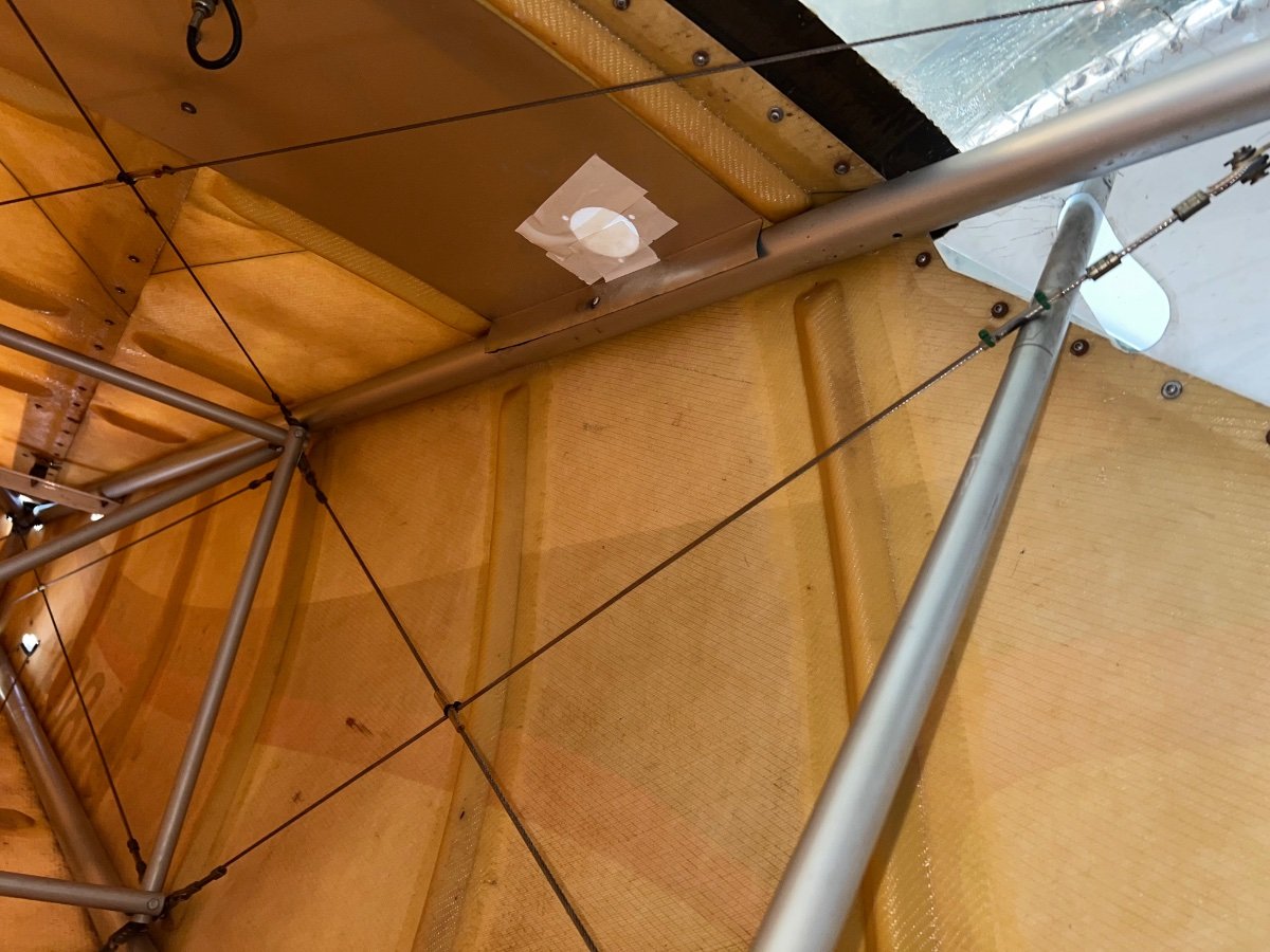

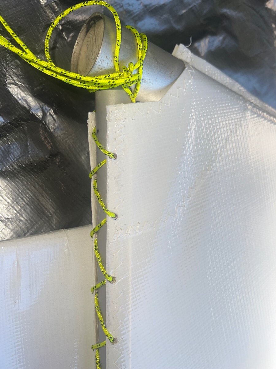

Blueadventures Posted May 1 Posted May 1 (edited) The stitching failed the 'Bettsometer' test; at about 1kg stitches broke (needs to remain intact at 1.360kg). Seems aircraft spent a couple of years in the open. New skins (all) were purchased from UK. Wings, rudder and one tail plane are done. Do some more tomorrow. Owner Ben is looking forward the work being done and also getting the 600 kg upgrade approved. I received a text that all my Nynja’s paperwork regarding w&b has been approved and will receive email approval to 600 kg tomorrow. Yeeha! Edited May 1 by Blueadventures 3
