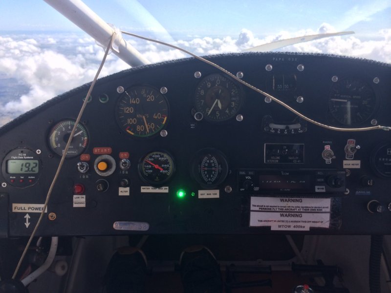

Doug Evans Posted August 17, 2014 Share Posted August 17, 2014 My in the pic is a little on the rich side but when I repitch the prop she now runs a little under 1100 which is pretty good as far a i am concern at about 17.8 lt hour , Hope that help ya Tim . 1 2 Link to comment Share on other sites More sharing options...
