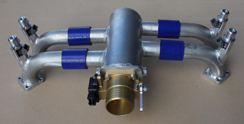

Downunder Posted March 4, 2016 Share Posted March 4, 2016 912 manifold Looks good. The only thing that concerns me is how high those injectors are. Then adding an elbow and hose. Maybe it's just the perspective, but for tightly cowled engines it could be a difficult fit. Would be good perhaps to have a low profile injector "cap" with a side fuel port. I guess the angle of the injector is relative to the intake port? Keep up the good work! Link to comment Share on other sites More sharing options...
Guest rv6ejguy Posted March 4, 2016 Share Posted March 4, 2016 Thanks. The tops are actually a little lower than the top of the carbs, but outboard further. The 912 is pretty narrow and most planes I've seen have a lot of clearance here on the cowl. We do have injector tops which have side entry holes, saving another 20mm in height over the 90 degree fittings in the top. That being said, there are so many variation in engine mounts and cowls, this manifold won't fit every airframe. You also must move the coolant tank and the ignition boxes around slightly. Tossing the factory ignition fixes the latter problem quite nicely! The boss tops are 125mm above the head surface and inside a line projecting straight up from the outboard bolt centerline by a few mm. There are velocity stacks formed into each runner tube for higher airflow. Link to comment Share on other sites More sharing options...
