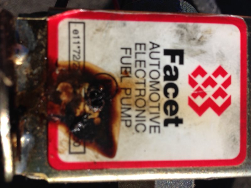

Geoff13 Posted February 24, 2016 Share Posted February 24, 2016 If you fit a Facet Pump, check the wiring very carefully. Link to post Share on other sites
cscotthendry Posted February 24, 2016 Share Posted February 24, 2016 Once you know the correct delivery pressure check Ebay as most of the models are there. A 4-6 psi Facet pump will only cost around $50.00 delivered to your door. The 40105 is quite an expensive model but check out the specs on the facet website & those with the same delivery pressure to find out why there is a difference. There is nothing "expensive" in my airplane. My life could depend on any part of it and I want the best I can get. If you put in "cheap" stuff in your airplane, then fly it like it will stop every time you fly. Yes I know we're trained to expect an engine out, but with cheap gear in your plane, elevate "possibility" to "near certainty". [ATTACH=full]41657[/ATTACH]If you fit a Facet Pump, check the wiring very carefully. OUCH! Not good to see crispy stuff at any time, but especially near fuel.... Link to post Share on other sites
