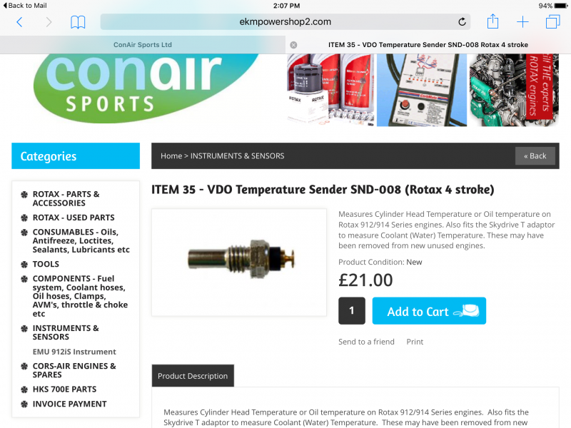

image.png.7d4f3b377a580f52a46494e2f29f1bf1.png If this is the correct sensor for a 912 then someone is ripping us off.....

New sensor arrived from the UK 7 days exactly from placing the order. $58 AU DELIVERED .Genuine VDO . Fitted easily test flown and no issues , need to wait now for summer to come back for a real test.
