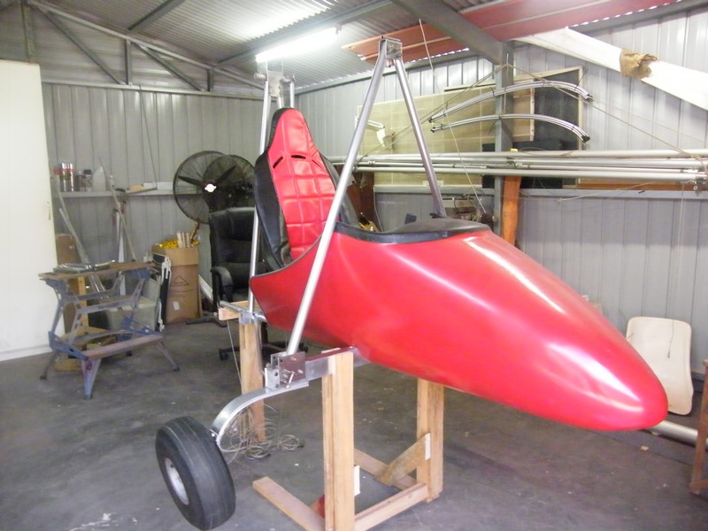

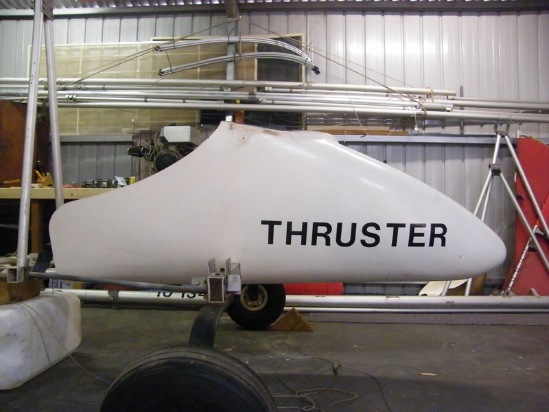

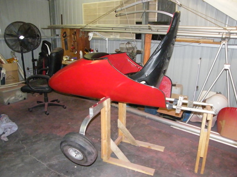

Deskpilot Posted February 3, 2017 Author Share Posted February 3, 2017 Been a while since I last posted so.............................I said this would be a long journey and it's turning out to be longer than I thought. Whilst the "do a little every day" idea is good in theory, it's no so good when you turn 75, the weather is way too hot and you have visitors from the UK staying with you. I got a little despondent over my person skills whilst repairing the pod on my kite. I couldn't get a good finish on the f/glass and consequently, the following paint job is crap. (It's all in the preparation folks, no matter what you're doing) Anyway, here are a few photos of the journey thus far. Not started on the engine yet Hmm, wifey took over half the garage yesterday to store the overflow of her "craft stuff". Just another hurdle in the journey to the skies. 3 1 Link to comment Share on other sites More sharing options...

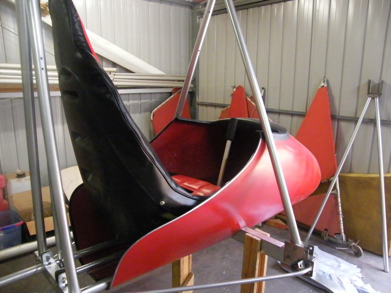

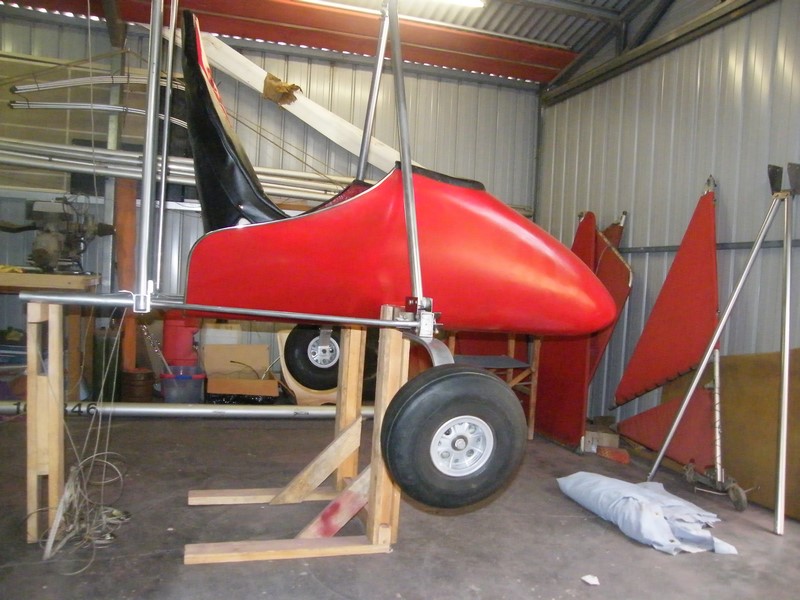

Deskpilot Posted February 12, 2017 Author Share Posted February 12, 2017 I'm finally seeing a light at the end of the tunnel in that my Thruster re-build is now underway. New floor in situ but not fixed. It's a snug fit and I might leave like that. New shock-cord fitted to rudder pedals, seat mounts re-positioned to take the seat and the battery tray clipped into place just for this photo. Next to-do is getting a new control column. the pivot point is now under the seat so I need a new one with a crank in it. Re-assembly of the boom supports will also take place this week. Whilst the wheels and suspension legs are ready, I'm leaving them off for the time being. I've got a question though. Plastic cable guides have a very narrow 'slot' into which the rivets go. How do you do it? A special rivet puller head? I met up with Ben/SVD (Bob) and his brilliant artist wife Margaret during the week and saw his 'gifted' Gemini. What a lovely find. Needs very little done to it but he tells me he's going to pull it to pieces so that he understands it's make-up. Skins are in excellent condition for it's year, not rotten like mine. Anyway, I'll leave it to him to talk you through his journey on a thread that I'm sure he'll be happy to open (get of of that, Bob) 2 Link to comment Share on other sites More sharing options...

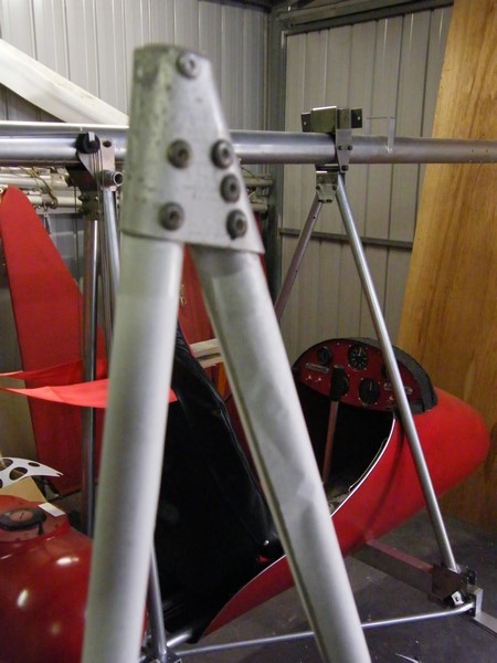

Deskpilot Posted March 5, 2017 Author Share Posted March 5, 2017 Having rebuilt my cockpit assembly, I'm in that awful position where I have 2 parts left over. Anyone know where they might go? This is where I'm up to. Link to comment Share on other sites More sharing options...
Pilot Pete Posted March 5, 2017 Share Posted March 5, 2017 What about that spot on the uprights behind the seat back? Link to comment Share on other sites More sharing options...
Deskpilot Posted March 6, 2017 Author Share Posted March 6, 2017 That's what I thought but they're a different pitch. I've searched for unused holes and there aren't anymore, not even on the boom. Link to comment Share on other sites More sharing options...

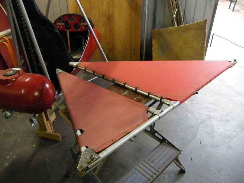

Deskpilot Posted May 5, 2017 Author Share Posted May 5, 2017 There's a saying, "Slowly, slowly, catch'im monkey" and that's the case with my rebuild. Very slow progress but on the right path. My boom is now back on and the control wires partially reconnected. Look good from a distance but I've managed to mark the paint a few times. Put it down to age. My mum turned 100 a fortnight ago and there are days when she is steadier than me. 1 Link to comment Share on other sites More sharing options...

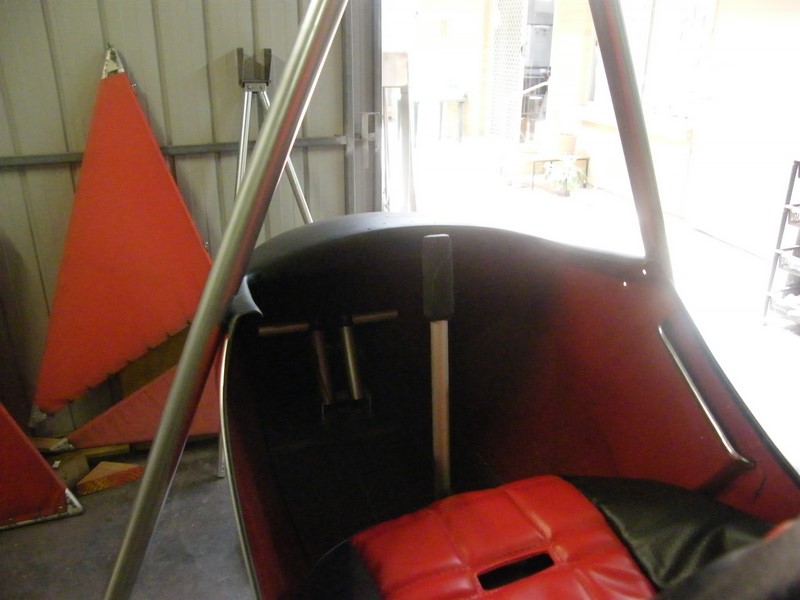

Deskpilot Posted June 22, 2017 Author Share Posted June 22, 2017 A few new images of my rebuild. Seat and cover hacked to fit lower and around control stick. Playing with a cardboard instrument panel. Still need to make a new c/stick, this one was intended to fit under the seat. New 3D printed tank mounts, I modeled on SketchUp and had them printed courtesy of my local library. 4 off, solid, $8.00 the lot. To think I was originally going to have them machined from alloy billet. Before you ask, we used the hard stuff that Leggo is made from. Very tough. I will be putting bolts through them later, but only on the bottom rails. 1 Link to comment Share on other sites More sharing options...

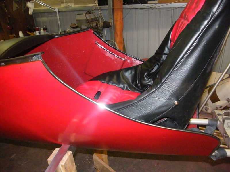

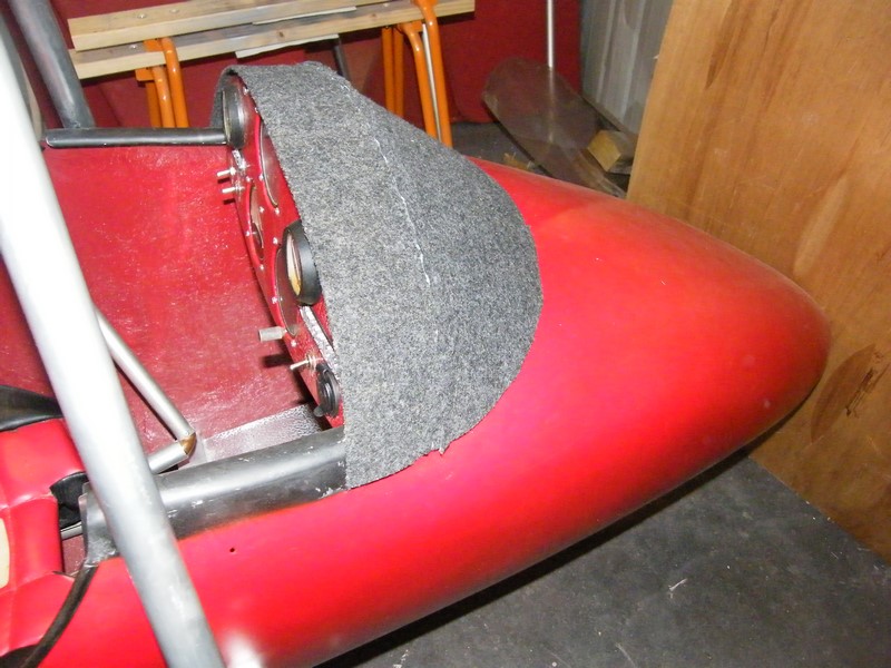

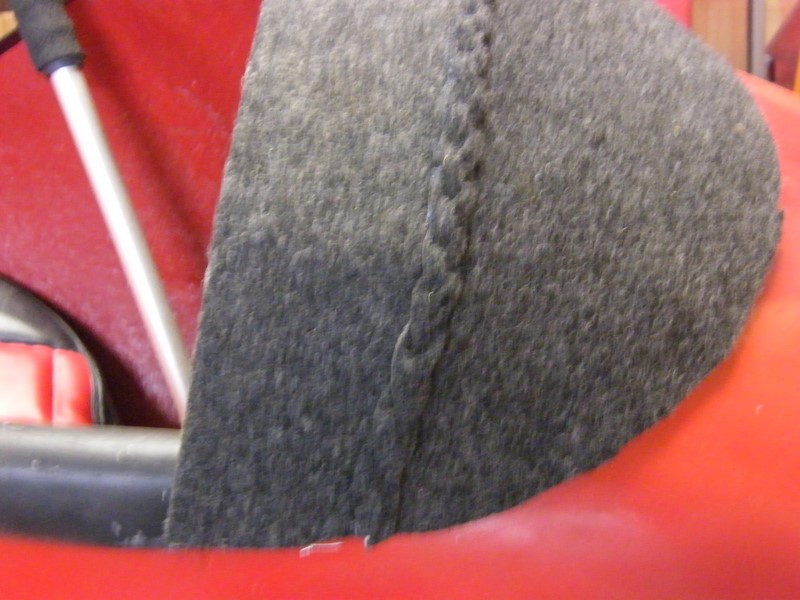

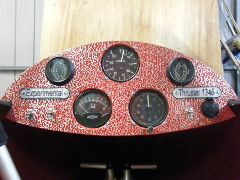

Deskpilot Posted November 5, 2017 Author Share Posted November 5, 2017 Time for an update. Although not wired or plumbed, my new instrument panel is ready for completion. I finally decided to go with the all red finish and to keep it warm, there's a nice new top-coat with a smart platted belt. The windscreen will fit around it and will be finished with a nice 'chrome' strip. So as not to smash my face into the panel in an emergency, I'm in the process of fitting a 4 point safety harness, (only AU$35 on Ebay. Brand new) Now, I've spoken about replacing the rotten skins with a resin impregnated Lycra. Having finally got the correct pressure foot and needle for my sewing machine, I decided to have a go on the skeg, that being the smallest part to 'cock-up'. As you can see, the Dacron is past it's best and certainly needs replacing. I removed the skin and after measuring it, I modeled it on SketchUp, and the scaled it down to allow for the stretch of the Lycra. This first effort was too small and I also realised that it would need to stretch more in one direction that other. This is the final size I came up with. Quite a bit smaller that the original and a hell of a lot cheaper than the replacement Dacron. My first purchase of Lycra was from Spotlight(for convenience) and a meter cost me about $35. I will source the bulk buy elsewhere at $10 per meter. Before things got 'sticky', I had decided to cover the tubes with grease-proof paper, just in case it has to come off again. My other half says it's too porous and won't work!!! Not a clear picture but the most difficult part was pinning it in place. Trying to inset small headed pins (they're going to stay embedded in the resin) whist the Lycra is trying to shrink back to it's original size. Another pair of hands might have been a bonus. Happy with the first fit, I proceeded to the first, thinned coat of resin. Mistake one, thinned it too much and found it difficult to get an even coating. Pressed on regardless, after all, it can/might come of again. Second coat hid some of the first coat errors So pressed on to the third and final coat. Doesn't look too bad. Brush strokes are evident but not unsightly. The final tension is almost the same as the Dacron, so I'm well pleased with the result. Managed to get it done in just over 6 hours(applying resin and letting coats dry slightly between coats. Fully dry in the 6hrs. Mi intention had been to add strips along the vertical tube to act as joint covers between the fin/skeg and rudder. A lightly 'resined' piece will bent very easily as the rudder is moved. However, I found that the Lycra roll on istself if no pinned in place so I'll make them separately and add them later. As usual, helpful comment are welcome gentlemen. Please don't criticize if you have nothing to base your criticism on. . Link to comment Share on other sites More sharing options...

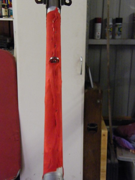

Deskpilot Posted November 7, 2017 Author Share Posted November 7, 2017 Hmmm, first attempt.....Failure. I think I got the resin/hardener ratio wrong as over-night, the resin layers began separating. At the time of brushing them on, I had wondered about the speed of setting. Now I know. Ah well, learn by your mistakes. I'll do some more test pieces and try to find the correct mix ratio for small amounts of resin.There must be an easier way than counting drops of hardener. Link to comment Share on other sites More sharing options...
