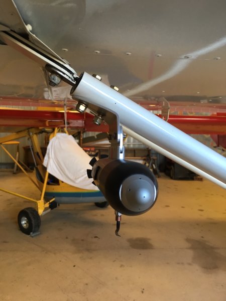

Kyle Communications Posted August 20, 2018 Share Posted August 20, 2018 Mine was originally mounted under the wing but I have since shifted it to the main wing strut similar to what Dan has done for his. Under the wing was too flexible 1 Link to comment Share on other sites More sharing options...
eightyknots Posted August 20, 2018 Share Posted August 20, 2018 Mine was originally mounted under the wing but I have since shifted it to the main wing strut similar to what Dan has done for his. Under the wing was too flexible[ATTACH=full]61589[/ATTACH] [ATTACH=full]61590[/ATTACH] [ATTACH=full]61591[/ATTACH] [ATTACH=full]61592[/ATTACH] Those pictures are good. I think it looks better mounted on the strut. Being that close does it interfere with the air flow? Will the turbine spin just as quickly? Will the accuracy be the same? Link to comment Share on other sites More sharing options...
Kyle Communications Posted August 20, 2018 Share Posted August 20, 2018 The issue is the pressure wave from the wing that is the main issue and its far enough away to get clean air...mine is actually a bit lower than Dans Link to comment Share on other sites More sharing options...
