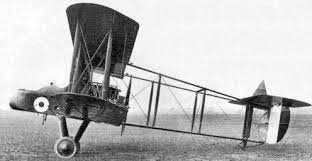

old man emu Posted October 29, 2020 Author Share Posted October 29, 2020 49 minutes ago, kasper said: You'd have to do this in RAAus becuase the CASA guy/gal faced with this nightmare will run screaming in the distance when you try to explain its a 6 motor fly-by-wire autostabilised magnus effect lifting device with no wing area and no stall speed cobbled together in my garage and managed with $300 of electronics from Hobby King I programmed up on this laptop 😁 Ha Ha Ha! Have a look at the KFC video to see how he gets the drums rotating. I see your point about having each drum powered independently in order to provide roll movement. From the video of the KFC buckets I formed the opinion that the engine should be a pusher, and set out like the Royal Aircraft Factory FE2D The video also indicated that there needs to be a lot of weight forward of the CofG. Perhaps the everything forward of the cylinders could be set out like a regular plane, and the pusher prop driven by a shaft. Link to comment Share on other sites More sharing options...
