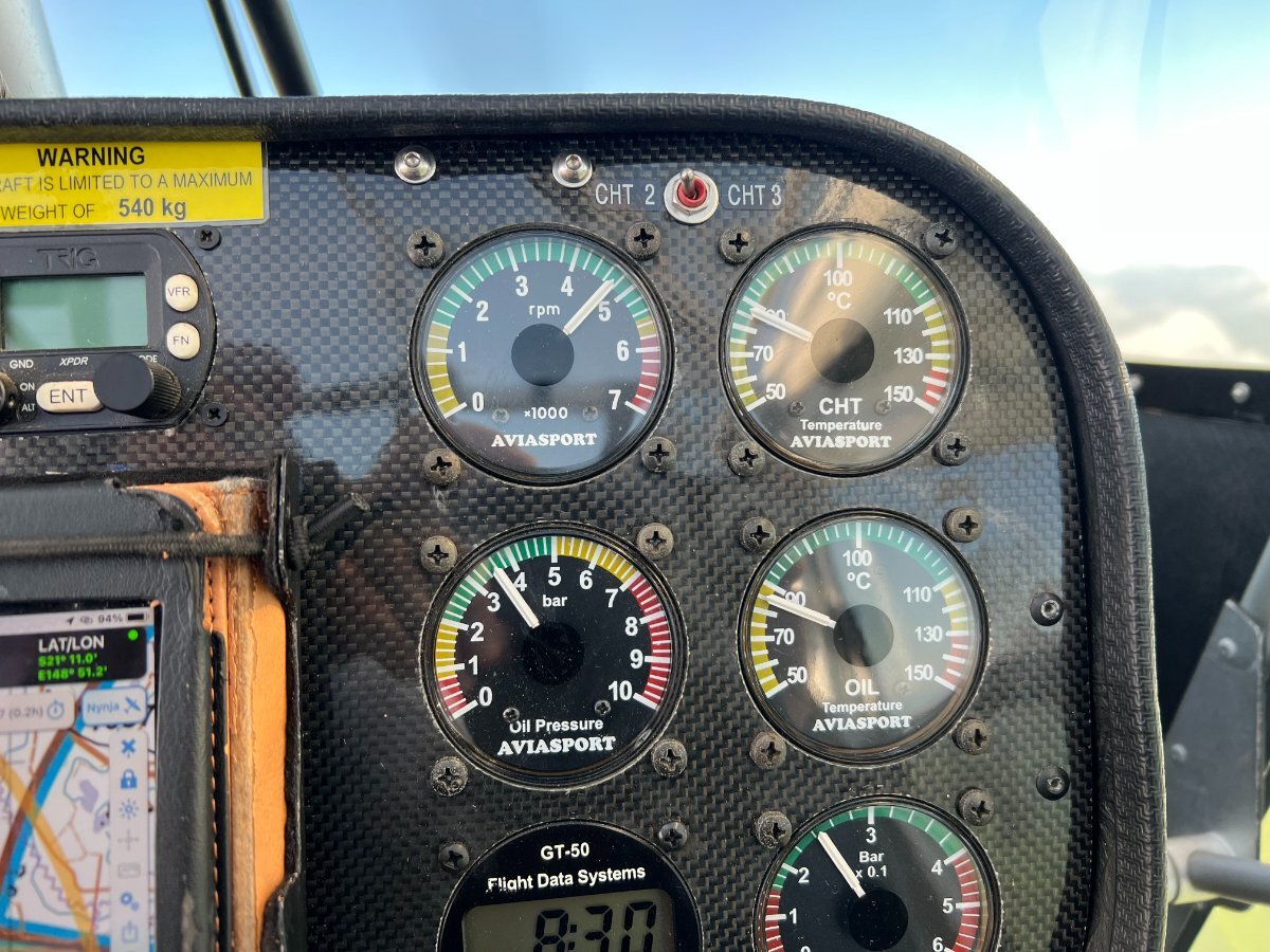

Blueadventures Posted January 18, 2021 Share Posted January 18, 2021 (edited) At time people ask what is the speeds of the Skyranger Nynja so I did a video on Sunday. Cruise at 5,000 rpm DUC propeller at 95Kts and at 5,500 rpm 105 knots. Edited January 18, 2021 by Blueadventures 2 2 1 2 Link to comment Share on other sites More sharing options...

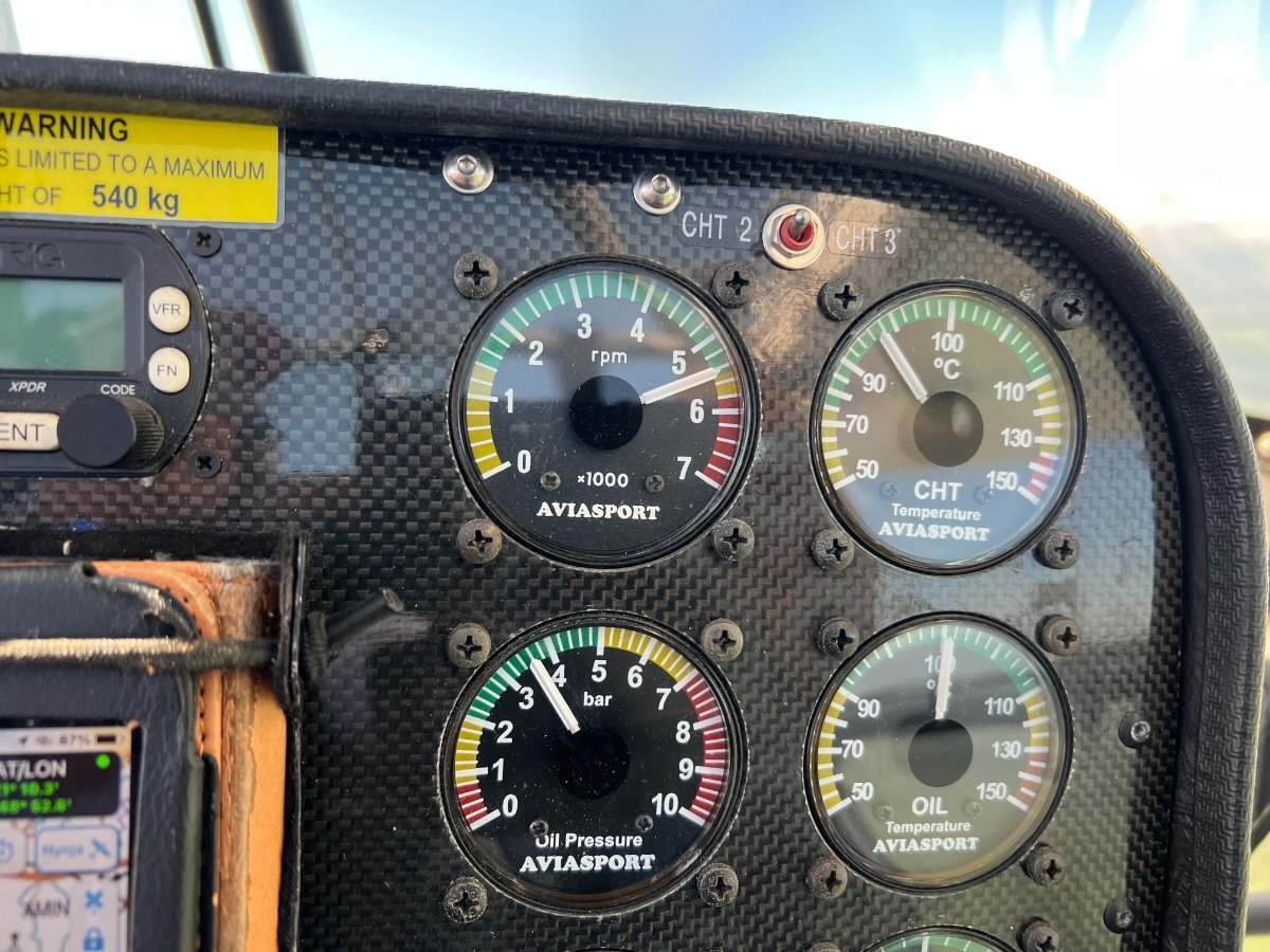

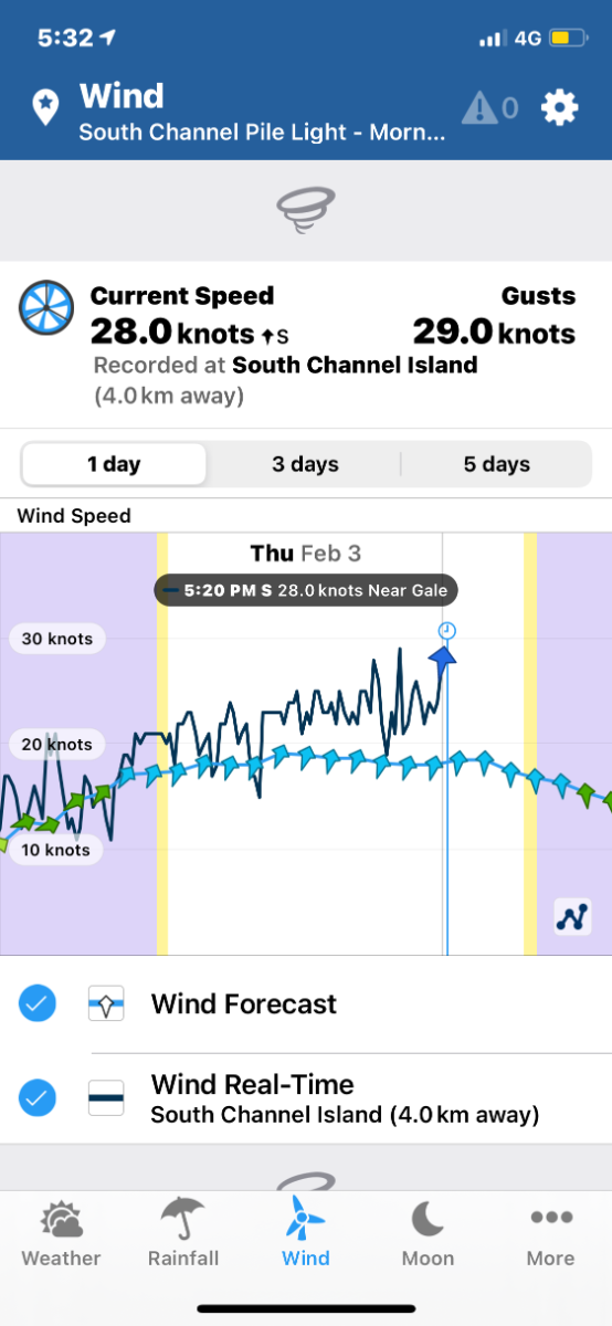

Mike Gearon Posted February 4, 2022 Share Posted February 4, 2022 Here’s a 5400rpm cruise pushing 110kn. Quite a cross wind component. Some 30kn. Other 2 clips are landing and take off with 15-20kn tail wind on another new French island runway. Runway is an uphill one way operation due to trees, the uphill and surrounding properties. FullSizeRender.MOV FullSizeRender.mov IMG_8035.MOV 1 Link to comment Share on other sites More sharing options...

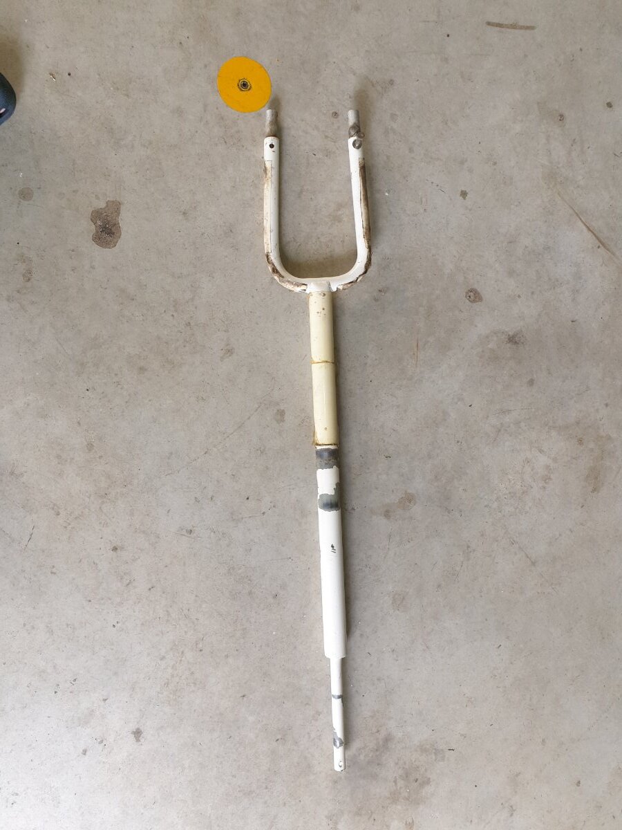

Blueadventures Posted February 4, 2022 Author Share Posted February 4, 2022 Nice, tail wind takeoff, you must be happy with the Nynja. I'm doing an engine service today and re grease etc the nose wheel leg while we have some poor weather. 1 Link to comment Share on other sites More sharing options...

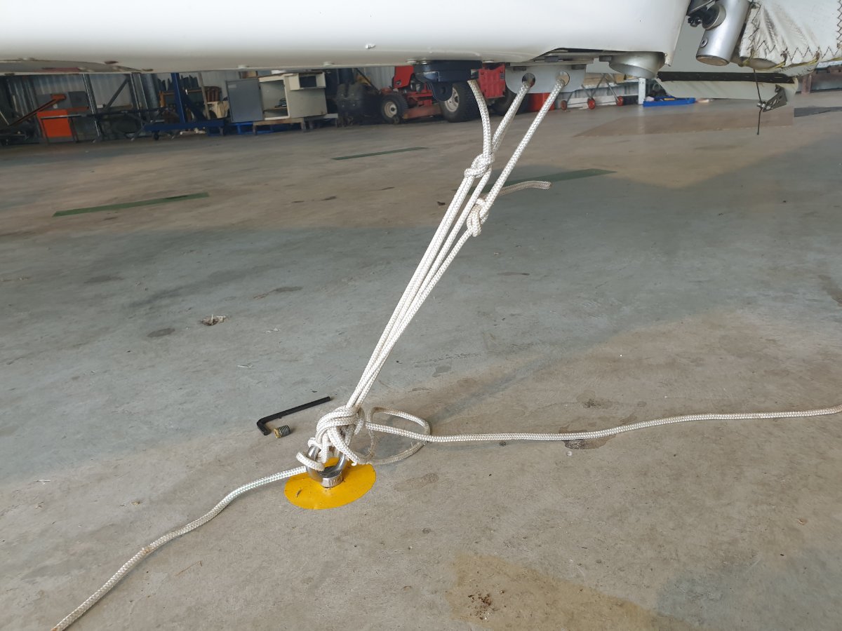

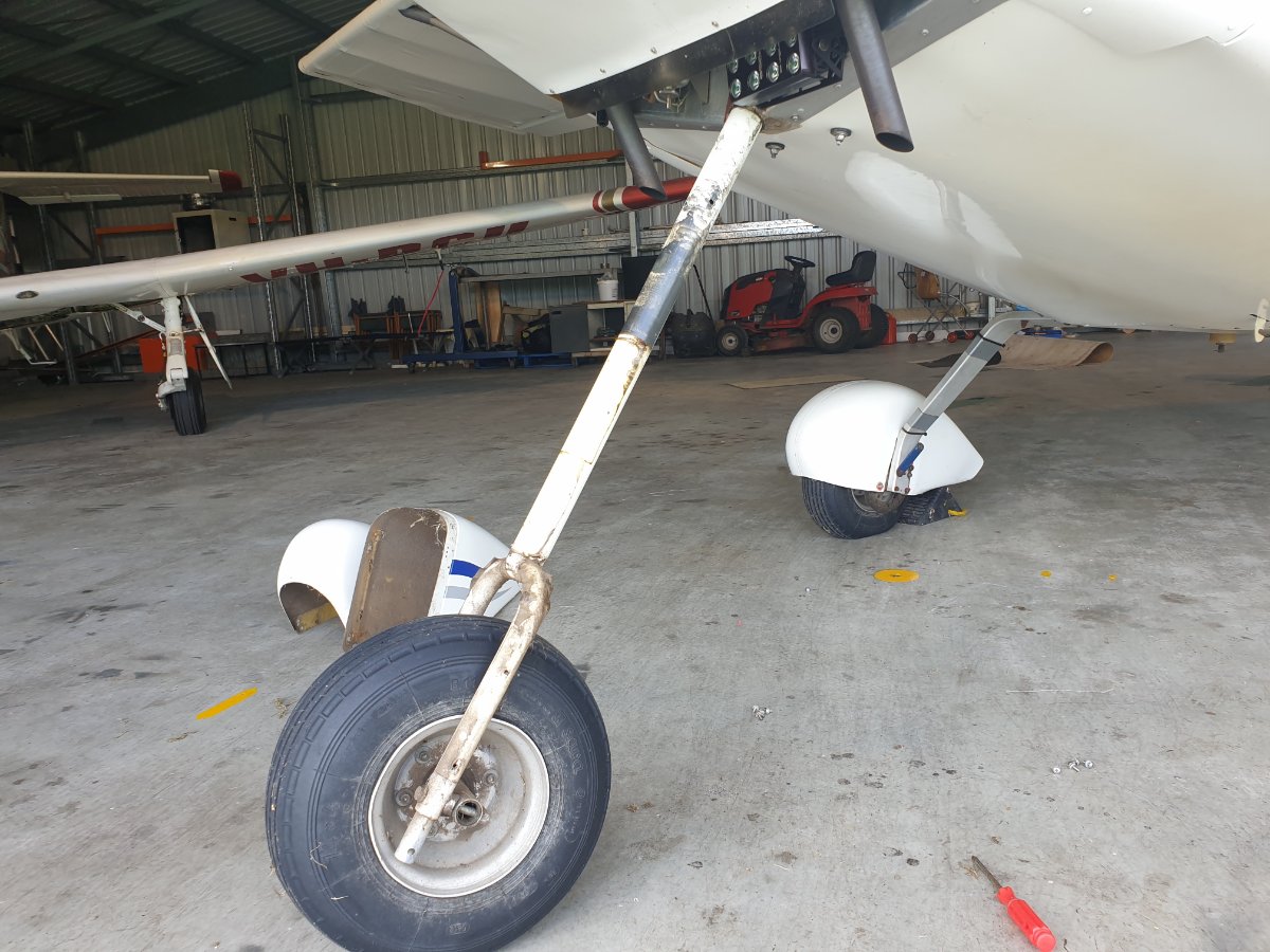

Yarraroo2 Posted February 6, 2022 Share Posted February 6, 2022 What is your procedure Mike. I thought it looks quite complicated. I thought I would like to check mine out sometime. Link to comment Share on other sites More sharing options...

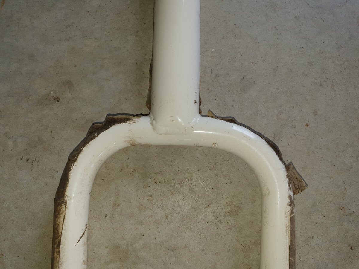

Blueadventures Posted February 6, 2022 Author Share Posted February 6, 2022 (edited) 44 minutes ago, Yarraroo2 said: What is your procedure Mike. I thought it looks quite complicated. I thought I would like to check mine out sometime. I tie the tail down (almost to the floor) [I double up on the rope tying down the tail], take out the top bolt in the fork above the rubber damper donuts; you need to remove the rudder bolt through the fork tube. Before lifting; I back off the axle bolts so I can remove the wheel. Clean the fork with petrol and detergent to check for any cracks; all perfect. Then grease with lithium grease and put back in. I have drop ins in the concrete floor that I screw in an eyebolt. I have thick prop tape on the side of the fork to protect the paint from the spats. I also fitted a new front tyre and tube the Mitas L66 from Wagga Bike and Tyres; I have new ones for the mains to do one day also. Some mates called in as I was finishing the Nose leg and I put on a cuppa. When all finished we had a beer. The Oil change will be done tomorrow. Cheers Mike Edited February 6, 2022 by Blueadventures 1 1 Link to comment Share on other sites More sharing options...
Yarraroo2 Posted February 6, 2022 Share Posted February 6, 2022 Thanks Mike. Very thorough as usual. Cheers Nigel 1 Link to comment Share on other sites More sharing options...

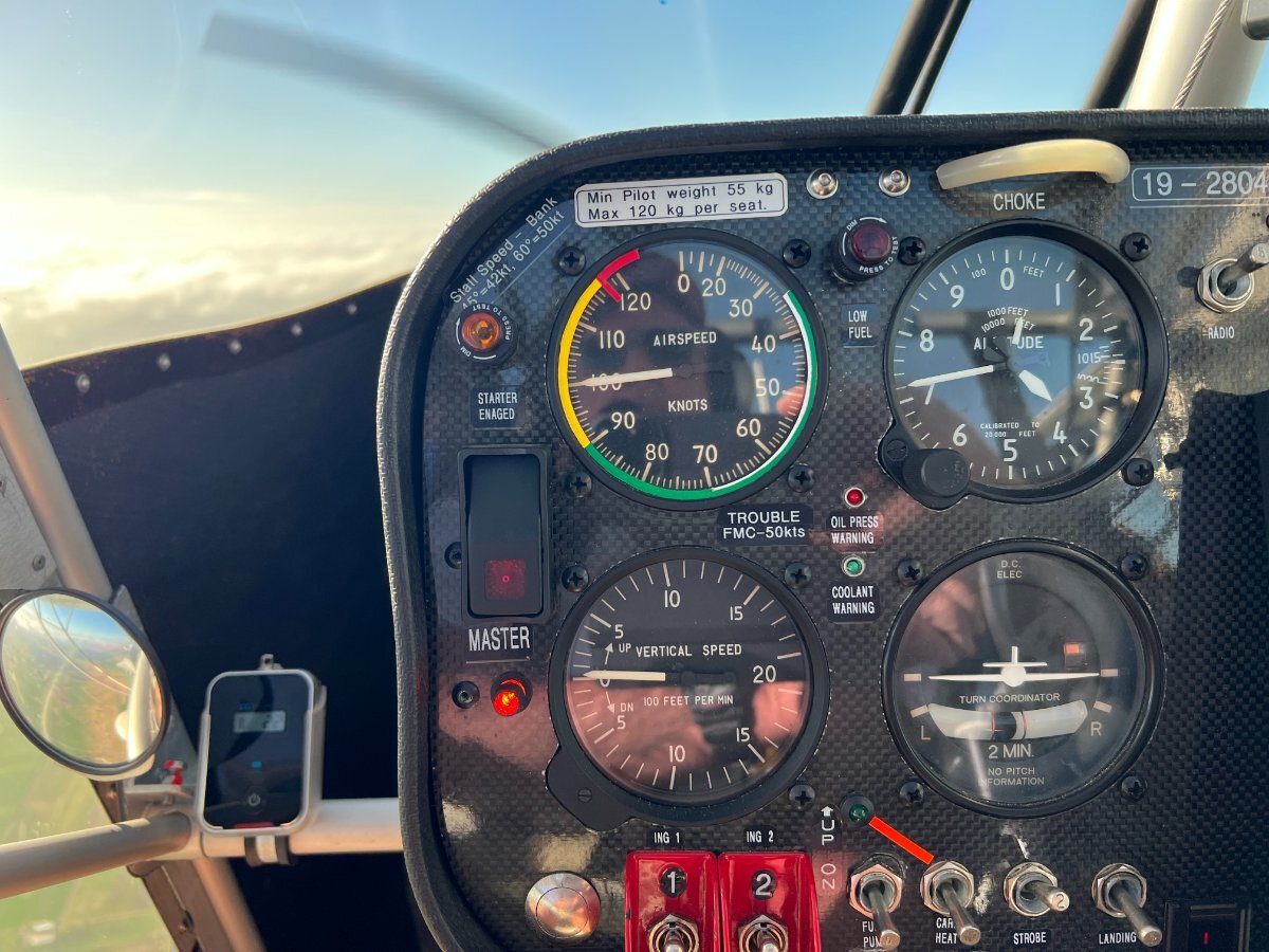

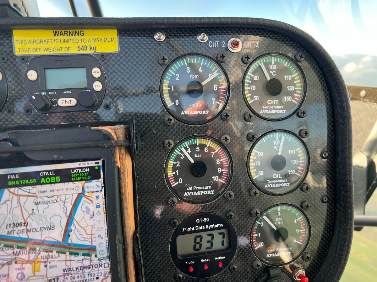

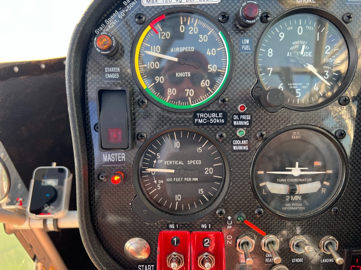

Blueadventures Posted May 2, 2022 Author Share Posted May 2, 2022 (edited) Did another hour today in the Nynja; 2nd session and third flight with the newly fitted E-Prop. Pitched decreased to 24.5* from 25*. Turbulent air so had to get above 3,500ft for smooth air. Happy with results. WOT s&l 5,450rpm 108Kts. 4,000rpm - 75kts, 4,200rpm - 80kts, 4,400rpm 85kts, 4,800rpm - 90kts, 5,100 - 100kts, I'll look at 4,800 to 5,000rpm for cruise of 90 to 95kts. Have a two hour trip end of month to Old Station so will start seeing the actual performance including fuel usage etc and do a few local trips before hand. Trim seems good at 95 kts will know more after some long trips. Hoping to pick up 1 maybe 2 litres per hour better economy on long trips. Edited May 2, 2022 by Blueadventures arrange images 2 2 Link to comment Share on other sites More sharing options...
