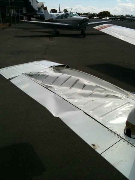

GraemeK Posted November 15, 2010 Share Posted November 15, 2010 I think its the aussie way, to laugh in the face of danger. But ... Apologies if anyone was offended by my flippant remarks a few posts back. But you've got to be very happy indeed that Darky and her instructor were able to safely bring the plane back despite the significant damage to the tailplane - as others have pointed out, it could have been a very nasty outcome. It got me thinking about how a composite airframe would have fared - Jabiru f'rinstance. The metal tailplane in this case has been able to absorb a substantial amount of kinetic energy by progressively deforming - in a composite however, you would get some very large torsional and compressive/tension forces which could possibly lead to structural failure. Maybe also a case for the all flying tail - I'd imagine a conventional tailplane/elevator setup might have resulted in the elevator jamming in this situation. Also a testament to the Warrior - looking at Darky's pics and those of the BZA/UMB midair shows they can remain flyable in the face of significant damage. Link to comment Share on other sites More sharing options...
facthunter Posted November 15, 2010 Share Posted November 15, 2010 Full flying tail. I'm not a fan of the full flying tail. Neither is Bill Whitney (unless he has changed his mind). Has to be set up very carefully, or it is a hazard. It is aerodynamically efficient, and that is why it is used. A common feature of the Piper aircraft family. I don't think that absorbing birdstrikes is what it would be good at, but it did this time. If you suspect that you have airframe damage and possible control difficulties you have to consider a lot of FACTORS. Is the airframe weakened.? Slow down and avoid abrupt control inputs. this brings another problem . Will the plane behave badly at low speed. Will flap extension cause more control difficulties? can or should the load be moved around to help. Landing at the nearest suitable field is the deal also. Nev Link to comment Share on other sites More sharing options...
