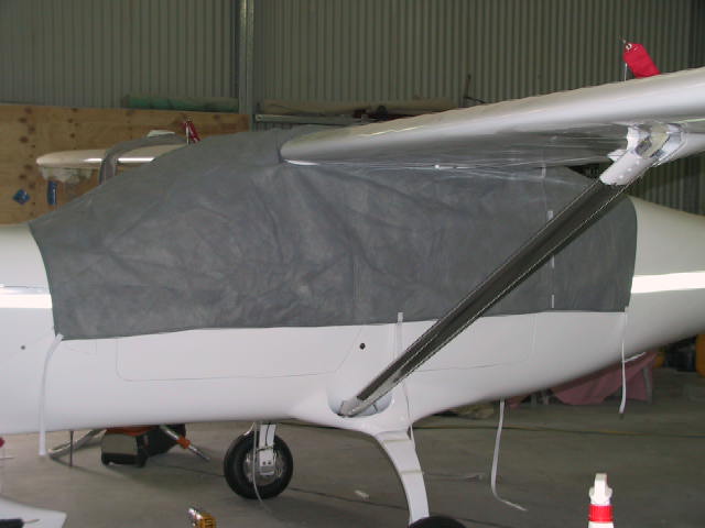

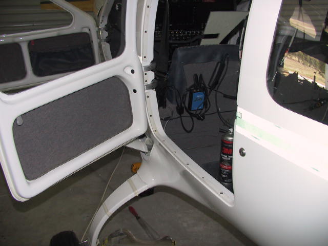

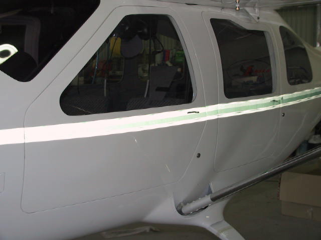

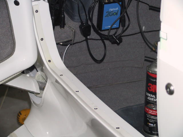

Captain Posted January 25, 2008 Author Share Posted January 25, 2008 Cover & Doors Have been tied up on business so the build has slid a little, but have been back on it for the last week. The cover is just about complete. [ATTACH]4765.vB[/ATTACH] [ATTACH]4766.vB[/ATTACH] [ATTACH]4767.vB[/ATTACH] Have been concentrating on installing the door jams and finalising the door fit and sealing. I opted to do it last after doors all painted and door seals were stuck on the doors. Probably the wrong move as the jams needed to be heated and bent and twisted to suit the door position. [ATTACH]4768.vB[/ATTACH] [ATTACH]4769.vB[/ATTACH] [ATTACH]4770.vB[/ATTACH] [ATTACH]4771.vB[/ATTACH] It has taken about 1.5 days per door. I did the rear then the passenger then my door in the hope that I would have the procedure refined before I got to the pilot's door. Sod's law applies and mine is the only one where I am not entirely happy with the fit. Wouldn't you know it. [ATTACH]4772.vB[/ATTACH] [ATTACH]4773.vB[/ATTACH] Wings are about to come off for some final work, then another full engine and mechanical run/check .......... then onto a truck for the trip to the airport for inspection etc. Regards Geoff Link to comment Share on other sites More sharing options...

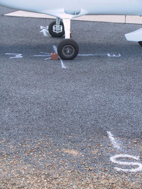

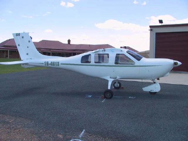

Captain Posted February 7, 2008 Author Share Posted February 7, 2008 The Little Things G'day All, In addition to a heap of small completion and finishing off jobs [ATTACH]4937.vB[/ATTACH], [ATTACH]4938.vB[/ATTACH] I have now studied [ATTACH]4940.vB[/ATTACH] and today completed the calibration and swinging of the Dynon magnetic heading as part of the final EFIS calibration. Also modified the electronic compass module (snip/snip) as per Dynon's service bulletin. Involved magnetic inclination, magnetic intensity input then swinging the aircraft and punching buttons. The results look good. [ATTACH]4932.vB[/ATTACH] [ATTACH]4933.vB[/ATTACH] [ATTACH]4936.vB[/ATTACH] It may not be an airport compass rose ........... but it's MY compass rose. [ATTACH]4934.vB[/ATTACH] [ATTACH]4935.vB[/ATTACH] Also adjusted the magnetic compass to as good a compromise as possible. Then did an engine run to check everything out and it started fine and all looks hunky dory. Had to then do about 12 engine starts to get final adjustment of throttle stops for 800 rpm. Am also part sponsoring a young bloke in the Aussie Junior road race championships this year, so have been wasting a bit of time getting his bike done too. [ATTACH]4939.vB[/ATTACH] All great fun. Regards Geoff Link to comment Share on other sites More sharing options...
Guest pelorus32 Posted February 7, 2008 Share Posted February 7, 2008 Hey Geoff, looking good. Just an off-the-wall thought: how much ferrous metal is in the wings? Particularly in the way of control linkages or anything long? I suspect it's mostly aluminium and composite. However if you swing the compass with the wings off and there is any long ferrous rod in the wings the compass may be off with the wings on. Regards Mike Link to comment Share on other sites More sharing options...
Captain Posted February 7, 2008 Author Share Posted February 7, 2008 Thanks for that Mike. You are right, as there is one SS control cable in each wing which come into the fuselage to the seat backs. I will swing them again after final assembly as the electronic compass box is on the floor behind the passenger's seat and it will need a final check with all of the electrical circuits in operation .... including strobes etc, as a few run down the centre of the fuselage in the floor. Same with the magnetic compass with the panel alive and the radio & transponder on (which are the closest electrical items). I suspect that the effects of those electrical currents might be greater than the SS cables. The last couple of days have been centred on getting everything about right and to check all circuits to save being too embarrassed during the inspection. Particularly the Dynon D10A after modifying it as per their service letter. Regards & thanks again for your input. Geoff Link to comment Share on other sites More sharing options...

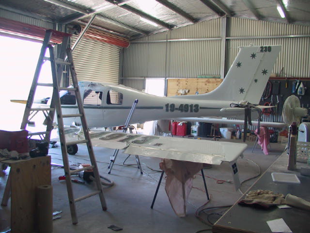

Captain Posted February 16, 2008 Author Share Posted February 16, 2008 Getting ready Preparations & double checking are ongoing all this weekend for trip to the airport on Monday for final assembly and inspection .......... hopefully the aircraft's last road trip. [ATTACH]5009.vB[/ATTACH] [ATTACH]5010.vB[/ATTACH] [ATTACH]5011.vB[/ATTACH] [ATTACH]5012.vB[/ATTACH] Link to comment Share on other sites More sharing options...

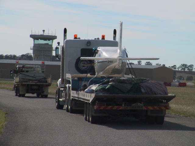

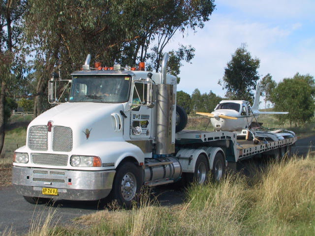

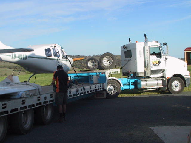

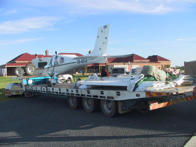

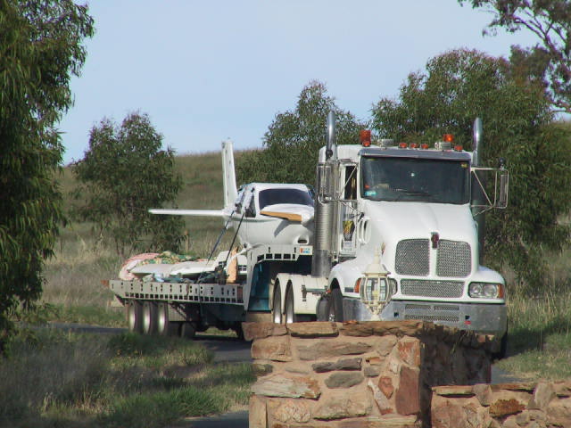

Captain Posted February 18, 2008 Author Share Posted February 18, 2008 Off to the Airport Well ............ a big day after 21 months. Geeeeezz these 230's must be heavy. Have a look at that loader. [ATTACH]5017.vB[/ATTACH] [ATTACH]5018.vB[/ATTACH] [ATTACH]5019.vB[/ATTACH] [ATTACH]5020.vB[/ATTACH] [ATTACH]5021.vB[/ATTACH] [ATTACH]5022.vB[/ATTACH] [ATTACH]5024.vB[/ATTACH] [ATTACH]5025.vB[/ATTACH] [ATTACH]5026.vB[/ATTACH] Actually I booked it for the tilt tray as this one goes down to 6 degrees and you always drag the **** of the 230 when loading it onto a normal car trailer (unless you use a break-type trailer). Now for you budding builders, let me tell you that it is a good test of a marriage when you raid the beds to drag off doonas [ATTACH]5023.vB[/ATTACH] to pack around your wings on the back of a low loader. I'll let you know whether mine survives. Arriving at YSWG with an escort. [ATTACH]5027.vB[/ATTACH] (and thank goodness the doonas are still there). [ATTACH]5028.vB[/ATTACH] [ATTACH]5029.vB[/ATTACH] [ATTACH]5030.vB[/ATTACH] Link to comment Share on other sites More sharing options...
