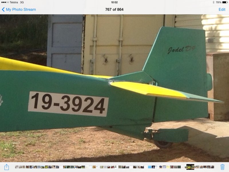

Old Koreelah Posted October 29, 2013 Posted October 29, 2013 Interesting discussion, Dafydd. My little Jodel has a small rudder, set behind the tailplane. Hopefully, in a spin it should meet plenty of clear air. What do you think?
facthunter Posted October 29, 2013 Posted October 29, 2013 I'll stick my neck out and say it is a lot better than most. The part below the elevators is large enough to be effective and the small fin before the rudder energises the flow around the rudder above. Don't use my statement to encourage you to try it, but I'm fairly confident of most French designs of that period. Nev

Dafydd Llewellyn Posted October 30, 2013 Posted October 30, 2013 Quote I'll stick my neck out and say it is a lot better than most. The part below the elevators is large enough to be effective and the small fin before the rudder energises the flow around the rudder above. Don't use my statement to encourage you to try it, but I'm fairly confident of most French designs of that period. Nev I'd agree; the un-blanketted rudder area below the tailplane is most important. The Jodel is well-endowed in this regard. I suggest you download NASA TN-D-6575; however quite a few French aeroplanes of that era needed anti-spin strakes as well, so I suggest you study the matter carefully before trying it. When one is test flying an aircraft for spin recovery, no sane test pilot will fly without a spin recovery parachute installation; see the Flight Test Society of Australia Symposium papers for 12 March 2009 (I do not know whether this is available from the internet).

Old Koreelah Posted October 30, 2013 Posted October 30, 2013 Quote I'd agree; the un-blanketted rudder area below the tailplane is most important. The Jodel is well-endowed in this regard. I suggest you download NASA TN-D-6575; however quite a few French aeroplanes of that era needed anti-spin strakes as well, so I suggest you study the matter carefully before trying it. When one is test flying an aircraft for spin recovery, no sane test pilot will fly without a spin recovery parachute installation; see the Flight Test Society of Australia Symposium papers for 12 March 2009 (I do not know whether this is available from the internet). Thanks for the feedback, fellas. I don't plan on doing any spins, but it's nice to know I seem to have a safe design.
