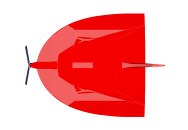

rotax618 Posted September 25, 2014 Share Posted September 25, 2014 The aspect ratio of a circular wing is 1.27, it has been found from experimentation that wings with aspect ratios from about 1.2 - 1.4 behave like wings with aspect ratios of approx 5. Provided that the relationship between CG is kept in the 25% range Circular wings haven been found to be very stable and have some unique low speed characteristics, it is no accident that Davids UFO flies very well, is stable and controllable. Link to comment Share on other sites More sharing options...

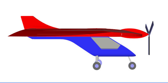

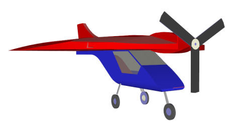

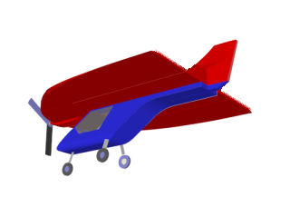

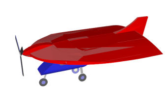

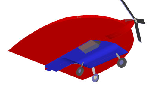

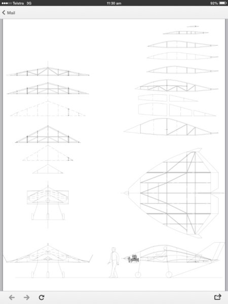

bexrbetter Posted September 26, 2014 Share Posted September 26, 2014 I have found using models that an inverse zimmerman planform has a better L/D than a circle.[ATTACH]28977[/ATTACH] I decided last night to have a quick look at your drawings in 3D, I stuffed up the way I did the wing but at least gives you an idea of your design. There is no ailerons - the basic only took a half hour or so, I love Sketchup. Link to comment Share on other sites More sharing options...
SDQDI Posted September 26, 2014 Share Posted September 26, 2014 I decided last night to have a quick look at your drawings in 3D, I stuffed up the way I did the wing but at least gives you an idea of your design. There is no ailerons - the basic only took a half hour or so, I love Sketchup.[ATTACH=full]32145[/ATTACH] [ATTACH=full]32146[/ATTACH] [ATTACH=full]32147[/ATTACH] [ATTACH=full]32148[/ATTACH] [ATTACH=full]32149[/ATTACH] [ATTACH=full]32150[/ATTACH] We could call it the 'Akubra' would suit it to a t Link to comment Share on other sites More sharing options...
