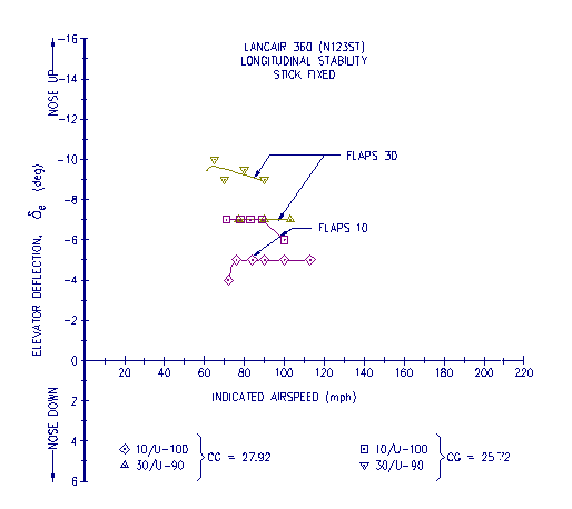

Just happened to come across a copy of the mag so read the whole article.
As he is a Professor and stated: "Explain the movement of the centre of pressure ...." (same statement in the referenced CASA Flight Instructor Manual). I'd like to hear that explanation and see the the source of the data.
Whenever I get to hear such an explanation by a trainee instructor I often produce some data to discuss. Which aerofoil? Leading edge or trailing edge stall? Two dimensional or a real wing? Tapered, swept, washout? What's the stall pattern?
CASA adds the important statement: "Ensure that the student is aware of ... stall behavior of aeroplane at the stall ..." Its good for the instructor to explain the reasons for such behaviour.
The article goes on to state: "Further flight exercises ... in a take-off or landing configuration ... that the control column is always beyond the stick stall position."
Is our local Professor still around?
