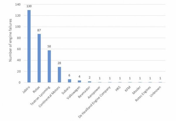

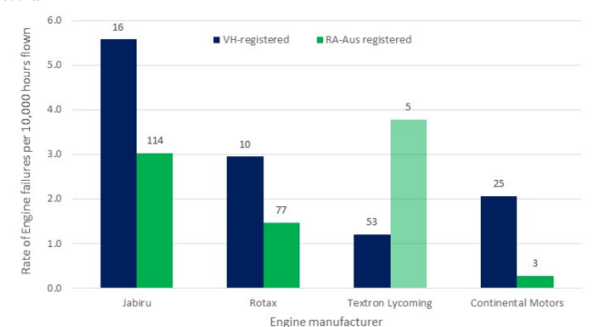

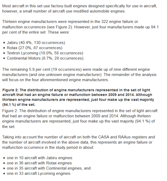

Oscar Posted March 17, 2016 Share Posted March 17, 2016 And that result for the Runcorn incident was known within what - a week or so? - of the incident. CASA had nearly five months to validate the inclusion of that incident as an engine 'failure or malfunction' before it presented its 'facts' to validate the Instrument. Is it any wonder that RAA publicly stated that CASA had not done analysis of the information? For how many of the other 'cases' in the CASA spreadsheet, had inadequate research been done on the actual cause of the result? For those who infest this site with a 'guilty unless proven innocent' approach to Jabiru engines, nothing will suffice and they can be safely ignored. However, CASA (and ATSB) are fundamentally required to be professional, dispassionate and expert in their analysis of facts leading to actions - and increasingly, evidence is coming forward that CASA at least was anything BUT professional, dispassionate and expert. Just as CASA did until whipped into a corner through an FOI demand, ATSB has not released the actual raw data for inspection. A Senate Inquiry into all of this may well prove extremely fertile ground for a flogging of CASA and possibly, more than a glancing blow for the ATSB. If we don't have a sudden DD thrust upon us, Australian aviation might well be the benefactor of a flame-thrower applied to the genitalia of both organisations... 1 Link to comment Share on other sites More sharing options...

Bruce Tuncks Posted March 18, 2016 Share Posted March 18, 2016 Operating Jabirus out of Gawler for training and hire, over ten years there have been some engine-out incidents, all of which were landed without much harm, after all the Jabiru was just turned into a glider . Most of the time however the engines make overhaul time without problems. The majority of the incidents were not caused by faults inherent in the engine, and if the same proportion were of this type in the ATSB report, (and 01rmb indicates this to be so for the samples he knows) then the report is unfair and biased. There are several Rotax engines based at Gawler, but these do not do anything like the same training work or the same hours. Of course they have fewer faults. Personally, I would like to try a turbo 914 in a glider tug, but our tugmaster says that sometimes the 260 horsepower Lycomings are only just powerful enough on a hot day with a heavy 2 seater. I think if a Rotax was used for towing all the time it would have more problems than just sitting in a hangar. Gosh with an insight like that I should be on the ATSB. 1 Link to comment Share on other sites More sharing options...
