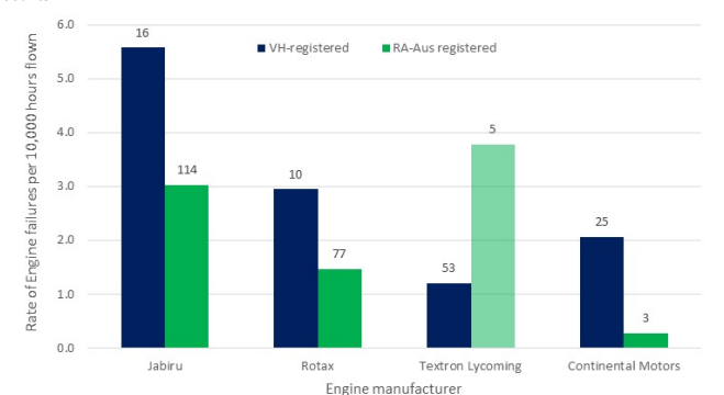

Kyle Communications Posted March 9, 2016 Share Posted March 9, 2016 Ouch that is pretty convincing evidence almost 4 to 1 Link to comment Share on other sites More sharing options...
Bats Posted March 9, 2016 Share Posted March 9, 2016 Well I guess you poke the bear for long enough and it will eventually retaliate. Everyone from parliamentarians to forum members had been putting the boot into CASA and by extension the ATSB for supposedly getting it so wrong about the Jabiru failure rate; it seems that there is your reply. The usual apologists will no doubt be getting ready to rubbish the report and anyone who dares to comment contrary to their belief system, so I don't expect that there will be an end to hostilities any time soon. 1 2 Link to comment Share on other sites More sharing options...

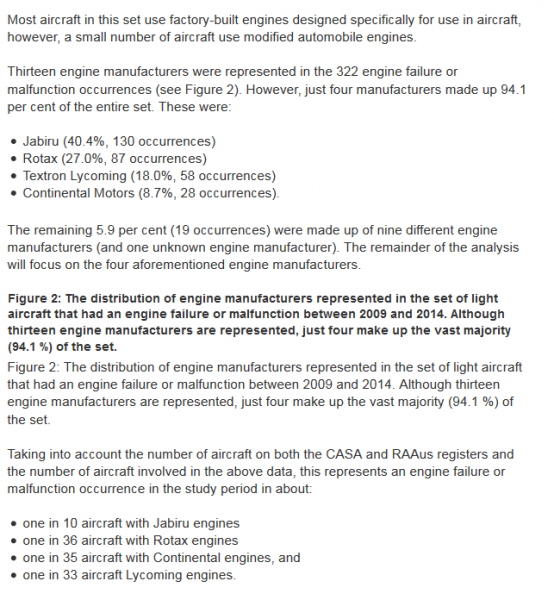

SSCBD Posted March 9, 2016 Share Posted March 9, 2016 My simple question is with the Rotax numbers "ONE FAILURE in 36" - is the majority of these due to high engine revs compared to GA engines? What is the major failure of Rotax? Link to comment Share on other sites More sharing options...
Bats Posted March 9, 2016 Share Posted March 9, 2016 I suspect that the 1 in 36 includes Rotax 2 strokes, which are anecdotally more prone to failure than the 91- series. I don't know of a common theme with the 4 stroke Rotax failures, my quick and unscientific snap survey turned up things like lifters, fuel pump and a carbie mounting. Other than modified (turbo etc) versions, hard work and high revs don't seem to be implicated, but I'm happy to be corrected. Link to comment Share on other sites More sharing options...
Nobody Posted March 9, 2016 Share Posted March 9, 2016 I suspect that the 1 in 36 includes Rotax 2 strokes, which are anecdotally more prone to failure than the 91- series. I don't know of a common theme with the 4 stroke Rotax failures, my quick and unscientific snap survey turned up things like lifters, fuel pump and a carbie mounting. Other than modified (turbo etc) versions, hard work and high revs don't seem to be implicated, but I'm happy to be corrected. The report isnt catergorical but it appears to include Rotax 2 strokes, see the bottom of page 5. Have a look at figure 10 in the report. It gives a breakdown of the failures by type of failure and engine. The only areas in that table where the Jabiru performs better than the Rotax as in "Corrosion" and "Other Technical Failure mechanism". The other interesting graph is figure 5. It shows that RAAus is much safer than VH registered across both Rotax and Jabiru. Real trend or lack or reporting???? GIGO???? (Garbage in Garbage out) 1 Link to comment Share on other sites More sharing options...
kasper Posted March 9, 2016 Share Posted March 9, 2016 The report isnt catergorical but it appears to include Rotax 2 strokes, see the bottom of page 5.Have a look at figure 10 in the report. It gives a breakdown of the failures by type of failure and engine. The only areas in that table where the Jabiru performs better than the Rotax as in "Corrosion" and "Other Technical Failure mechanism". The other interesting graph is figure 5. It shows that RAAus is much safer than VH registered across both Rotax and Jabiru. Real trend or lack or reporting???? GIGO???? (Garbage in Garbage out) or is it that GA fleet sit on the ground a lot more than RAA ... leave it unused and it goes bang more quickly? And given the two significant areas of mechanical failure/discontinuity are through bolts and valves - bolts are a design/scheduled replacement issue while valves is an on test ... even reading this report with a size 9 steel cap on with intent to kick the $hit out of Jabiru why did not the regulator look at mandating changes to life on components known to be at risk as the hours accrue in stead of the instrument they put in place??? It really does appear that the core issues where known and if you could remove the failures of these two areas (or even halve them) the engines are then no worse than the comparative rotax 912s ... at half the price 1 Link to comment Share on other sites More sharing options...

Fishla Posted March 9, 2016 Share Posted March 9, 2016 Lumps malfunctions and failures together. Doesn't explain why. Doesn't break them down. Explains that there are high, medium and low risk malfunctions. Doesn't explain how many of each engine type are which. The 18 examples of high risk mention Jabiru twice only and I am left to assume the other 16 are non-jabiru. Says can't explain causes for malfunction for 25% of Jabiru incidents but rotax that is 51% and average is 44% (in other words more thorough reporting of Jabiru which doesn't necessarily mean more problems). Puts much blame on though bolts which I thought have been fixed? As someone who has now risked their life for about 40 hours in a Jabiru I'll continue to believe the biggest risk to me is not being fit and well and underestimating the weather. The stats don't add up to me when I read in Sport Pilot that it's more likely a Tecnam will kill me than a Jab. Link to comment Share on other sites More sharing options...
