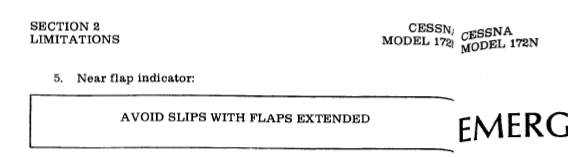

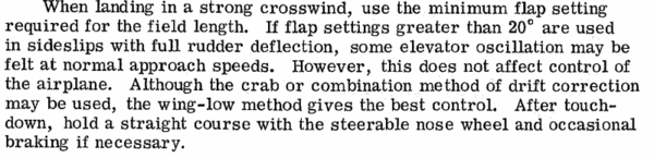

aro Posted October 11, 2016 Share Posted October 11, 2016 Bill Thompson who was the Manager of Flight Tests and Aerodynamics at Cessna stated in his 1991 book: You missed the continuation: When the larger dorsal fin was adopted in the 1972 C-172L, this sideslip pitch phenomenon was eliminated, but the cautionary placard was retained. Your quote only applies to pre-1972 aircraft. Even then, given a choice of a possible uncomfortable pitch down and bending the airframe I would risk a slip. All I know from experience under instruction is that side slipping a 150 or 172 with 40 down is a waste of time and diving is more effective. Weight makes a big difference in that type of maneuver. I suspect it wouldn't be at all difficult to exceed flap limits in a later model 172 with only 30 degree flaps when fully loaded. There are also many aircraft with low flap limits so it's not a good habit to teach without some consideration for the specific model. Link to comment Share on other sites More sharing options...

David Isaac Posted October 11, 2016 Share Posted October 11, 2016 Your quote only applies to pre-1972 aircraft. Even then, given a choice of a possible uncomfortable pitch down and bending the airframe I would risk a slip. Where is the risk? But you are wasting your time if you have 40 of flap to use, just dive the bastard, easy to do without exceeding white arc. Weight makes a big difference in that type of maneuver. I suspect it wouldn't be at all difficult to exceed flap limits in a later model 172 with only 30 degree flaps when fully loaded. There are also many aircraft with low flap limits so it's not a good habit to teach without some consideration for the specific model. Sure but a 30 degree 172 might just slip, but I haven't tried it and white arc speed rules apply no matter how you fly. The Auster has a 56 KIAS flap limit speed, gotta be careful with those old girls, but they slip beautifully anyway without flaps. After all they are just a bigger faster Cub. Link to comment Share on other sites More sharing options...

dutchroll Posted October 11, 2016 Share Posted October 11, 2016 Your quote only applies to pre-1972 aircraft. Even then, given a choice of a possible uncomfortable pitch down and bending the airframe I would risk a slip. Except in an emergency situation, in which case all bets are off and you do whatever is necessary, under what circumstances would you have a choice between "bending the airframe" and sideslipping it in? 1 Link to comment Share on other sites More sharing options...

aro Posted October 11, 2016 Share Posted October 11, 2016 Except in an emergency situation, in which case all bets are off and you do whatever is necessary, under what circumstances would you have a choice between "bending the airframe" and sideslipping it in? Why do you exclude an emergency situation? That's exactly the situation where it's most likely to happen. Any normal situation you would go around rather than slip or dive at the top of the white arc. If you have an engine failure & are high and fast with a limited landing area - that is when you will have to make the choice. Easy to say all bets are off and do whatever is necessary, but if you exceed Vfe and one flap pushrod gives up the ghost all bets really will be off. Better to sideslip and have elevator buffet or pitch instability than asymmetric flaps at 85+ knots is my theory. 1 Link to comment Share on other sites More sharing options...
