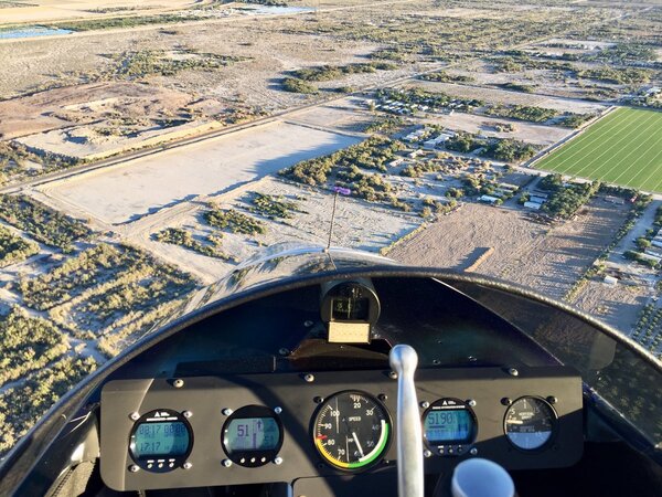

pilotgil Posted May 8, 2018 Author Share Posted May 8, 2018 My current Lockwood 582 Drifter. Link to comment Share on other sites More sharing options...
