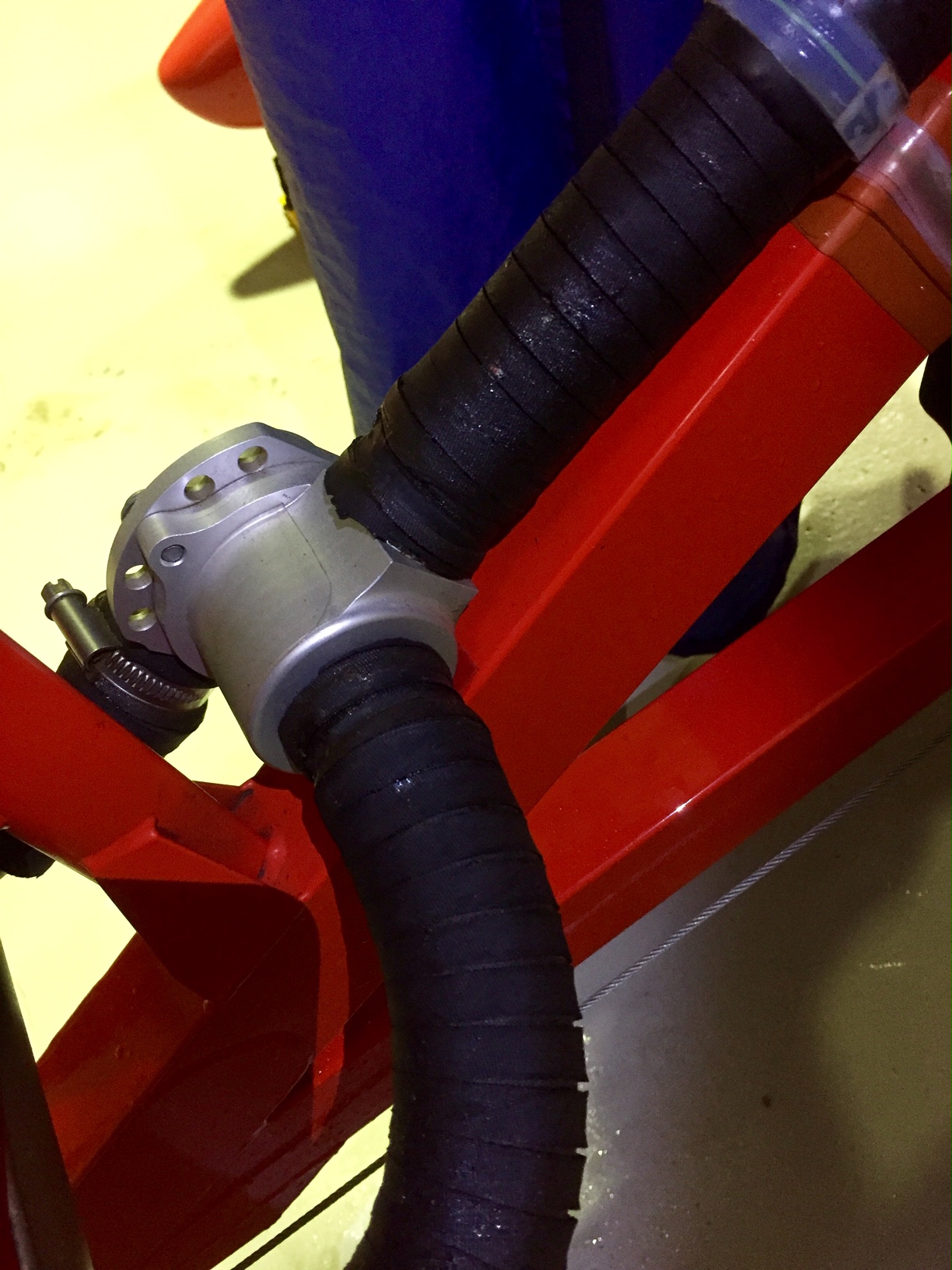

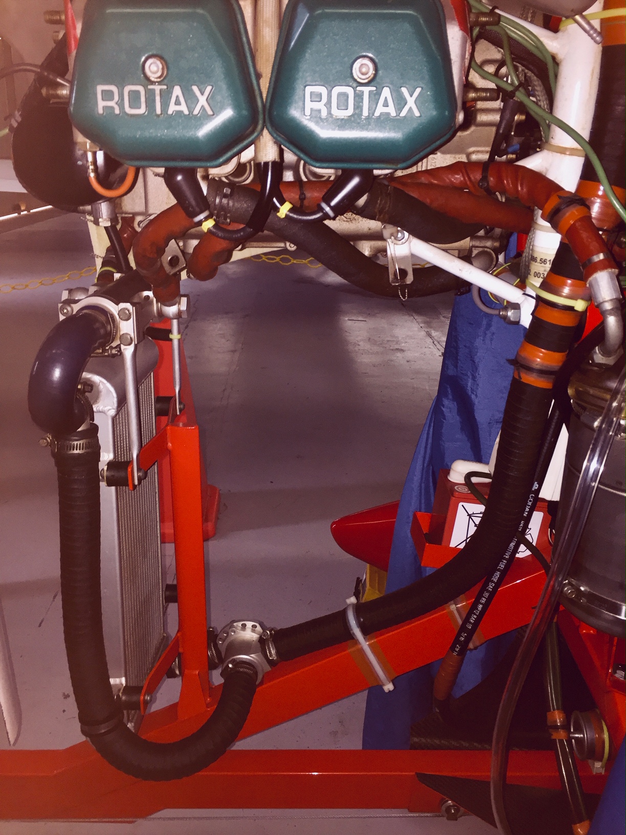

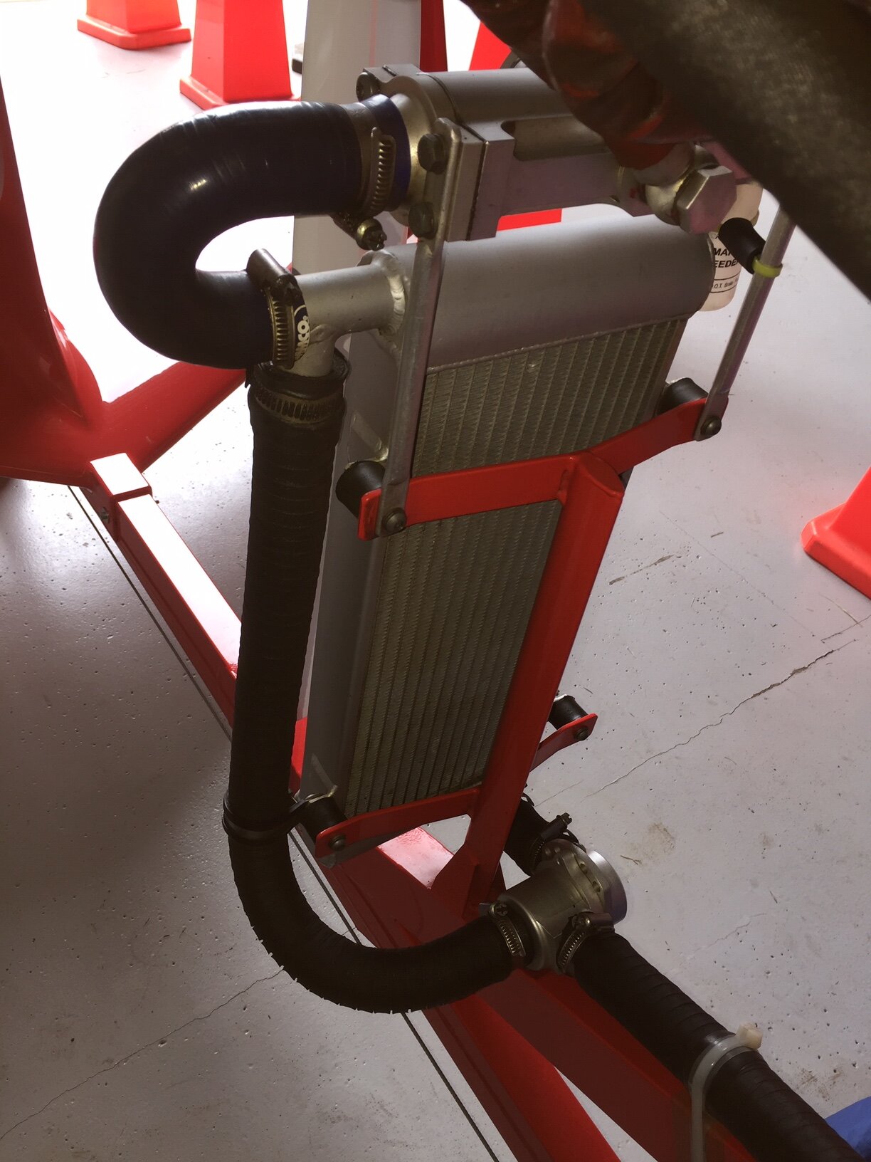

ozzietriker Posted May 27, 2020 Share Posted May 27, 2020 Hi all, I'm doing my 5 yearly Rotax rubber replacement and could anyone please tell me where can I get a replacement hose to this black ribbed style coolant hose? (pictures attached) it has an internal diameter of 1 inch and wall is 4mm wide. It looks like straight heater hose but it needs to handle 130' Celcius (unlike car radiator hoses which are only good for 80-90'C). I am thinking that silicone type hoses are the way to go due their high temperature tolerance and excellent ageing characteristics. Unfortunately I am unable to get this hose from Bert Floods as it is a non-Rotax part. The aircraft OEM can supply it to me from europe in 5 weeks which is not ideal either. I'd love to hear what someone out there may be using as an equivilent? Thanks in advance, Andrew Link to comment Share on other sites More sharing options...
