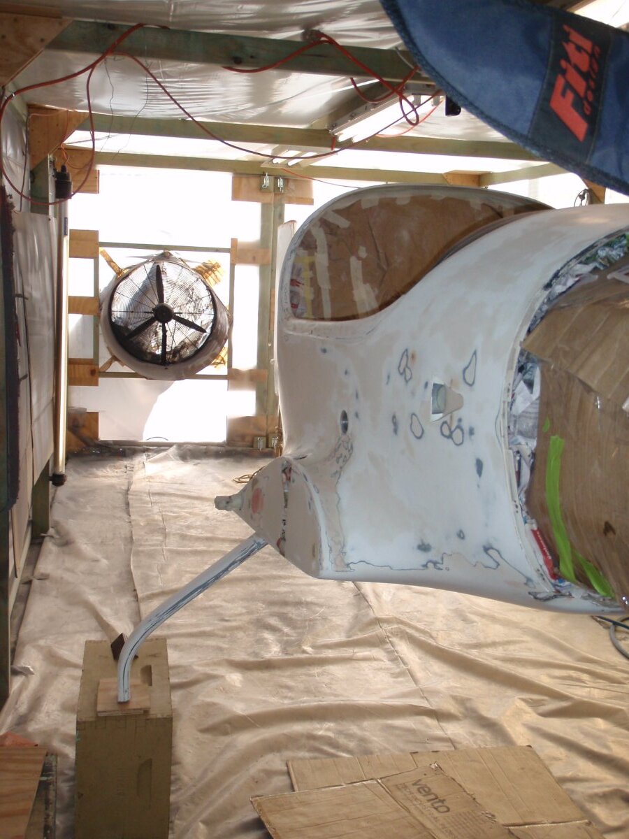

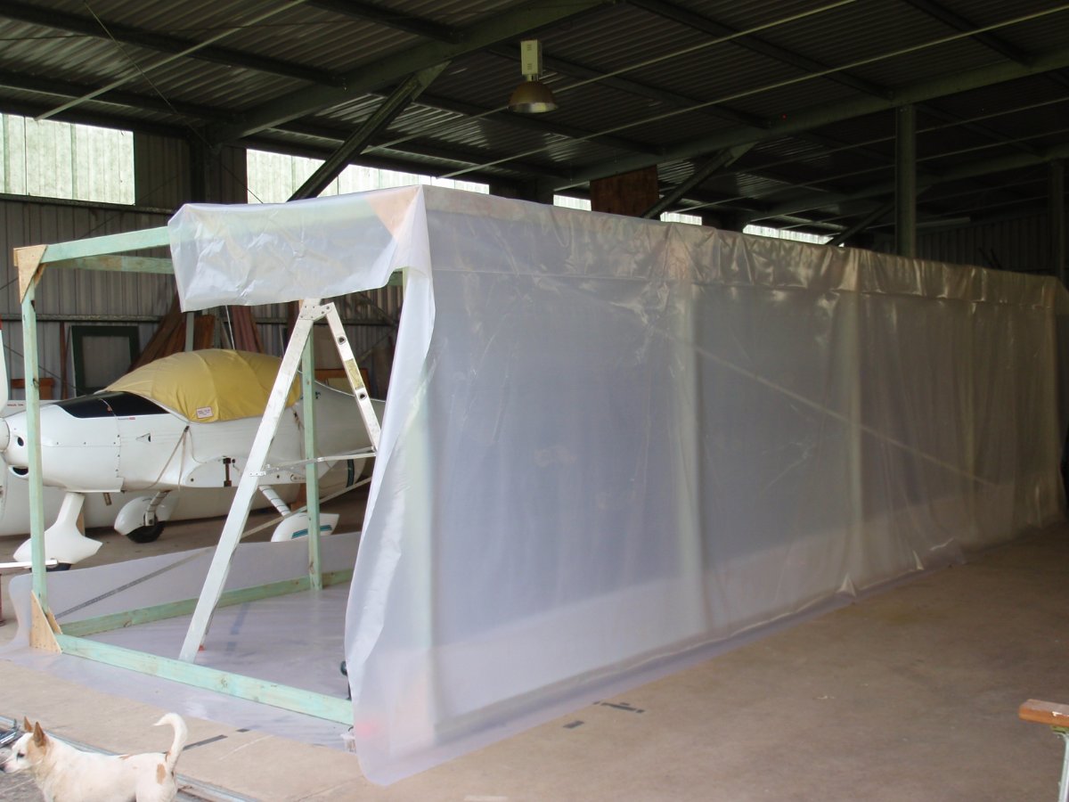

skippydiesel Posted January 2, 2021 Share Posted January 2, 2021 Tiger - Great photo of you & Light Wing - unfortunately that aircraft is no longer at The Oaks SS is sold in Australia by Sky Shop however when I did mine the AU$ was almost at parity with the US $ so I purchased direct from SS. Great savings & fast service. Yes the top coat is a two part mix, still water born & thinned - Its shelf life is more like 6 months than 3 hrs - you may be confusing the post mix to application time with shelf life. Take the SS recommendation and do not purchase the top coat until you are going to apply it. There is a strong temptation to purchase all the SS materials at once, to save on delivery cost, DONT DO IT! If your project time line is anything like mine, I grossly underestimated just how long it wold take to do a good job and came dangerously close to exceeding the shelf life of my top coat. When it comes to the top coat application, think about how you will maintain at/above the recommended curing temperature (21+C?) for 24 hrs - I used an old window rattler and cheap digital thermomotors to set & record temps just below the sprayed part(s) If you follow the instructions exactly the resulting finish will be spectacular Some better photos of spray/work booth - I feel it was critical to my good result. Note: Plastic (builders plastic) cover include floor, which was slightly flooded for top coat spraying Air conditioning material , blue panel, can be seen - this provided clean, dust /insect free air Double doors one end to facilitate large component entry/exit - cheap industrial pedestal fan went in right side (see inner frame) & used a home made stiff plastic duct & packing tape All wood re used for other home projects 2 Link to comment Share on other sites More sharing options...

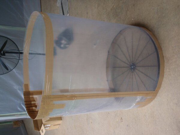

Tigershark21 Posted January 3, 2021 Author Share Posted January 3, 2021 Nice set up! Luckily, the Fisher 404 is tiny. I'll have to build an enclosure like yours. The dust here is terrible. I'll leave the top coat purchase til the end then! I do love painting. I do a lot of airbrushing using waterborne automotive paints by Createx colours usually from airbrusmegastore.com however they are not for aircraft and not sure of their UV rating if any. I really do like the IWATA air brushes. Did you use Superflite 101 Fabric with your plane or another fabric brand with Stewart chemicals? Adam. Link to comment Share on other sites More sharing options...

skippydiesel Posted January 3, 2021 Share Posted January 3, 2021 15 minutes ago, Tigershark21 said: Nice set up! Luckily, the Fisher 404 is tiny. I'll have to build an enclosure like yours. The dust here is terrible. I'll leave the top coat purchase til the end then! I do love painting. I do a lot of airbrushing using waterborne automotive paints by Createx colours usually from airbrusmegastore.com however they are not for aircraft and not sure of their UV rating if any. I really do like the IWATA air brushes. Did you use Superflite 101 Fabric with your plane or another fabric brand with Stewart chemicals? Adam. Can't remember what brand of fabric I used (would be in my records somewhere). If I remember correctly, SS offers 3 "weights" of fabric - I went with the middle one (whatever that was) as recommended by SS, based on the expected performance of the aircraft. The SS undercoat is an excellent UV protection not just for the fabric but also for my composite fuselage. The undercoat comes in a regular and a thick grade. You will use mostly the regular however the thick is good for "building up" so that you can sand back to a smooth surface . The SS adhesive is mind boggling effective however as with the painting preparation is everything. SS have quite a good colour range however as an ametaur, I stuck with one of the whites (Arctic?) and also used a matt black on the instrument panel. Refurbishment DONE! Gun modified with hydraulic fitting to facilitate painting under fuselage - I had no way of rotating the fuselage. Did come up with a rotating system for wings. Panel painted Panel in flight 1 Link to comment Share on other sites More sharing options...

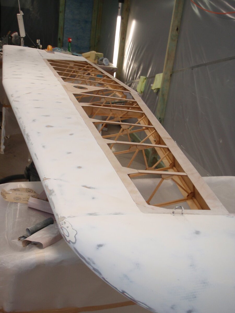

skippydiesel Posted February 5, 2021 Share Posted February 5, 2021 I briefly "looked" at Oratex - cant remember all the details but in the end it just did not suit my aircraft. The Zephyr wing has a ply wood skin from spare - around leading edge and back to spare, see photo of underside right wing. The fabric is glued, shrunk/tightened over the rear /trailing side top & bottom - Oratex, without painting to match plywood skin would look just weird and would defeat the benefit of the product - no need to paint.. Link to comment Share on other sites More sharing options...
