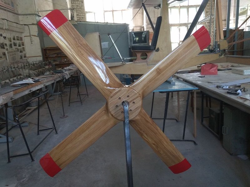

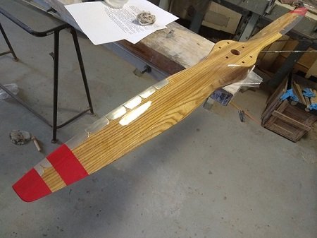

meglin Posted August 11, 2021 Share Posted August 11, 2021 A great decorative propeller! working with solid wood is a little more difficult. We use only epoxy glue. Additionally, we paste over fiberglass and glue the steel protection. A lot depends on the correctness of the design and the hands of the master. 3 Link to comment Share on other sites More sharing options...
