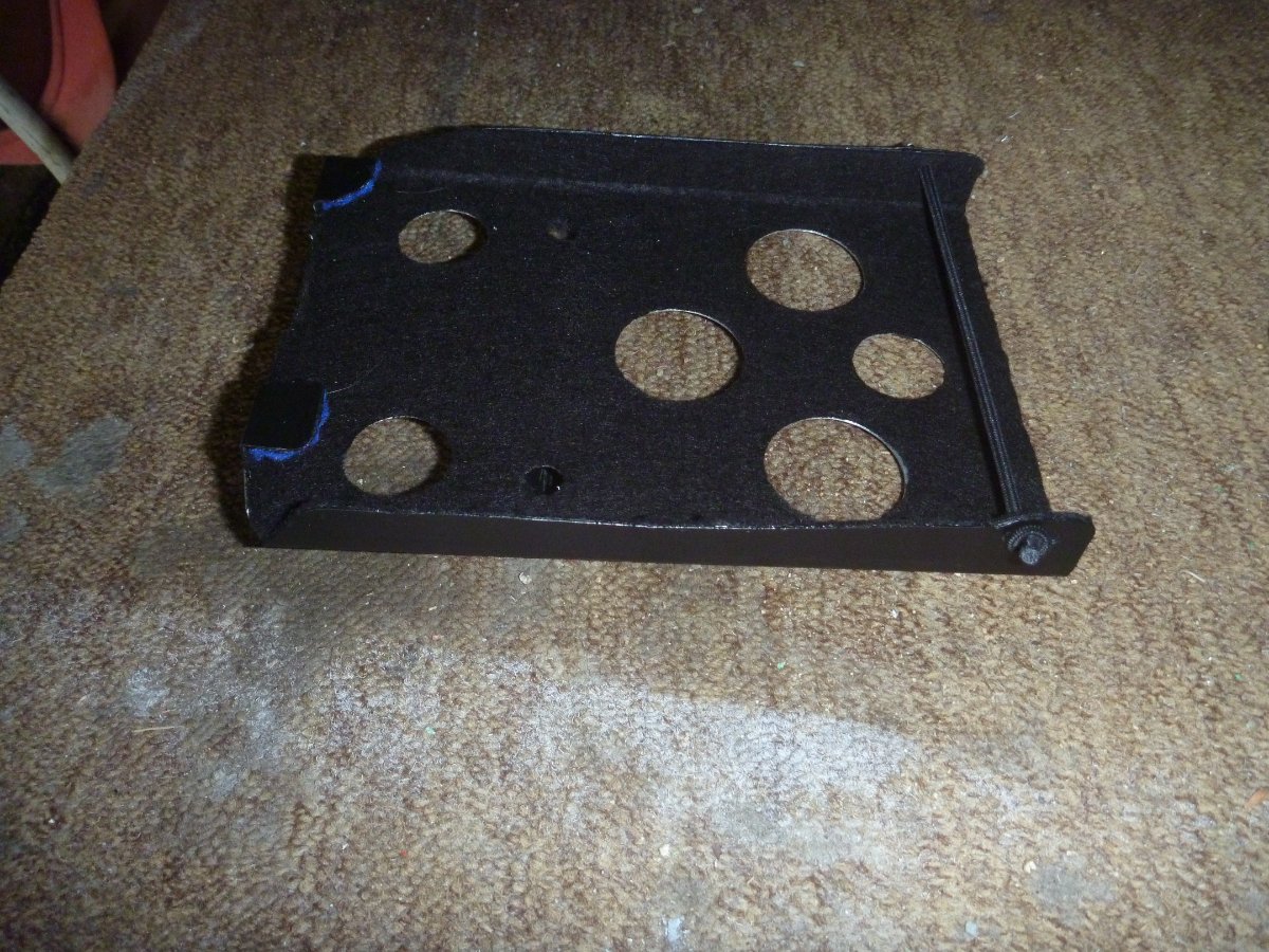

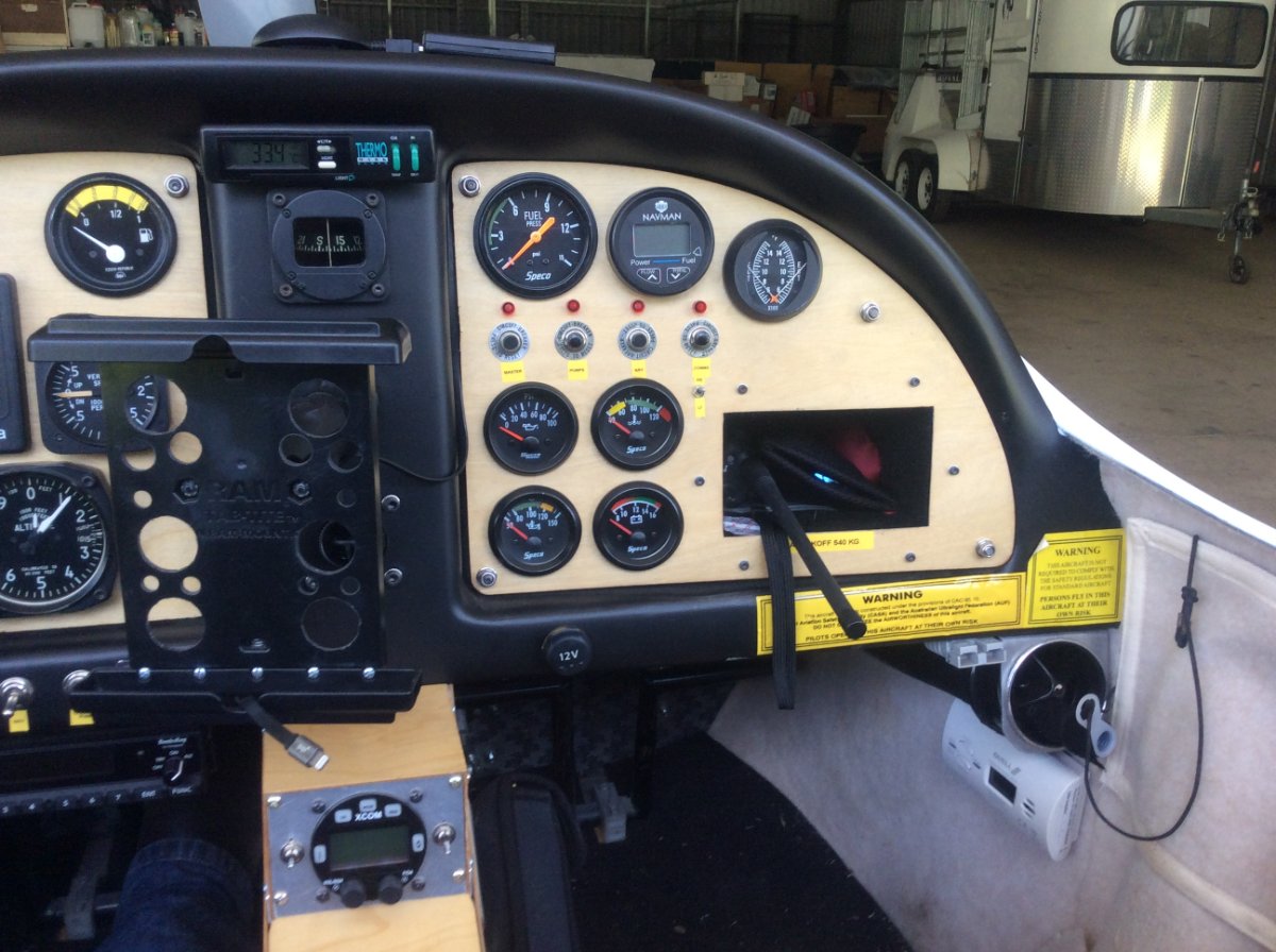

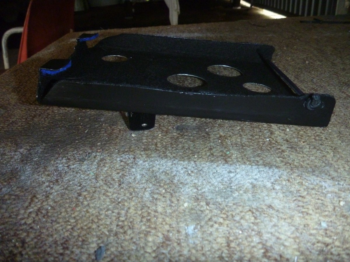

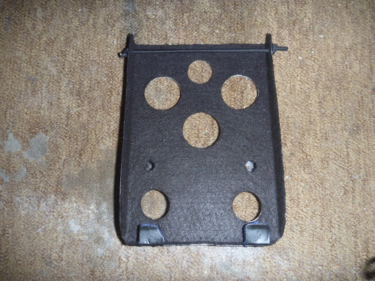

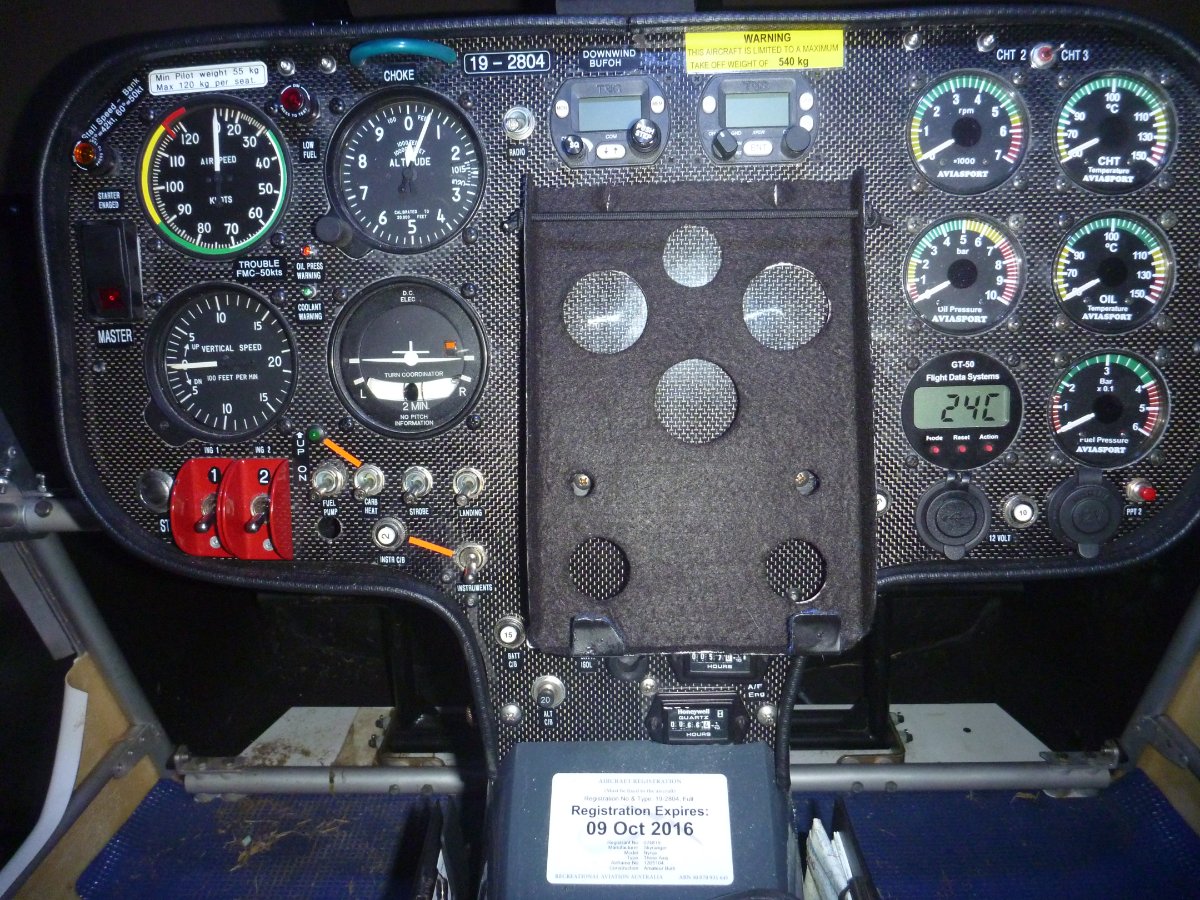

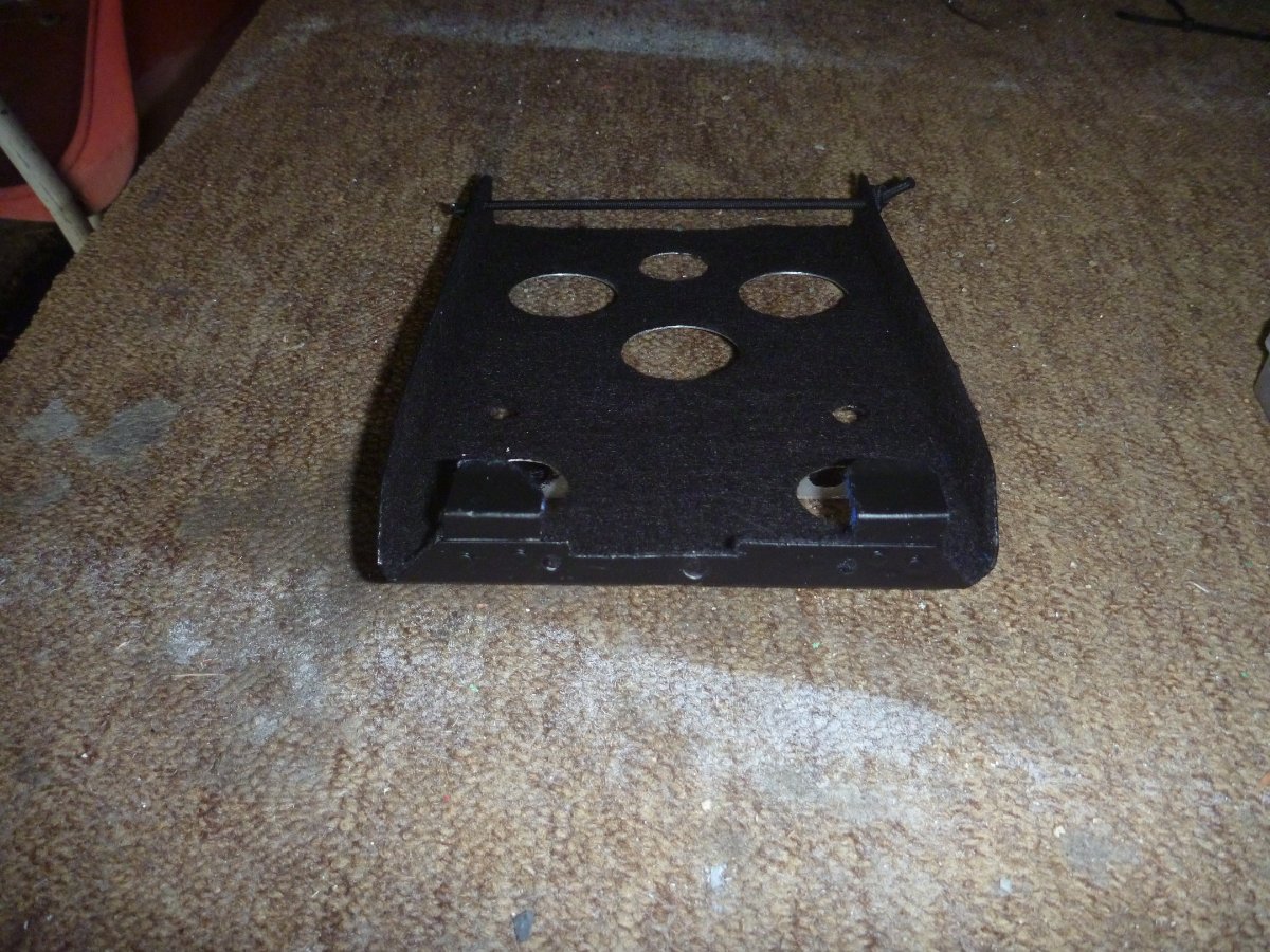

skippydiesel Posted October 3, 2021 Share Posted October 3, 2021 I have been using an iPad mini for quite a few years. Its encased in a heavy duty all weather, shock resistant, casing and mounted in a RAM. I have a dedicated in inflight semi permeant charger for it (the probable cause of the overheating). The pad has let me down twice due to overheating. Both times in winter, full sun on panned and cabin vents closed. After the first overheating event, I tried improving the iPad passive cooling by: Punching holes in the back of rubber all weather casing. Followed by using a hole saw on the RAM bracket. This was not sufficient as I had another overheating event so: I designed and installed a mini eyeball vent located behind the RAM mount and directed at the back of the iPad. Problem solved. Eye ball vent can just seen. second hole from bottom, behind RAM mount 1 Link to comment Share on other sites More sharing options...
