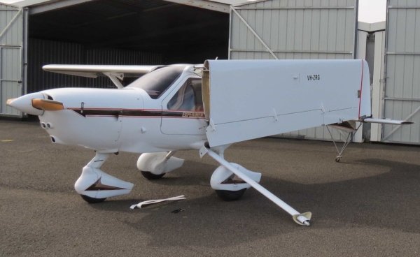

BrendAn Posted July 2, 2023 Share Posted July 2, 2023 1 Link to comment Share on other sites More sharing options...
BrendAn Posted July 2, 2023 Share Posted July 2, 2023 this is in the classifieds. didn't know it was a jab option. 1 Link to comment Share on other sites More sharing options...

old man emu Posted July 2, 2023 Author Share Posted July 2, 2023 9 hours ago, BrendAn said: this is in the classifieds. didn't know it was a jab option. That's the picture that prompted my creating this thread. I didn't want to raise the matter within the seller's thread. What also directed my line of thought was that this aircraft is VH registered, and therefore the owner must comply with the CASRs. 1 1 Link to comment Share on other sites More sharing options...
