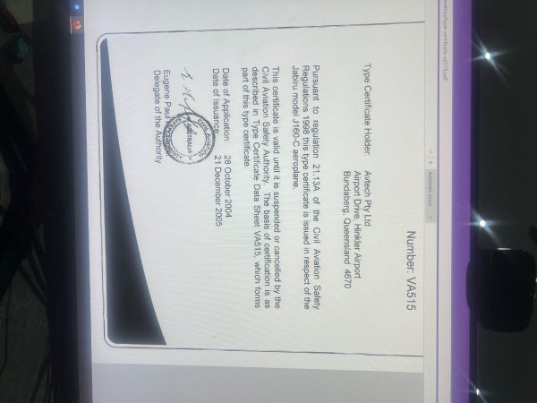

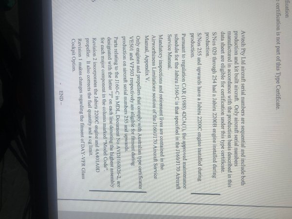

GolfWhiskeyHotel Posted October 27, 2023 Author Share Posted October 27, 2023 Thankyou for your reply. As far as I can make out it IS type certified. with a special certificate of Airworthiness. However later down the pages I see ( note 1) a paragraph (which I attach.) declares that it pertains to serial numbers 29 thru 254. Mine is number 006. Could that be a straw? Link to comment Share on other sites More sharing options...
440032 Posted October 27, 2023 Share Posted October 27, 2023 Yes - that is a Type certificate, for PRIMARY category. (aircraft of simple design intended for pleasure and personal use) Note 1 of page 5 of type cert VA515 says serial numbers (airframe serial numbers) include production and kit built. Kit built, by CASR, is not the same as amateur-built, from a kit. VA515 says: "Only aircraft serial numbers manufactured in accordance with the production basis described in this data sheet are eligible for certification under this type certificate." 006 is not listed, so I would say confidently, that type certificate has nothing to do with 006. Jabiru does have very good records - maybe you could ask them what was the certification basis of 006? I suspect that 006 was not Type Certified at all, just "type accepted" or whatever it was/is called for other factory builts under CAO 95.55. And probably that's what has lead to the MARAP process to make significant changes. That's about the end of what I can throw on the pile. 1 Link to comment Share on other sites More sharing options...
