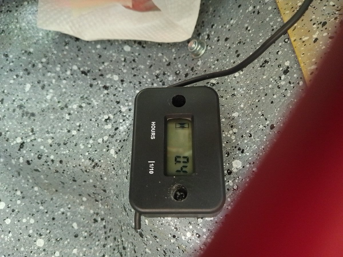

danny_galaga Posted March 4 Author Share Posted March 4 Best $7 I ever spent 😊 Link to comment Share on other sites More sharing options...
danny_galaga Posted March 4 Author Share Posted March 4 Inside the plane, on the firewall. Rotate your screen 90° anti - clockwise for correct view 🤪 Link to comment Share on other sites More sharing options...
