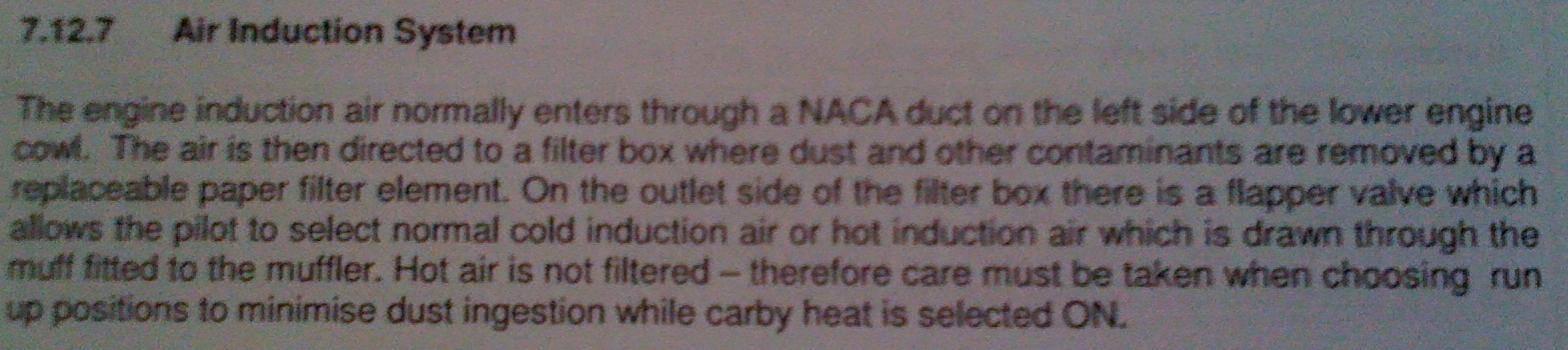

sseeker Posted February 25, 2010 Author Share Posted February 25, 2010 A quote from the J160C pilot operating handbook, "Air Induction System: The engine induction air normally enters through a NACA duct on the left side of the lower engine cowl. The air is then directed to a filter box where dust and other contaminants are removed by a replaceable paper filter element. On the outlet side of the filter box there is a flapper valve which allows the pilot to select normal cold induction air or hot induction air which is drawn through the muff fitted to the muffler. Hot air is not filtered - therefore care must be taken when choosing run up positions to minimise dust ingestion while carby heat is selected ON." I was taught the same thing at school, that carburettor heat isn't filtered so care should be taken when running the engine up. Link to comment Share on other sites More sharing options...
jetjr Posted February 25, 2010 Share Posted February 25, 2010 In Jabirus Engine induction air IS FILTERED , just the source is changed, cold comes from NACA duct, hot comes from exhaust Jabiru designed the flap valve on the INLET side of the filter box Take a look I just had a look, you are right regarding the manual but under "Carb heat" section 7.12.1 it says that both are filtered and this is the case It does say "normally" and this is the case in most other AC. Worth letting Jab know about this contradiction, unless they have changed something in the 160. They have had the same air box in all models since the very first ones I think. Link to comment Share on other sites More sharing options...
sseeker Posted February 25, 2010 Author Share Posted February 25, 2010 Sorry I'm lost are we talking about the same thing here? :hittinghead: Carburettor heat isn't filtered but the cabin heat is & also the manual says the flapper valve is on the outlet side not inlet. Really what I was trying to find out here is does the Jabiru have any other way of getting cold air from outside into the cockpit apart from opening the side vents (which are miniture on the 160 and don't cool much.) EDIT: Ok you edited your post, no worries I'll send Jab an email. Thanks for your input. Also I have the printed copy of the 160 manual and it doesn't say anything about it being filtered under 7.12.1. My manual is from 2009. Link to comment Share on other sites More sharing options...

biggles Posted February 26, 2010 Share Posted February 26, 2010 The advice from 'jetjr' and 'JabiruPhil' is quite correct . The air to the carburettor is filtered , irrespective of whether carby heat is used or not and , as stated , unlike some other a/c , this has been a feature on Jabiru's from day one . And yes , the air is heated by a simple method of heat transfer from the exhaust muffler , and the flap valve is on the inlet to air filter , which then passes through the paper filter to the engine . As regards the cabin heater , and as 'Jetjr' indicated once again , the heated air comes from a different heat exchanger which is 'grubbed' high-up on the exhaust pipe . Resembling a jam tin with both ends open , and slid onto the exhaust pipe , with two openings - one for the cold air inlet , connected by hose ( scat-hose ) to an opening at the front of the lower cowl , and the other opening , connected by another hose to the on/off flap . This flap is designed to be either open or shut , although this could be defeated and air drawn from inside the engine compartment , near the firewall . Even with correct operation ie. fully pulled out , it appears possible that some minor leakage of hot air from within the engine compartment may occur due to . When open , ie. the 'Cabin Ht' knob pulled out , it is designed to allow ambient air to enter through the opening in the front of the lower cowl , pass over the exhaust pipe picking up temperature , and entering the cabin through the firewall . If the hoses are damaged , the flap is not fully open ( an 'over-centre' spring arrangement ), or the engine to have a small exhaust leak , which is not all that uncommon , it is possible for carbon monoxide gas to enter the cabin without the occupants knowing , and they will soon be off to sleep . For this reason it is good airmanship at all times , and particularly when using the cabin heater , to closely observe the CO monitor , located well within view of the pilot of course , and note any colour change , and if so , shut the heater off immediately , fully open the vents to purge the cabin air , and have the fault investigated ASAP . Of course you will have checked the 'use-by' date on the CO monitor, and you will know that it current , and therefore indicating correctly ! . I believe that it is important to always have the fresh air vents open a little , even though it may be cold outside . If the air flow through the side vents seems inadequate , check to make sure that the extraction is adequate and is not impeded . Even with 100 knots of positive pressure at the fresh air vents , there needs to be a negative pressure at the outlet to promote a flow , and most of the extraction seems to be achieved via a torturous path out through the ventral fin . I think the later A/c have a vent , similar to the side inlet vents , located beneath the A/c . On a broader note , the systems on a Jabiru , and many other A/c for that matter , are simple , and it is good airmanship to be familiar with all aspects of their operation . One day it may save your bacon !! . Have a talk to your L2 and get him/her to explain the systems , or alternatively contact many of the knowledgeable Jabiru owner/builders , who will be only to happy to help . PM me if you need . Bob Link to comment Share on other sites More sharing options...
sseeker Posted February 26, 2010 Author Share Posted February 26, 2010 Hi Biggles thanks for the explanation. The reason I was arguing the point is because I'm going off what my manual says (which it appears to be wrong in this case). I'll attach an image of my manual. I think the best thing in this case (as you suggested) would be to have a word with our L2 on how our Jab works. Link to comment Share on other sites More sharing options...
biggles Posted February 26, 2010 Share Posted February 26, 2010 SSeeker , The POH , of course ,should be correct but I remember mine referring to " adjustable seats " in the J160 . Of course no J160's had adjustable seats to my knowledge . It appears that the POH takes gets forgotten at the time for more important things but in the end these things sort themselves out . Link to comment Share on other sites More sharing options...
sseeker Posted February 26, 2010 Author Share Posted February 26, 2010 A copy of my manual (latest manual) can be found at: http://jabiru.net.au/Manuals/Pilot%20Operating%20Handbooks/J160-C_Section0-9_Rev3.pdf I'll speak with our CFI and L2 and if the manual turns out to be wrong I'll send Jabiru an email, it's just most aircraft don't have filtered carby heat and that's what the manual reflects that's why it's confusing me. Link to comment Share on other sites More sharing options...
