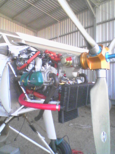

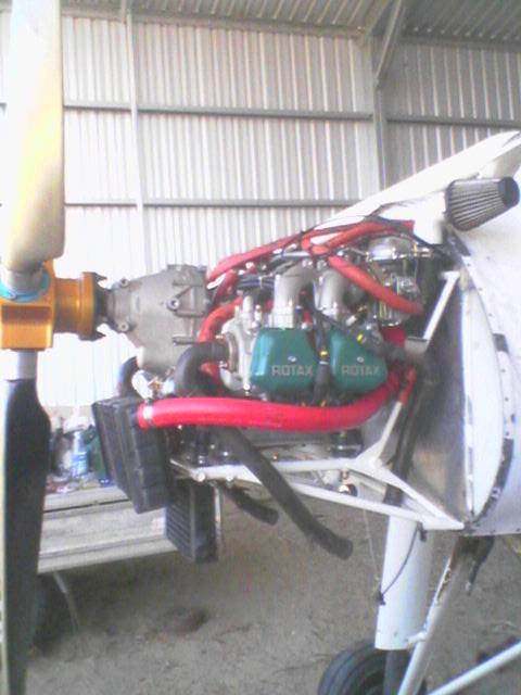

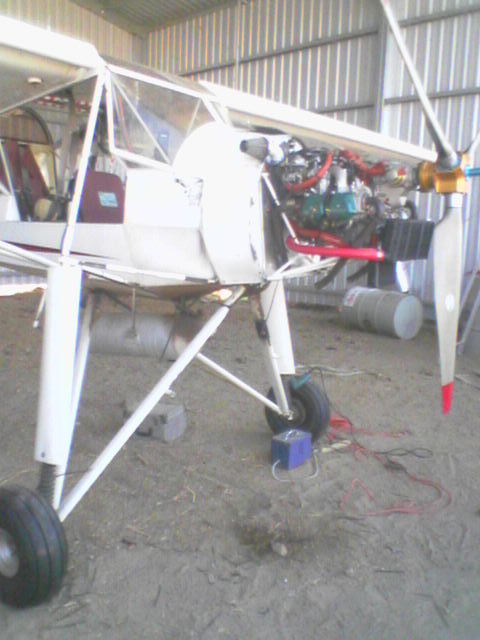

I've fitted this type of prop
correct name is "idrovario" by alisport(italian); possible in 2 blades high speed or 3; 4 blades.
some remarks; if used with rotax only with 912uls 3; who has hollow shaft and gearbox adapted to mount a CSU, we've choosen for the jihostroj.
Works very good on our aircraft.
Take of short, good climbing caracteristics approx 1100ft/m at 450kg and reasonnable cruise speed (127kts).
