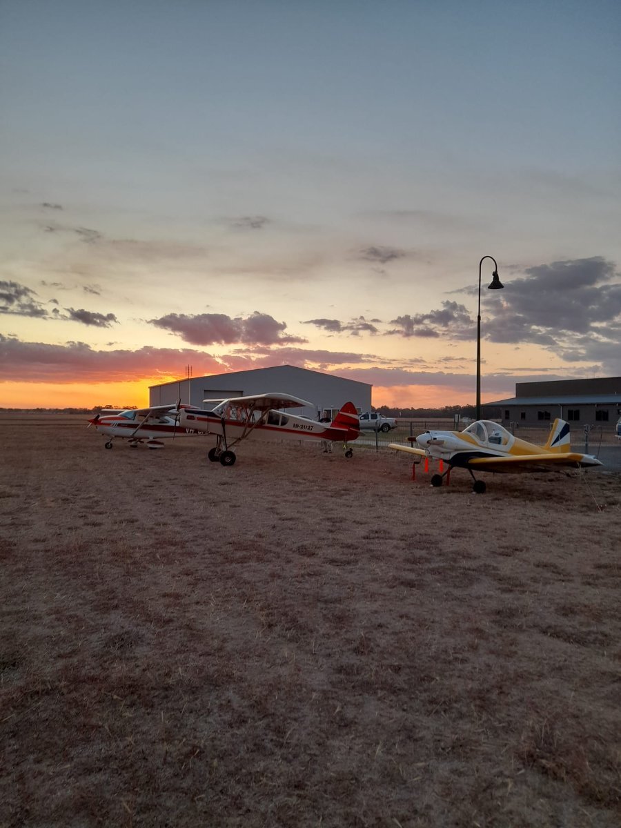

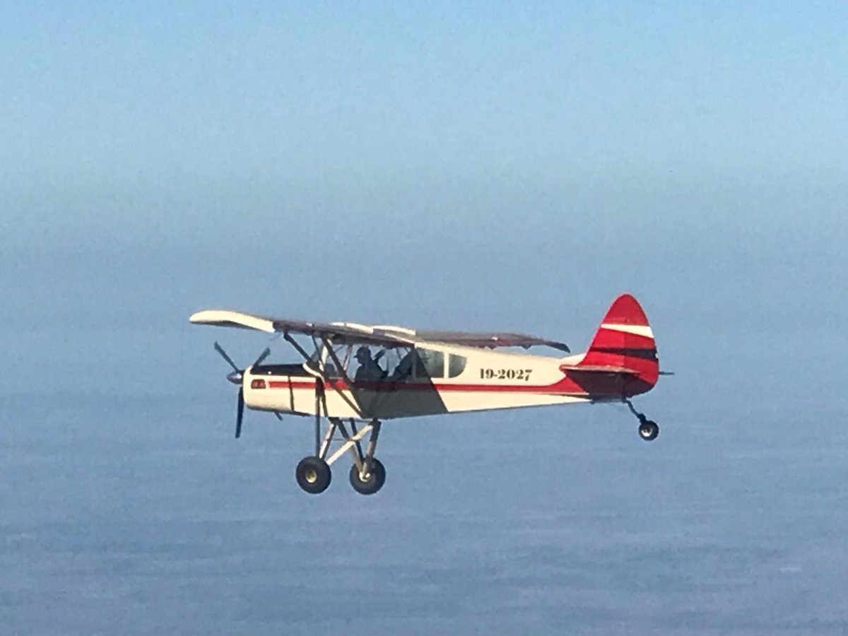

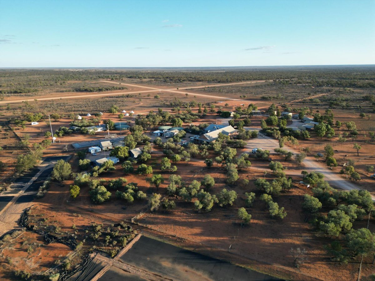

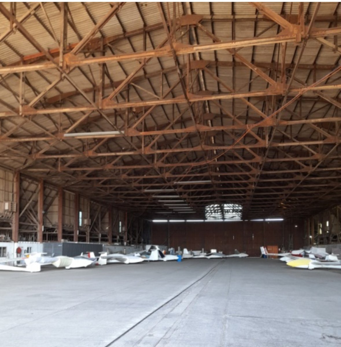

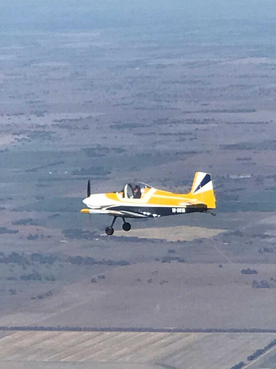

  2. I was one of six Bathurst Soaring Club members in four aircraft (C182, Maule M4, Hornet Cub & Corby Starlet), who enjoyed an 808nm five day trip around NSW (& briefly VIC) last week. Day 1 Bathurst – Temora (fuel, brunch). Temora – Hay (fuel). Hay – Mungo Lodge Day 2 Guided tour around the (dry) lake & its World Heritage features. Day 3 Mungo Lodge – Swan Hill (fuel, lunch) Visited the Catalina Museum, Lake Boga. Day 4 Swan Hill – Tocumwal (fuel, lunch) Visited the Aviation Museum & the Gliding Club hangar (one of the original, huge WW2 hangars, which accommodated B24 Liberators) Swan Hill – Temora (fuel) Day 5 Temora – Bathurst. Cancelled planned visit to the Temora Museum, due encroaching weather at Bathurst. All together a most enjoyable trip. Both aviation Museums are well worth the visit and comprehensively detail the importance of these aerodromes / lake during WW2.
