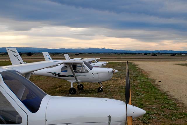

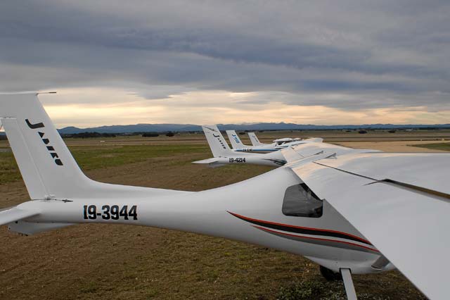

PICS FROM WEST SALE Pictures attached were taken a week ago when we had an impromptu flyin to my hangar at West Sale in Victoria. All the Jabiru's in the pics are based at Latrobe Valley Vic. Cheers Daryl
