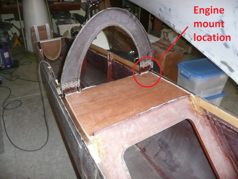

Hi Marty, The fine details of each system are still to be determined but the general arrangements have been finalised. Engine mounts: There will be three hard-points on the fuselage to which the engine mount will attach. There will be a hard-point attached to each fuselage side longeron where the fuselage bulkhead, longeron and rear shelf meet. There will also be a hard-point attached to the bottom fuselage keel/longerons, making overall a triangulated set of hard-points. A chromolly tube "V" frame will be attached to these hard-points with rubber isolators being used. The top end of these tubes will exit the fuselage sidewall and stop flush with the fuselage side. The engine itself will be mounted on another tube (which will be the pylon) using a cradle to hold the engine, and that pylon will simply be slotted into the fuselage mounted V frame tubes and secured with bolts. This arrangement will facilitate easy removal of the entire engine pylon. The pylon tube will receive a streamlined fairing and fuel/electrical lines will run inside the pylon and its fairing. Fuel system: There will be 3 fuel tanks in the aircraft: the main fuselage tank which is incorporated into the centre structural keel; the wing leading edge tank; and a small approx. 1 gallon header tank which will be mounted on the rear shelf (as shown in the photo above). The wing tank feeds by gravity into the main tank and fuel is pumped from the main tank to the header tank using an electric transfer pump. There is a second transfer pump fitted for redundancy. The transfer pump will run continuously, ensuring that the header tank remains full at all times. There is a return line from the header tank to the main tank for the overflow. The header tank will be fitted with two flop tubes that will feed each individual engine. Refuelling will be into the centre tank which will fill the wings through gravity flow. There is a simple breather system from the wings that allows air to vent into and out of the wing tank but prevents fuel from overflowing when the tanks are full. -

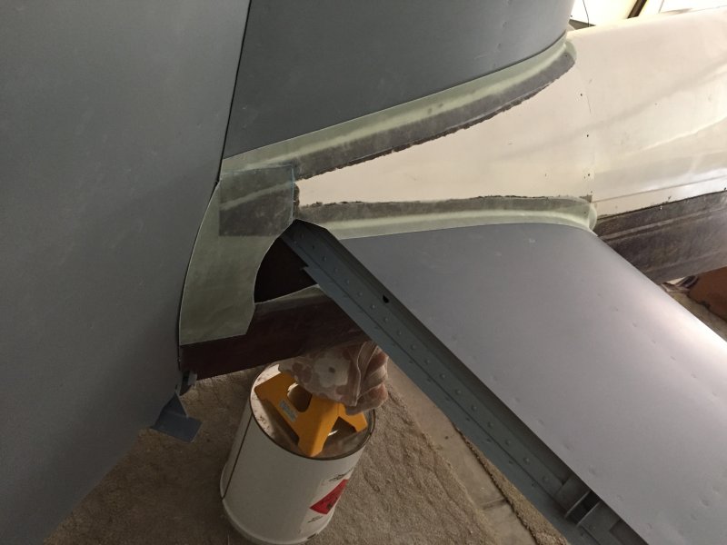

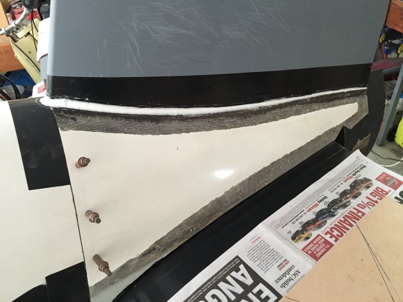

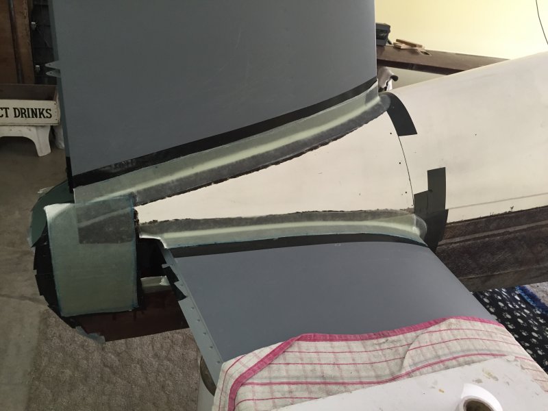

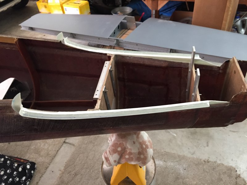

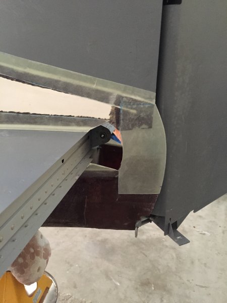

With the tailplane all taped up to facilitate layups of BID against it to form the intersection between the turtledeck/fuselage and the tailplane surfaces, micro was put into the intersections to allow a radius to be formed. The micro was then radiused and BIDs were applied to form the skin. Some work was required to tidy up the rear fuselage to blend the rear fuselage shape into the rudder. To do this, a mold was formed out of cardboard and BIDs were laid up over the mold to form the rear fuselage shape. Once all the BIDs were cured, the new rear fuselage shape was trimmed to match the deflected rudder and the fairings were all trimmed to correct size. Fasteners will now be installed on the new fairings and they will be done. The tailplane will now have very neat intersections between all surfaces. Next, we are on to the canopy hinges and latching mechanisms. I am very pleased with the progress on the aircraft. It is really taking shape now and progress is tangible after every build session. -

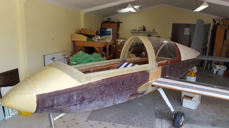

It certainly is! Sometimes, I find I stop work on it and just drool over its looks for a few minutes. The photos don't really do its looks justice. In the flesh, it is long and slim and it just looks fast. The canopies will be done soon and once the front one is on as well, the looks will be significantly enhanced. I've got my paint scheme already planned. I'm sure people will be impressed when they see it and I think it will help give the impression of speed. For that matter, with a projected top speed of over 200 knots, it will be fast (for the whole 20 minutes that I can fly it with a passenger, or 75 minutes with the ferry tank in place of the passenger...). Bex, I'm sorry I didn't get the chance to show it to you when we met up but I enjoyed our morning tea! -
