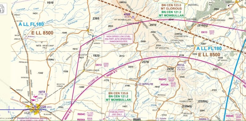

I managed to crop the screenshot of the Mt. Mowbullan area as shown above. The Oakey restricted areas appear to be about 8nm to the south of Mt. Mowbullan itself but there is a danger area in the immediate vicinity. However, there are no flight restrictions in a danger area.

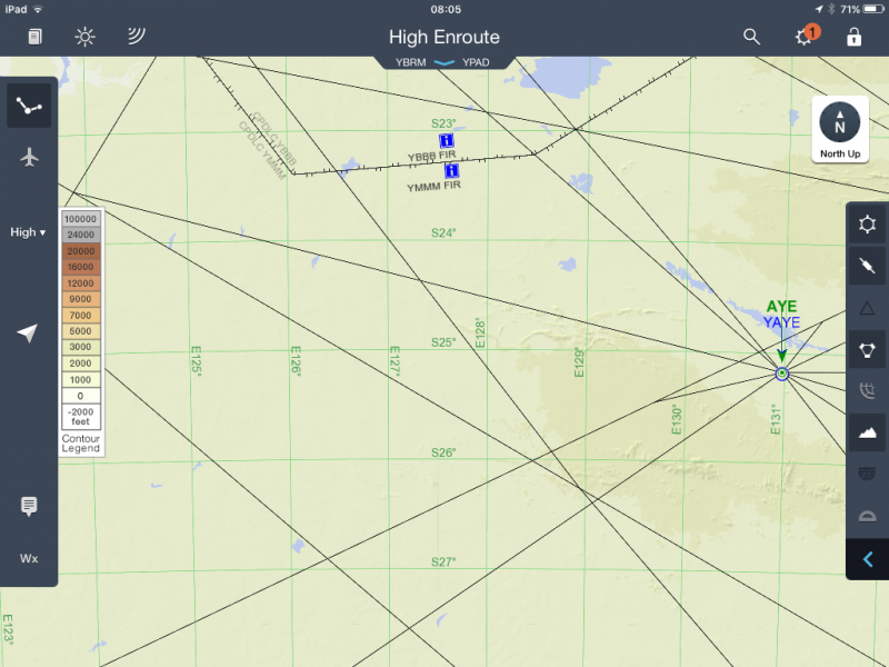

Here is a screenshot of the upper air routes in the region of the WA/SA/NT border. From it, you will be able to determine if there are any near your point of interest. Check my post below for a screenshot of the Mt Mowbullan area.
