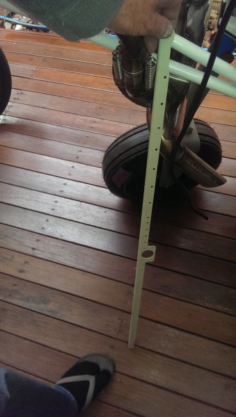

  1. The end has been welded on incorrectly from what I can see. As the elevator arm lines up perfect with the front part.
  2. My torque tube is binding and has a woof in it. Now I have to straighten it ??? Lyndon

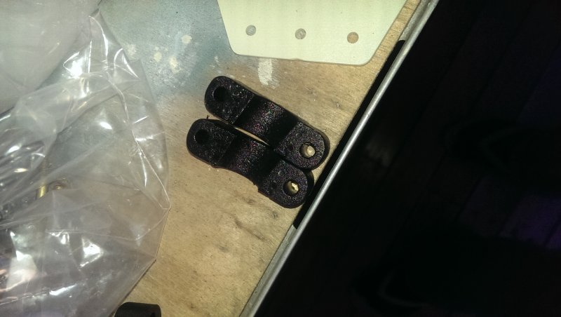

  13. Fuel Lines and tap question. The fuel line under the fuselage shows three clamps which I dont have in my kit. I only the single hole type with the rubber insert which is for for my engine I think. also the fuel tap has a bracket SE 009-15 that I also dont have. A pic of this bracket if any one has it please so I can make one. Thanks Lyndon

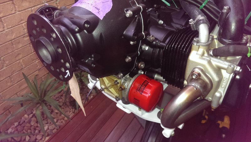

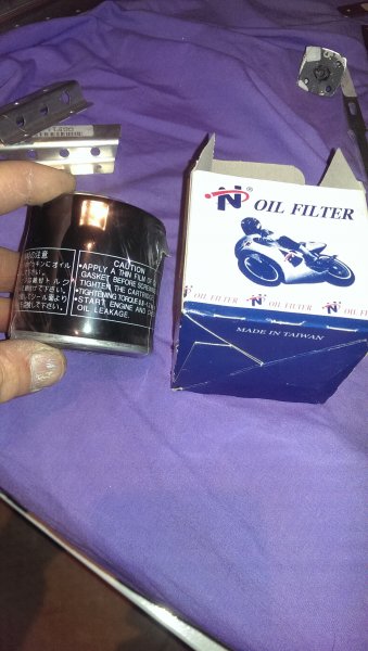

  19. Its a perfectly good oil filter. It's USA made. Meets all the requirements for filtration and oil flow. Look at it the other way. A Rotax oil filter is just a Briggs and Stratton filter. I use a Taiwan made filter for my race bike. It cost under 2 dollars US. It has well over 200 hp. Revs to 15000 rpm. Not only I but just about everyone I know uses them. There has never been an issue. Baldwin make good filters and I'm sure it will be fine. You can see how small the filters are on current 1000 cc super bikes. Lyndon
  20. Filter issues. Bugger me my cheap filter was to long for fitting the exhaust. So I found a Short one off a Briggs and Stratton engine.
