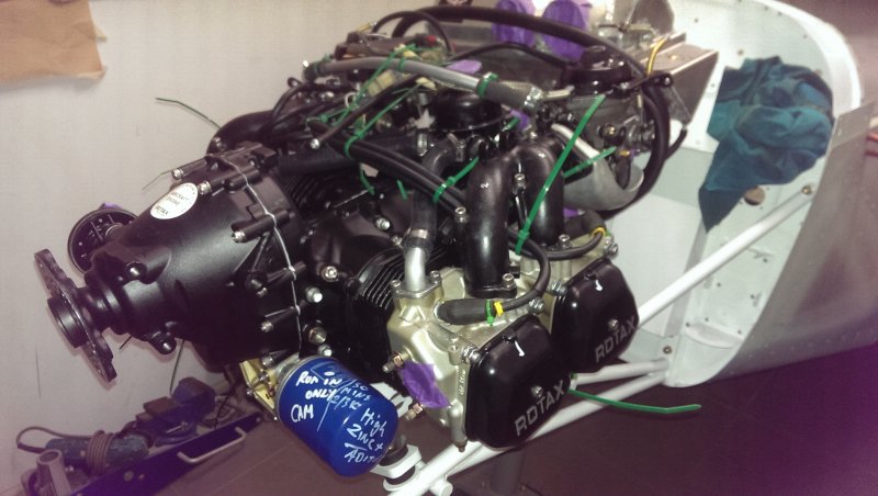

  4. Engine mount questions. I bought this Engine used and it came with a bracket mounted to the engine and then that screwed to the box. Eg they just put my used engine in the box the replacement engine came in. I have no info 're torque values or what bolts to use or washers or loctite etc. It came with four black set screws that look like what is used from pics I see in my manual. Any info would be great. Thanks Lyndon
  5. Yes I do. Makes sense. Engine is in. Feel like I'm making progress

  13. Engine mount. I'm about to fit it. Any tips on this. It's all a bit flexible as is the cabin frame that it mates to on the top. The manual says nothing about location in any detail ???. So is just a matter of fitting where it seems nice or is there a specific point where it needs to go. On the top of my fire wall I two little holes that seem to do nothing in the center ?? From what I can see these have nothing to with it or am wrong. Any guidance would be great. Thanks Lyndon

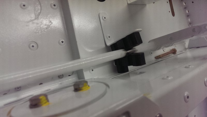

  20. Holes in the wrong spot ???. Any suggestions rather than just redrill and has anyone had the same ??. As you can see the front leg is of set to the front. But have a row in the rear on the plastic Bush and the long angular but the plate that goes under the plastic Bush has these holes in the front ??? Thoughts ?? Thanks Lyndon

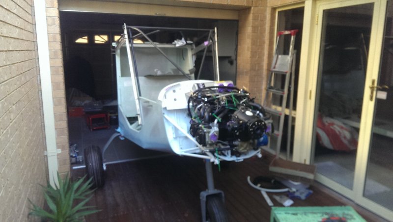

  23. The manual shows fitting the cage. Then I find it hard to squeeze the top cabin skin in past the cage with out damage ???. Does anyone do it the other way around ???. Secondly. My plane will be stored for a time before going to an airfield for the wings to be attached. I would like to do as much as I can in my workshop before this. I see the manual shows some parts that can't be fitted before the wings. In reality what is the minimum I have to leave off to fit the wings. I do propose to pre paint all parts ?? Thanks Lyndon
