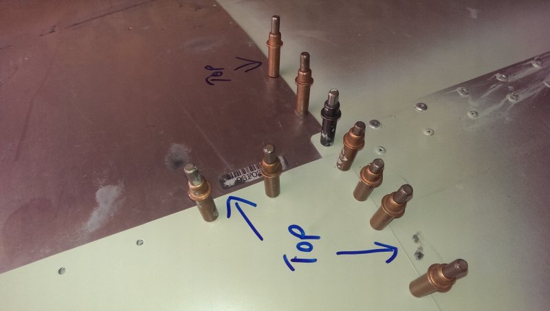

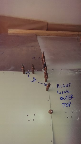

  23. Thanks for pics. Looks very nice. Opinions on matting for the tanks. Book recommended top and bottom. I have got some rubber. I guess enough just to stop rubbing. When I washed the tanks out I just could not believe how heavy two tanks in each wing will be. Thanks Lyndon
  24. Breathers of the four tanks. Manual says I holes top and bottom skins. I can see the top but the bottom hole is a drain ??? Inner rear location. Correct. So the existing hole in the top is redundant with the auxiliary tanks. Any tips ??? Or just drill a hole in the top and bottom to suit. Any pics would great. Lyndon
