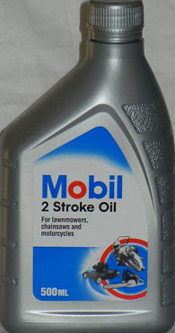

bexrbetter Posted August 3, 2014 Share Posted August 3, 2014 My 15 year old book indicates Castrol tts. My Mates and I raced vintage motocross for over 10 years, mostly 1970's MX bikes, important to you all were air cooled high performance 2 strokes and most of us over time tried all the various offerings and amongst us (talking a couple of hundred people here) Castrol TTS is one of the least liked of them all although some do like it in water cooled bikes. Many of us considered that one of the cheapest, plainest 2 stroke oil out there was the best for our air cooled engines and that was "Mobil 2 Stroke Oil", not Mobil 1 2 stroke, not Mobil Racing 2T and not Mobil Outboard Plus (it can get confusing), just the bottom of the barrel plain stuff for chainsaws, lawnmowers and motorcycles, i.e specific to air cooled 2 strokes (blue in colour). It's smokeless, doesn't foul plugs and terrific anti-scuffing. Strip them down for their annual checks and can tell you low carbon deposits on piston and exhaust, those who used it were very happy with it. It's not synthetic and depending on engine size you run between 20:1 to 30:1, for yours i would think 25:1 would be appropriate. Link to comment Share on other sites More sharing options...
