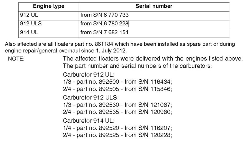

rankamateur Posted October 8, 2014 Share Posted October 8, 2014 All affected motors have serial 4 XXX XXX, must all be certified, my 912ULS is serial 6 781 3XX, so might not be a problem to many of us. Link to comment Share on other sites More sharing options...
Mc Guyver Posted October 8, 2014 Share Posted October 8, 2014 All affected motors have serial 4 XXX XXX, must all be certified, my 912ULS is serial 6 781 3XX, so might not be a problem to many of us. I know of it happening to a 914 fitted to a Gyro so seems to be a problem on all series! Link to comment Share on other sites More sharing options...
aro Posted October 8, 2014 Share Posted October 8, 2014 All affected motors have serial 4 XXX XXX, must all be certified, my 912ULS is serial 6 781 3XX, so might not be a problem to many of us. See: http://legacy.rotaxowner.com/si_tb_info/serviceb/sb-912-065ul.pdf Rotax seem to issue the service bulletin in a separate document for the UL engines. Link to comment Share on other sites More sharing options...
Downunder Posted October 8, 2014 Share Posted October 8, 2014 From ULS 6 780 228 onwards. Just missed out with my 6 779 XXX thankfully, but got caught up in the "suspect" crank debacle......... Rotax seem to be having ongoing quality control problems. Sounds like bean counters chasing the cheapest bidder/supplier....... Link to comment Share on other sites More sharing options...
rankamateur Posted October 8, 2014 Share Posted October 8, 2014 See:http://legacy.rotaxowner.com/si_tb_info/serviceb/sb-912-065ul.pdf Rotax seem to issue the service bulletin in a separate document for the UL engines. Thanks Aro, that is the one I needed, wouldn't have wanted to start my new motor without complying with the mandatory SB. I wonder how many hours I could have flown it no condition? Link to comment Share on other sites More sharing options...
facthunter Posted October 8, 2014 Share Posted October 8, 2014 Float carbs are a risk anyhow, but with suspect floats, it goes to a new level. If there is a guaranteed part available I would fit it if there is any doubt whatever. Nev Link to comment Share on other sites More sharing options...
Old Koreelah Posted October 9, 2014 Share Posted October 9, 2014 Surely the carbs are delivered by Bing complete with floats? If that's the case, other users- like Jabiru- are also affected. 2 Link to comment Share on other sites More sharing options...
