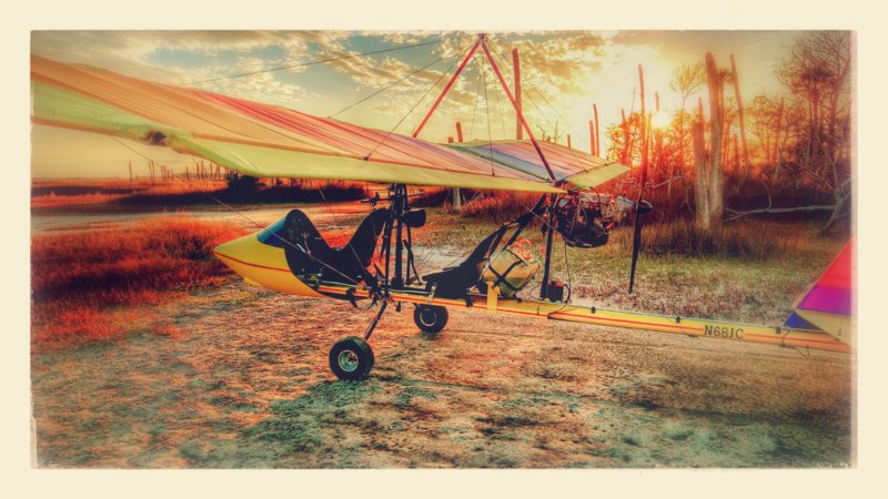

Hey, that looks like what was a Mustang over here in France. Not sure if it had wires or not though.

Callahan's pic reinforces my views on CoG. Just a straight replacement of the 503 with a 582 would move it back quite a lot I'd say and depending on the elevator authority could lead to a potentially dangerous situation. Be interesting to hear from someone flying a 582 Drifter about whether that's so or if a nose weight had to be added to keep the CoG within limits. If so, that would also tend to negate the 582s advantages over a lowly little 503.
BTW I found a pic of the French Mustang that I mentioned that's a bit too big to post here. It didn't have wires - it had lightweight round struts plus a nose wheel and the main gear a little bit further back. Otherwise looked almost idetical to the Drifter.
