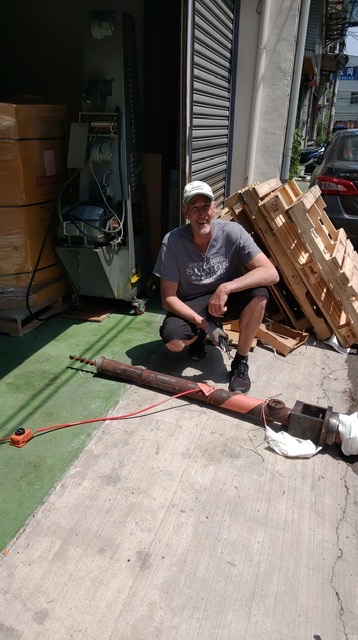

Mike Gearon Posted April 15, 2020 Share Posted April 15, 2020 Today. I’ll forget motors and stick with trying to extract the PVC stuck screw from an extruder barrel with a Ukulele heater pad. Not going any better and it’s 1950’s tech with no help from YouTube. Gas torch tomorrow. Link to comment Share on other sites More sharing options...
