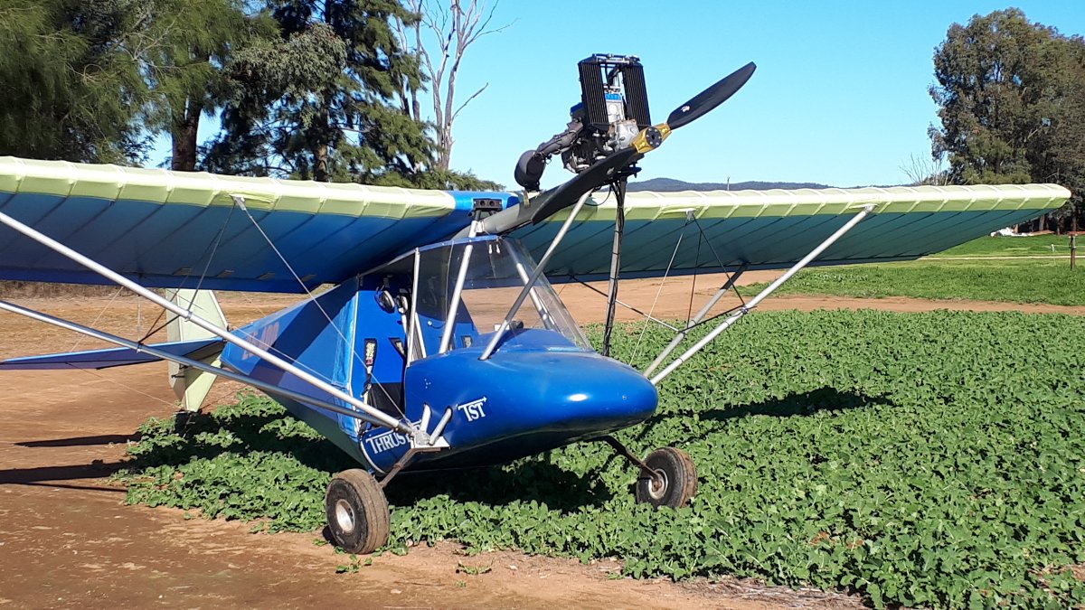

Thruster88 Posted May 29, 2021 Share Posted May 29, 2021 2 hours ago, Tyro Driver said: What is the tst version and could a 582 fit on all the models? What cruise speed do you normally work on ? Cheers Alex My 1988 thruster says tst on the pod they changed the names in 1988 to t300 open and t500 enclosed fuselage. Tst two seat trainer. 2 hours ago, kasper said: The 503 and 582 engine mounts are different - you may find it difficult to find a second hand 582 mount to change a 503 mount out for. First step in Australia given the end of the thruster factory is to talk to raaus tech because you will need to use MARAP to change a 503 to a 582 ... I did not have to change the engine mount when I switched to the 582. 1 Link to comment Share on other sites More sharing options...
Tyro Driver Posted May 29, 2021 Author Share Posted May 29, 2021 That’s a neat looking machine!! The enclosed tail an option on all tst aircraft? Or can you retro fit it? Link to comment Share on other sites More sharing options...
Thruster88 Posted May 29, 2021 Share Posted May 29, 2021 10 hours ago, Tyro Driver said: That’s a neat looking machine!! The enclosed tail an option on all tst aircraft? Or can you retro fit it? They came from the factory in enclosed (t500) or open (t300). I have flown both types and think the t300 is a better machine all round. Light simple and extra visibility. Link to comment Share on other sites More sharing options...
