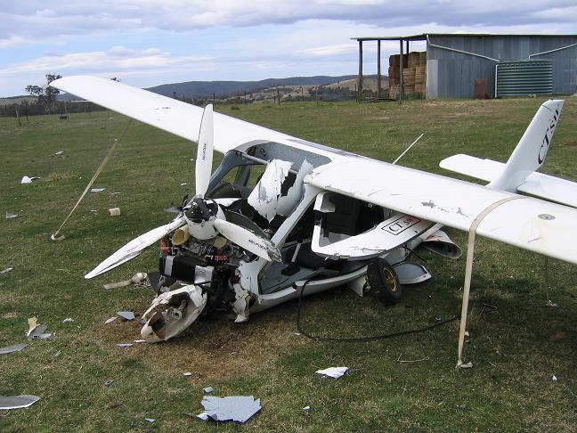

Admin Posted October 6, 2008 Share Posted October 6, 2008 This is the result of a CT hitting a power line - the accident was reported in the news forum here a few weeks back. Link to comment Share on other sites More sharing options...

slartibartfast Posted October 6, 2008 Share Posted October 6, 2008 I spoke to the pilot yesterday. The engine ended up in the (thankfully empty) pax seat, and the plane "landed" tail first. He is one lucky PaulN took him up in his CT to get him back in the saddle. Link to comment Share on other sites More sharing options...
Guest pelorus32 Posted October 6, 2008 Share Posted October 6, 2008 What were the circumstances of the accident? Regards Mike Link to comment Share on other sites More sharing options...
slartibartfast Posted October 6, 2008 Share Posted October 6, 2008 He is not keen to share in public (has been refusing interviews) and is not a member of this forum (to my knowledge). He did say it was OK to discuss where others can learn from it, so hope this is OK. Broadly speaking, practising landing at a friends property - knew about powerlines at one end, but not the other. On a go around, found the unknown lines right in front, tried to go under, didn't make it. Link to comment Share on other sites More sharing options...

Guest Bendorn Posted October 17, 2008 Share Posted October 17, 2008 This is the result of a CT hitting a power line - the accident was reported in the news forum here a few weeks back. Looking at the picture... It appears the tie downs didn't help as he still managed to hit the powerline...... Link to comment Share on other sites More sharing options...
