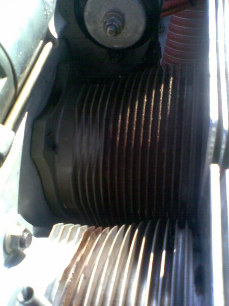

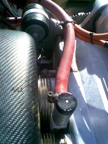

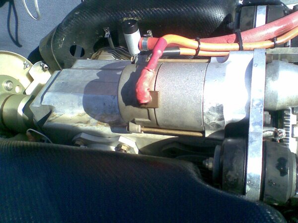

JayKay Posted July 5, 2010 Share Posted July 5, 2010 The registration of the aircraft is 24-4587 Some pics of the motor after the event ... Note the two missing bolt heads on the cylinder head and the through-bolt is just loose (with no head) Link to comment Share on other sites More sharing options...
